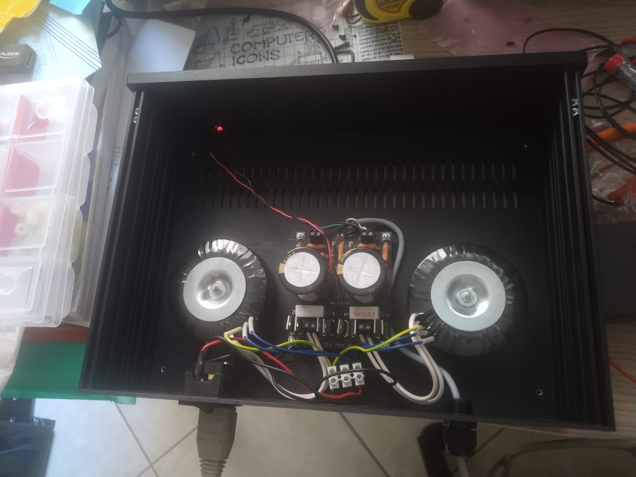

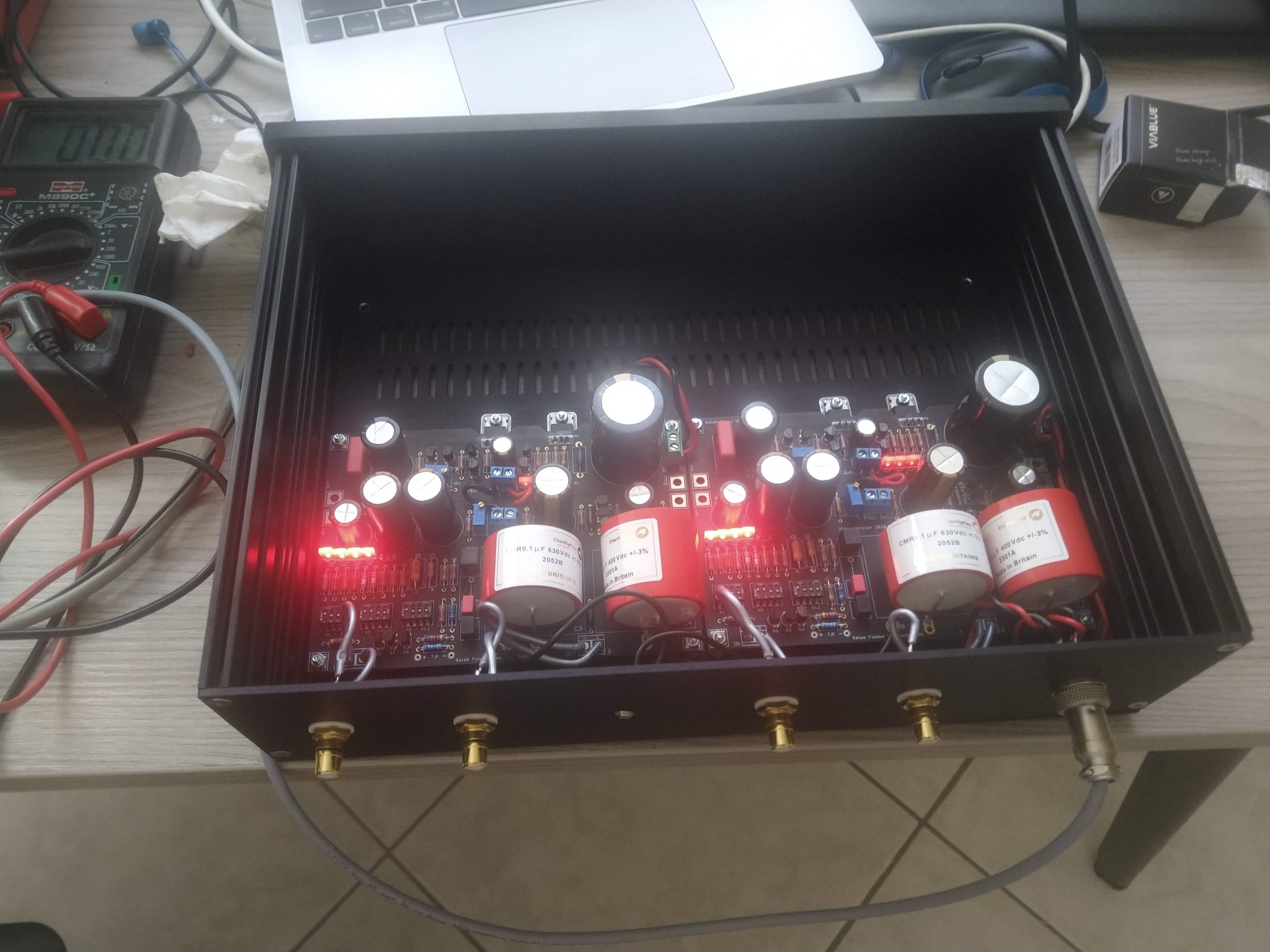

And some photos of the almost final build:

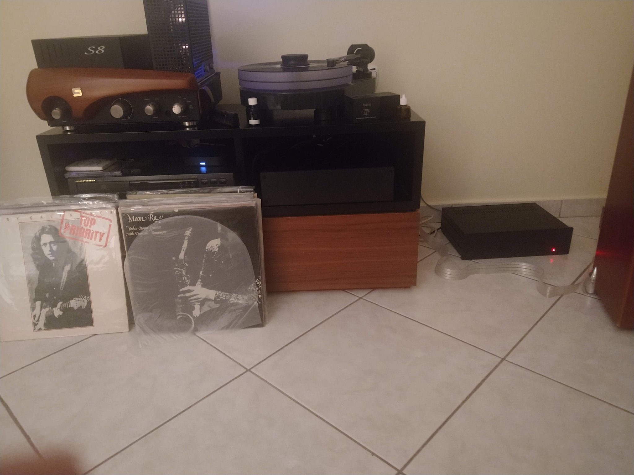

After a very very, VERY long journey in turntable-prep, I finally dusted off all my courage and plugged everything in for a first little listen.
It is working.
Journey isn't finished yet, as unfortunately I only have one channel.
I suspect the cartridge to be faulty, as I've swapped input channels of UFSP, output channels of UFSP, Cables, and Input channel of DCG3, and controlled continuity of the tonearm-wire (from an empty headshell to the RCAs) as well as the single headshell-wires from cartridge to headshell-connector, all is good. Last possible suspect seems to be the cartridge. argh.
BUT: UFSP is good. Just had a 5 minutes listen, I already really like what I heard!
