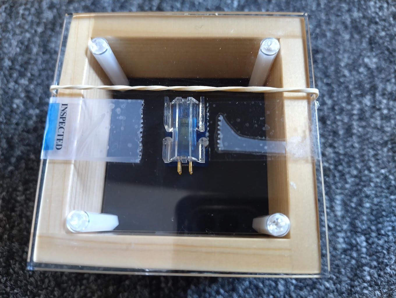

Today I got the opportunity to test the ZYX R50 cart in my own system. Will be fun to see if it will do any good. Any thoughts about it? And I will (of cource)come back with some listening impressions when it arrives in a couple of days..

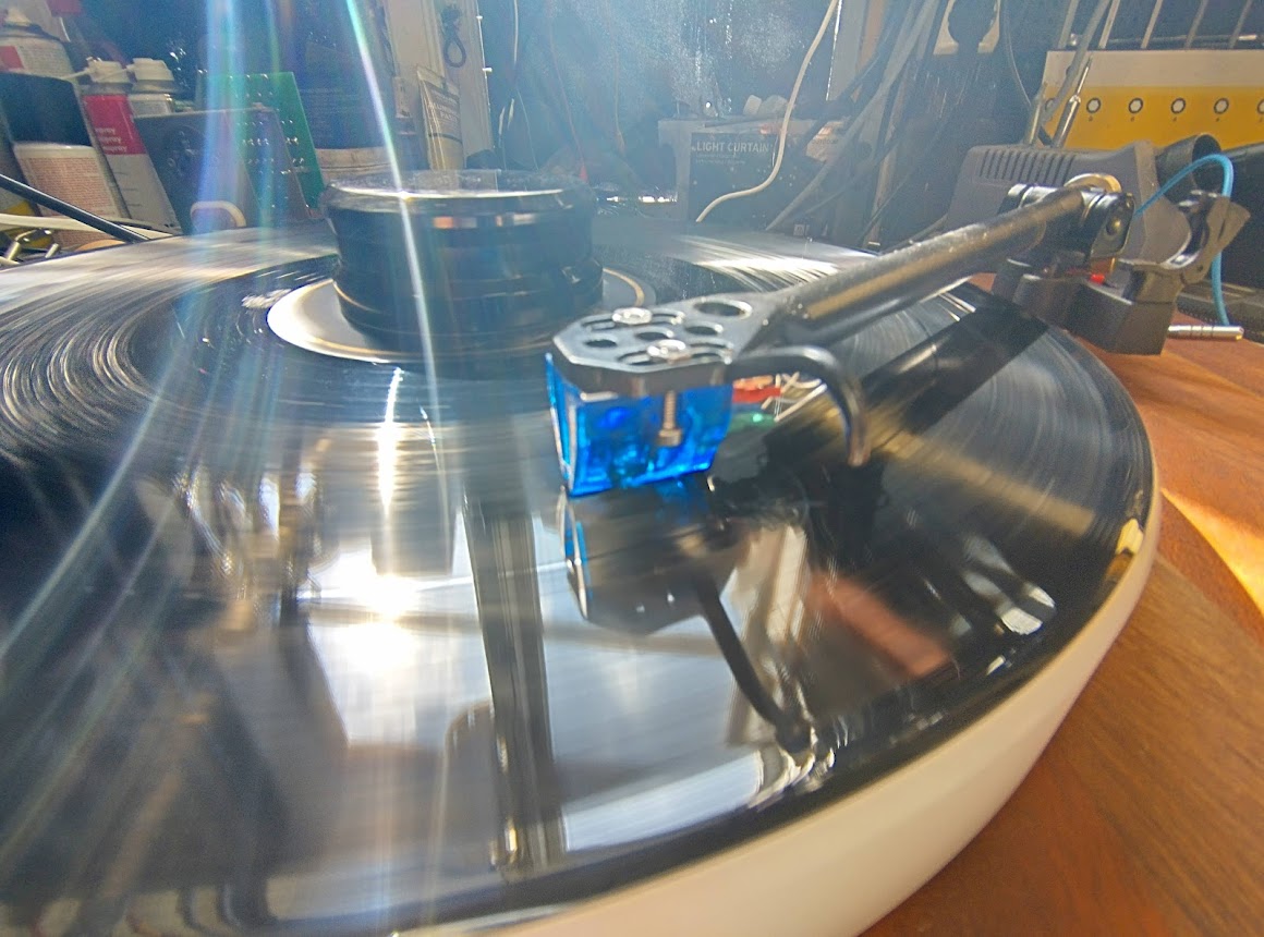

Now we´re talking! This is what im looking for. More details, dynamics and what I would say is a hi fidelity cart. The ZYX R50 set up with 100ohms load, 2g tracking force and aligned with mirror working in the 62dB range. This stylus is old but not as old as the Ortofon MC20 but performs better in my system. For not to mention the Hana EL. Absolutly silent and I had problems betting rid of hum with the MC20. Playing Yazz at the Pawnshop with Arne Domnerus. I can reckomend this reckording. It is really good. And apologies for the messy workshop area 🙂 What can I say im happy with this and will do some more tweeks to get it as good as I can.

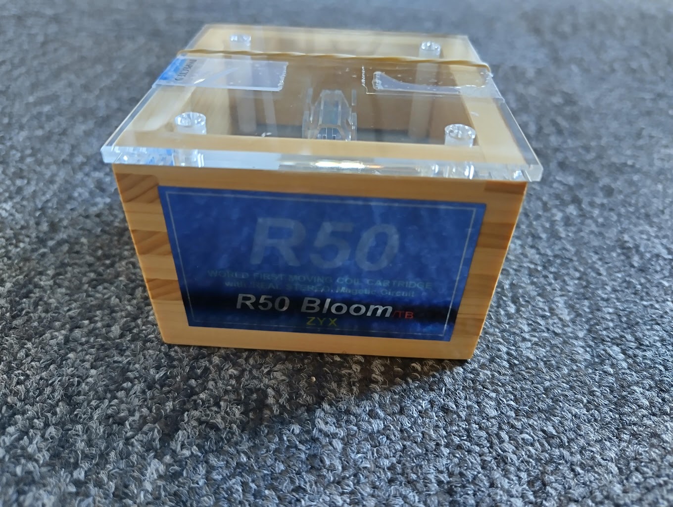

Nice to know that you found a good solution that you like right from the start. Its the tin base 7.7g mass assembly I believe because it has TB in red on the box. What R50 edition is it? With the black aluminium as in the above specs or the later duraluminium cantilever?
Salas you are right about the tin base . And I belive it is one of the first editions without numbers.

Don't forget while tweaking to also try >100Ω load settings. Not intuitive for an 8Ω engine cart like this one but in enough systems 200Ω - 300Ω tend to prove interesting for various MC cartridges.What can I say im happy with this and will do some more tweeks to get it as good as I can.

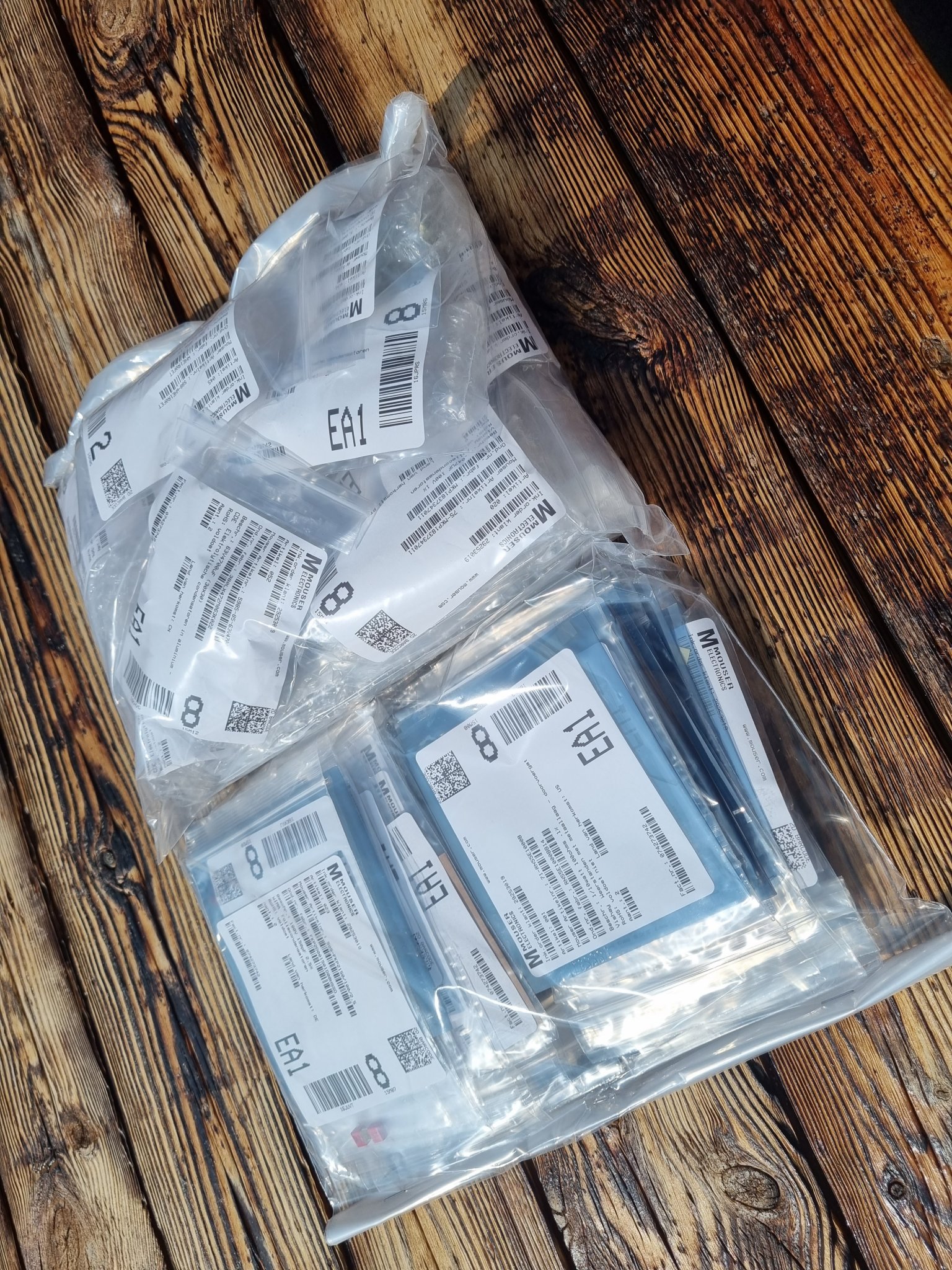

Parts are in, now the only thing i need is time...
