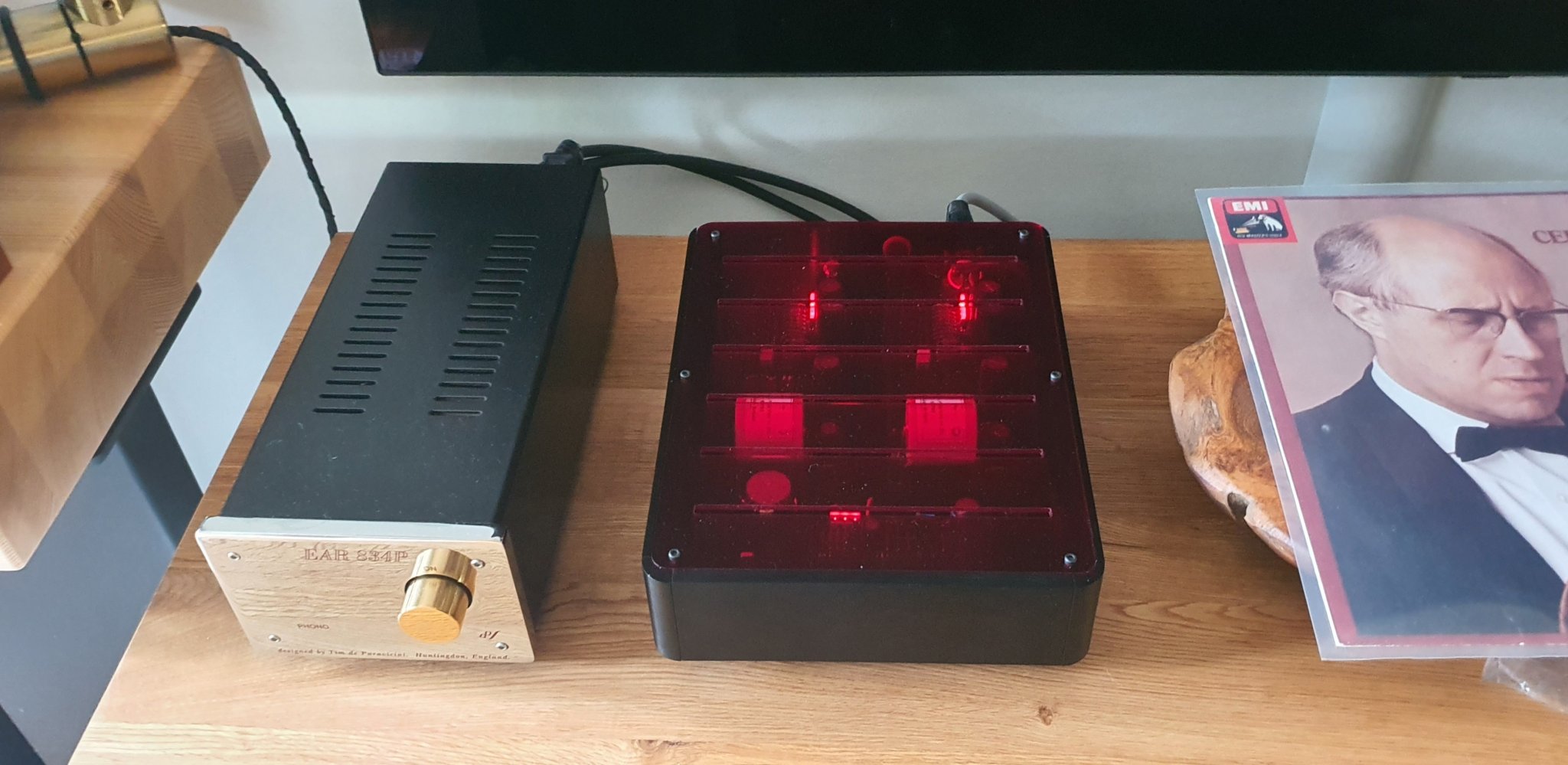

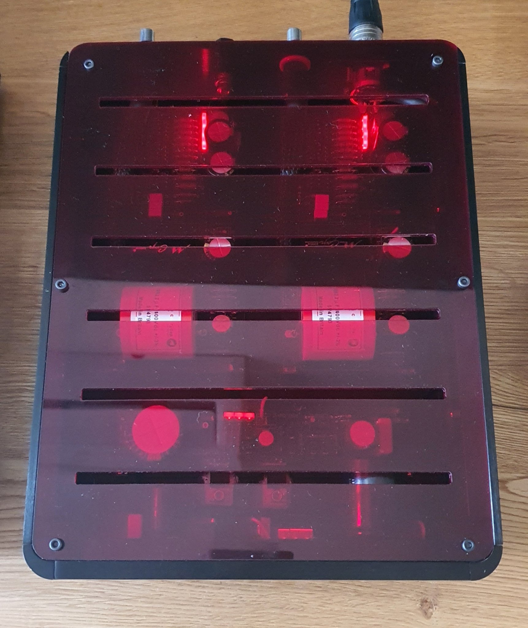

The cover just arrived, so I finished the Ultra.
I'm not really satisfied with the color of the cover, and since I didn't draw the cover in vector cad, there are no marks, so I decided to make a new one with the Salas project mark and draw everything in a vector program.
Stay tuned ;-)
Stay tuned ;-)

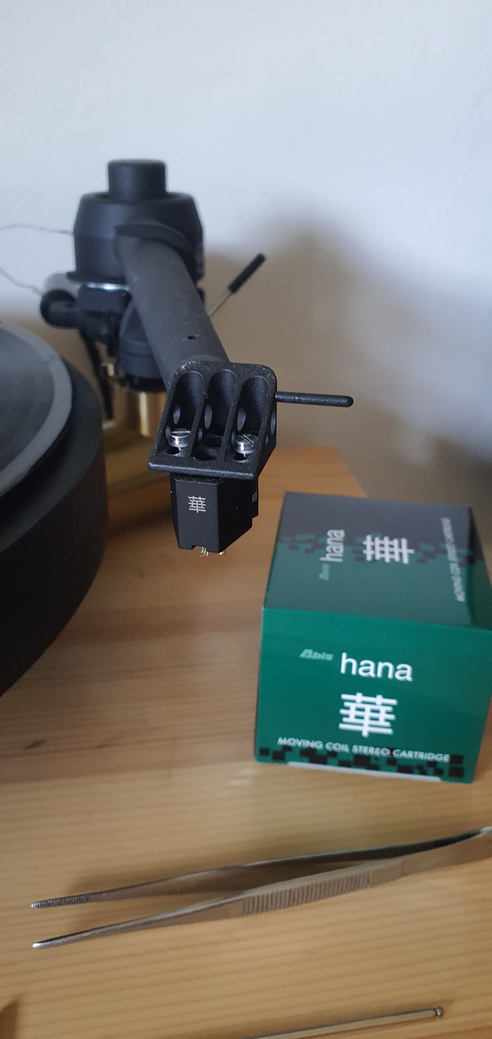

I got the Hana EL and done some testing with it. With this pickup all work flawlessly and no hum even in the 62dB low MC range. So Salas you where right about the higher gain issue with the combination with the super low 0,07mV output from MC20. But the sound from the Hana ML is not as good as from the Ortofon MC20 mkII. Bass is better from Hana EL but i want to try a better MC. May be the DL-301 II? Or any other suggestions? I dont live far away from the Lundahl transformer factory either, and are temted to get a better general stepup and a suitable pickup for it.
I will do some moret settings and testing with the Hana, but are now spoiled to know better sound quality.
Nice to know that your build is fine and it was all about the cart and SUT adequacy.
I don't trust that the DL-301mkII will make a pronounced difference vs your Hana EL. Maybe in tone but not in real resolution. They're both comparably priced aluminum cantilever elliptical. You have been irreversibly bitten by a cleaner Ortofon LMC classic by now I am afraid. It also has a fine line stylus. Ultimately look for something with boron cantilever and line contact stylus or Shibata, 0.4-0.5mV output.
Meantime adjust your EL cart's geometry including VTA & antiskating in the best way you can. Don't forget to experiment with the input load value. Also allow it some run in time to open up further. Max 50 hours will do that. Don't invest further in step up transformers IMHO. Maybe also try sell the super low output Ortofon and its matching vintage super high gain transformer to have more budget towards a newly built healthy output >1k€ cart connecting directly.
Even try that special low MM gain modification I devised for you before deciding on the fate of the Ortofon set. This mod will not eliminate but will reduce the set's excess and hum pick up by a good 6dB.
Thanks Salas. Always helpful. I will try all suggestions. But at the same time I want some advice in real carts suggestions too. To be able to pick good stuff on occasion.
