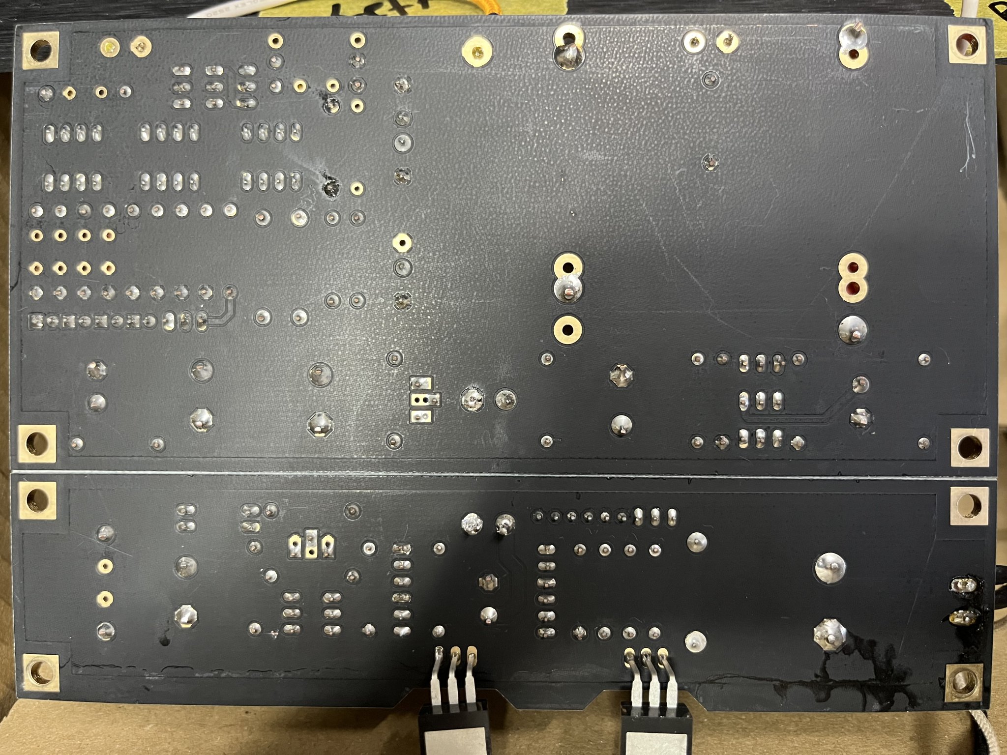

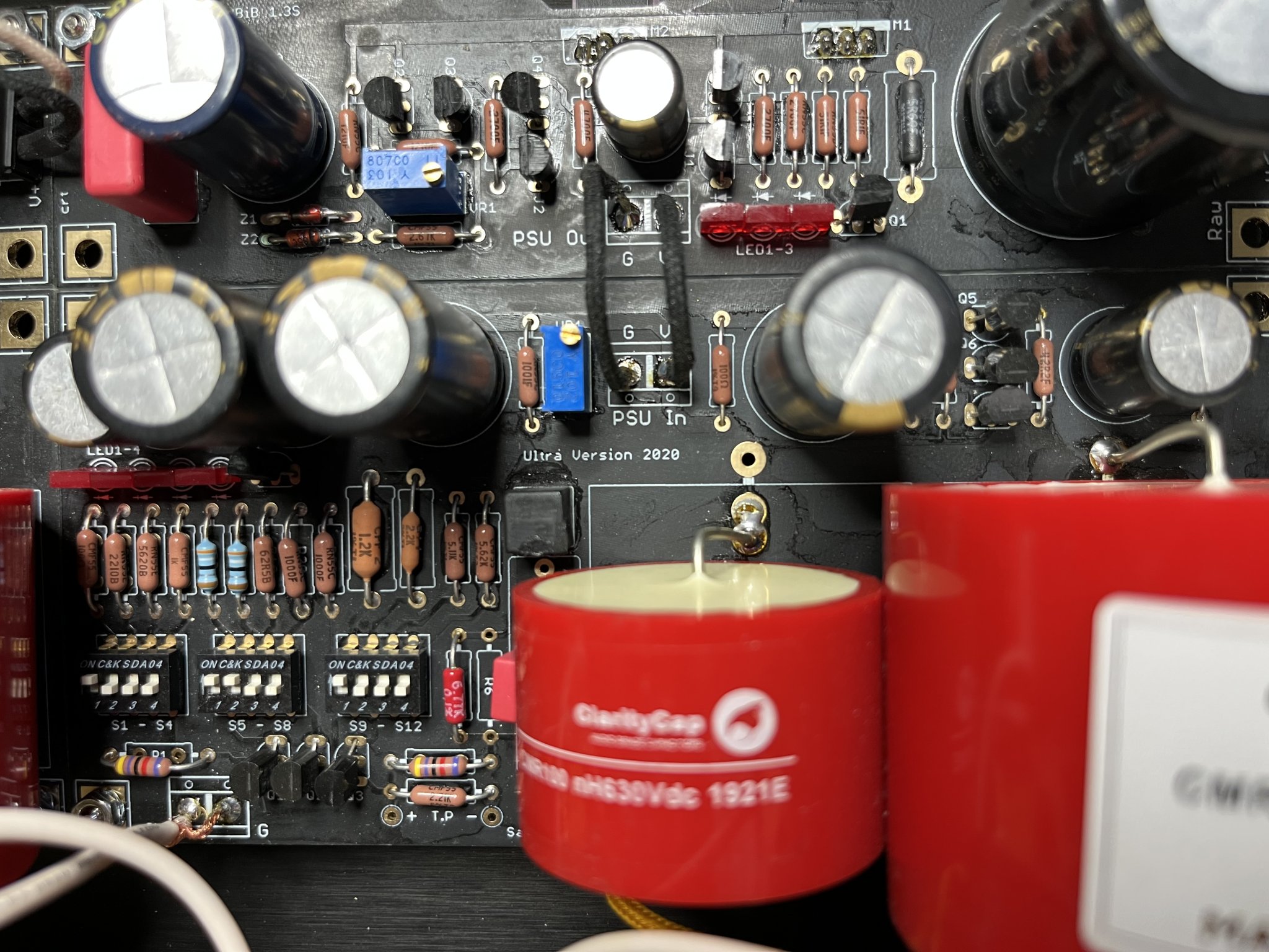

I removed the boards and the inpuf- and output-wires weren’t soldered very well. Reflowed them and put the boards back, and plugged them in. Still one channel missing, and all of a sudden I tried the other input on the preamp. Bam, wonderful stereo!
So I have to re—think my logic and fix that DCG3, if at all, as both channels (Phono + computer) are playing fine. Whatever it was!

Your UFSP assembly and soldering look good by the way. See if some wire shorts with a shield on that particular DCG3 input. There isn't much space between the stereo signal pins and their common ground pin at those input terminals.
