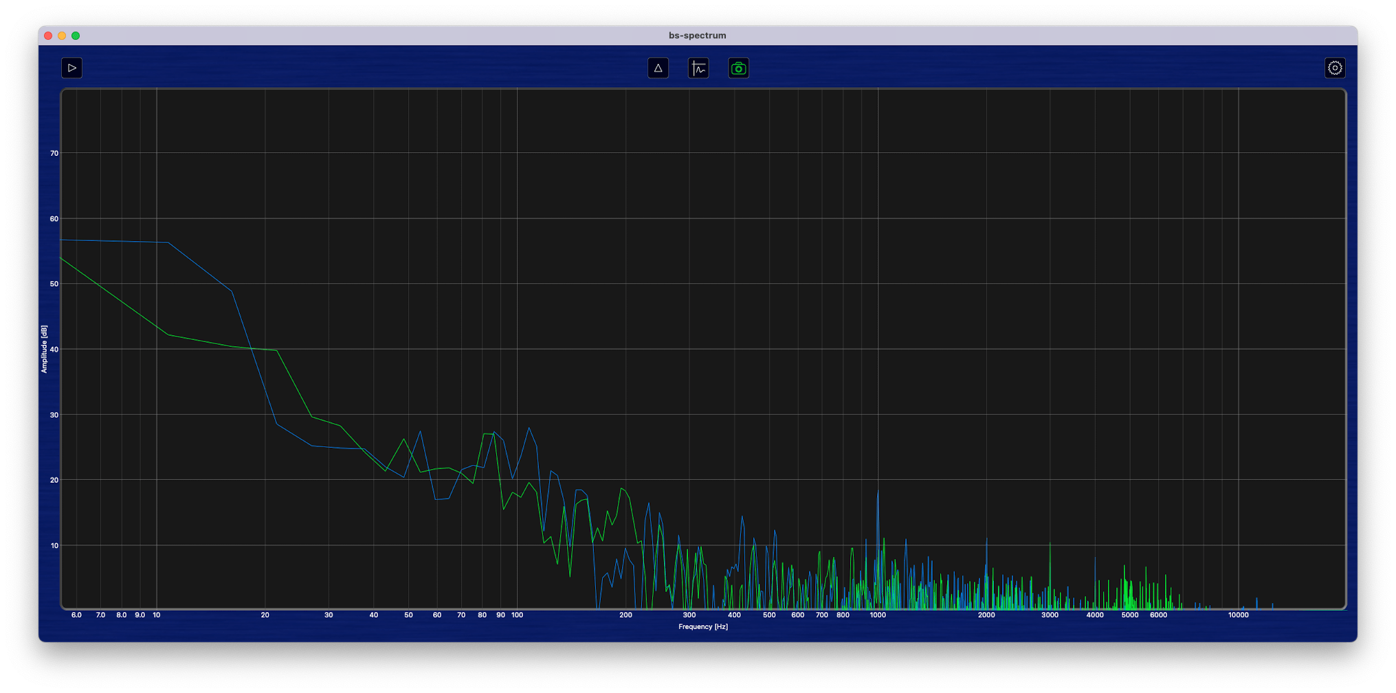

Feed your UFSP output to a computer audio input. Run a free spectrum analyzer app. Play any record on your turntable. You will notice a hill always there below 20Hz no matter what the higher audible frequencies program. Top of the hill is your arm cartridge resonance frequency. See if in acceptable range.
AT compliance is tated at 100Hz. You need it at 10-20Hz. It is going to be quite a bit higher at 20Hz compared to 100Hz. You might try searching the forum for info on that.@DNic , hi, thanks for this. I looked uo the calculator on Vinylengine.com and (wrongly?) thought it was a just-within-the-range match?

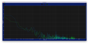

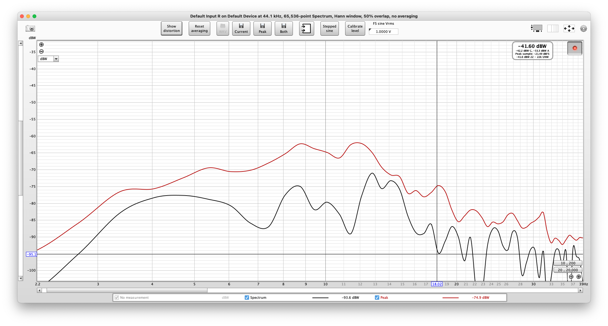

This is fascinating stuff!Feed your UFSP output to a computer audio input. Run a free spectrum analyzer app. Play any record on your turntable. You will notice a hill always there below 20Hz no matter what the higher audible frequencies program. Top of the hill is your arm cartridge resonance frequency. See if in acceptable range.
I got my TT into the computer audio-in(*), and looked at it through REW after first trying out a simple analyzer...
Here's what I saw (first one is REW as you experts will recognize, of course I am not sure at all wether any of this is usable?
File one would suggest a resonance frequency of ~12 Hz or ~8.5Hz, (in Live-mode both hills came up, alternating...
File two has the "peak" at 11 HZ?
Not sure what to conclude: If these measures are correct, I'd think the 11 -12 Hz, occurring in both analyzers, has the higher probability of being the correct one. OTOH, this Polk-Calculation-Service suggests a peak around 6-7 Hz...
*) through a furutech ADL st-40
In REW use 256k spectrum points and Dolph-Chebyshev 150 window for more analysis that low in Hz. Menu is the gear icon on top right corner. Maybe resonance is around 12Hz. Don't use the Furutech because we don't know its infrasonic response. Use the UFSP directly or through the line preamp's main or headphone output.
