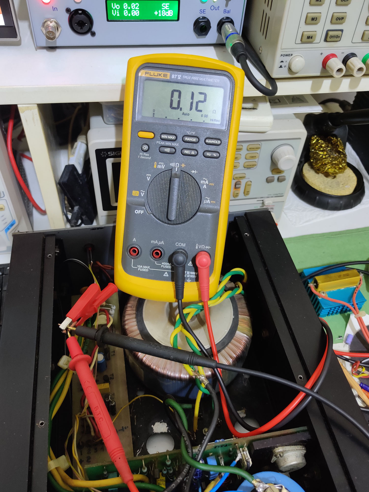

Many meters need a sort of zeroing for accurate low resistance reading. Δ button. Some have it some not. Accepting approximation. In high ranges the test leads resistance is a negligible % anyway. Your 5.6Ω resistors reading as 5.8Ω should be in spec.
I guess these "Southwire" DVM's just don't like very low ohm resistors.
Funny thing is my $20 meter which is not an auto ranging meter measured "5.8ohms" . Go figure
If I don't zero it on shorted leads with the REL Δ button (then it stops auto-ranging) my Fluke 87V adds 0.12Ω-0.15Ω from Brymen silicone leads. So your $20 meter reporting a 5.6 1% part as 5.8 is no slouch.
Thanks for all of the replies. They say you never forget anything, it is the Recall that gets in the way. It took about 18 hours for me to recall that if I short the leads and subtract the difference !!!!!!!!!

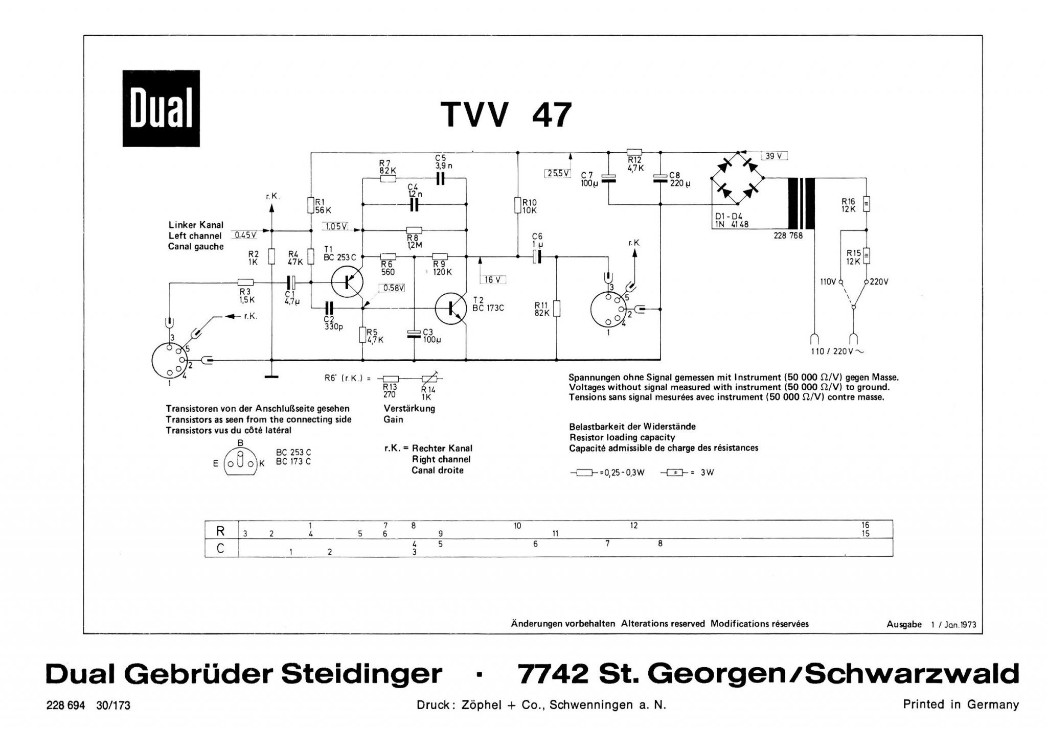

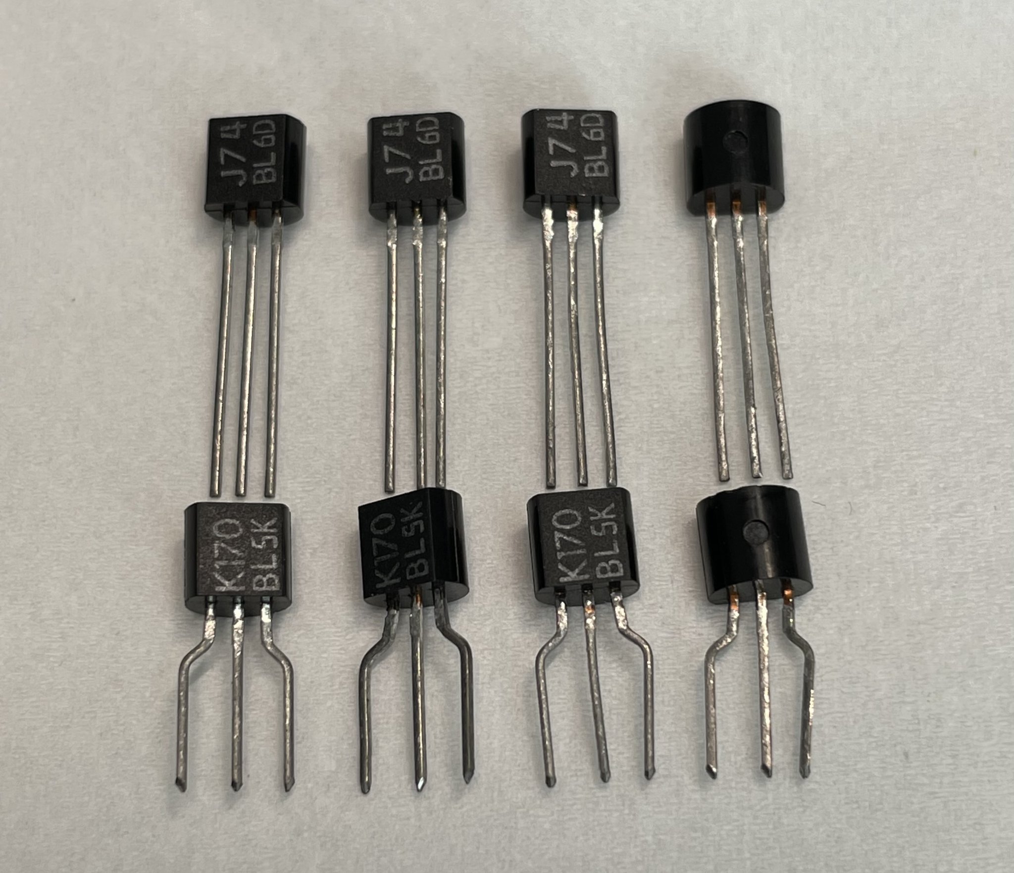

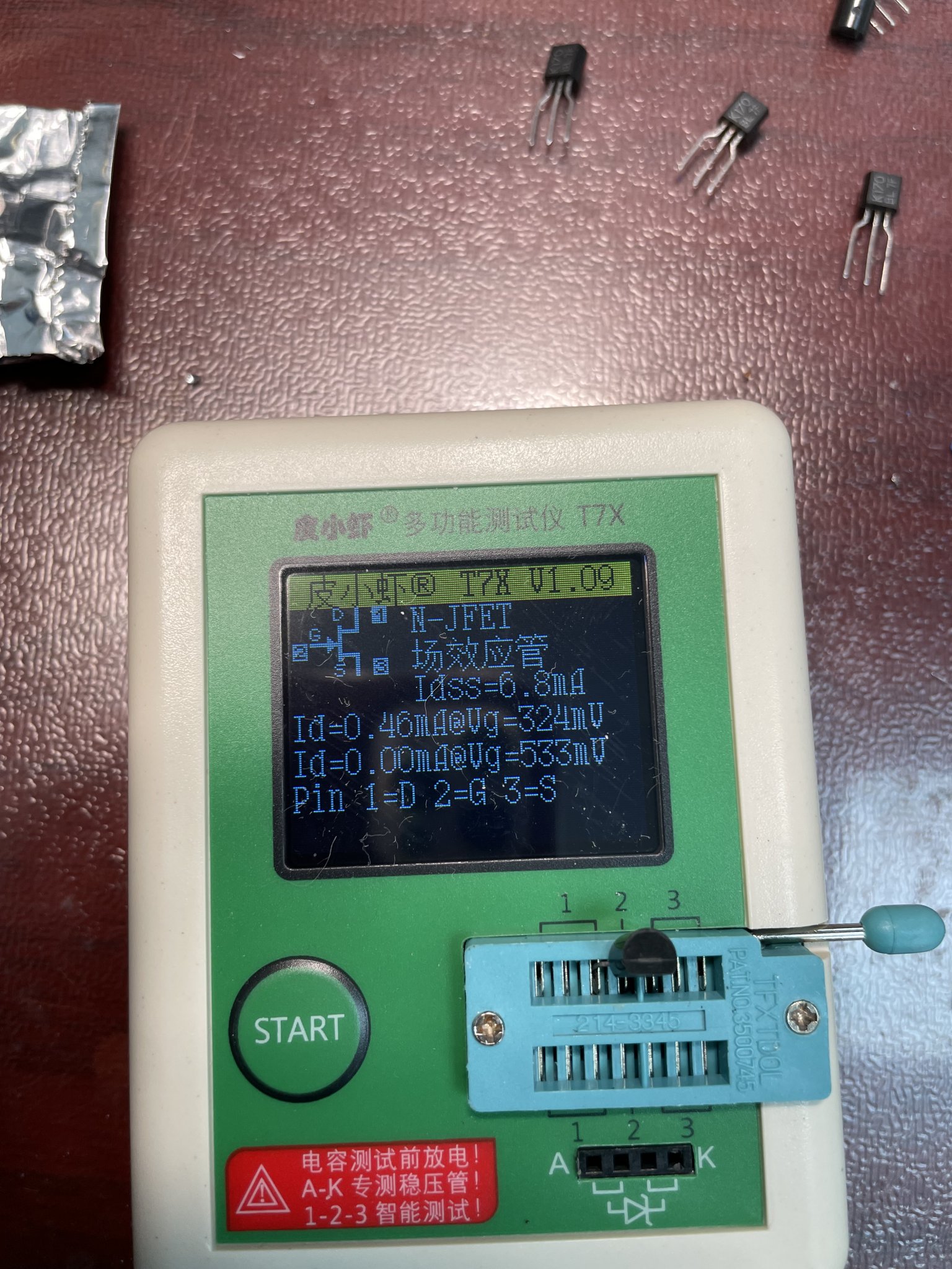

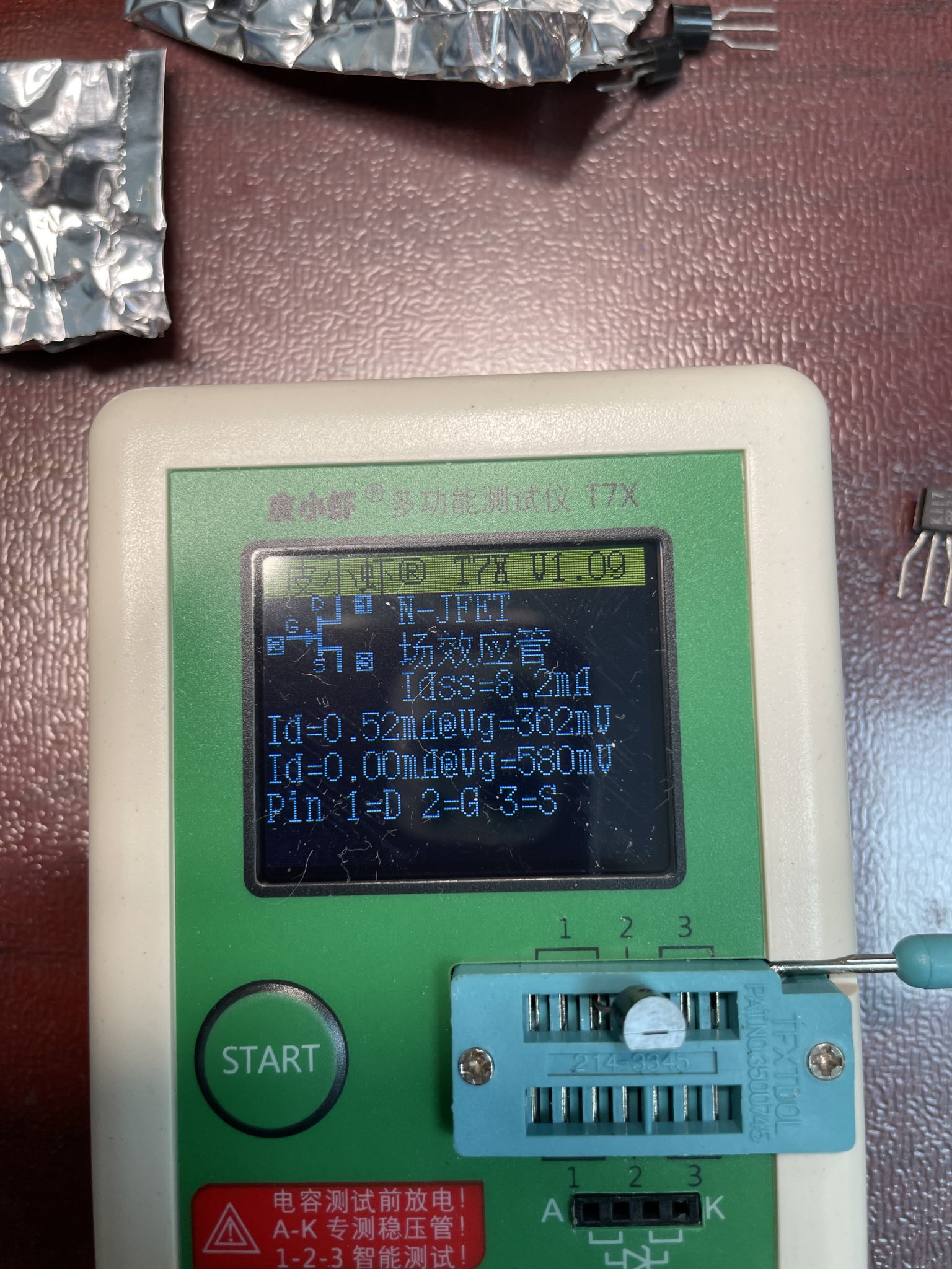

你好,亲爱的和热情的萨拉斯,你的许多想法丰富了我的生活,给我带来了快乐,谢谢你!我偶然得到了一个古董TVV47唱机放大器,我附上了一个路线图,它是TVV46的高级版本,在这里,我想问我是否要将图片中的T1更改为2sj74(BL,idss= 6.8ma),T2更改为2sk170(BL,idss= 6.8ma),因为我手头上只有几对,但我是幼儿园水平, 我想尝试一下,但我不知道如何设置合适的工作点,你能给出建议吗?我知道这有点自以为是,但我真的很想看看衰减的RIAA和反馈RIAA的感觉如何不同。节日快乐!
"Hello dear and warm Salas, your many ideas have enriched my life and brought me joy, thank you! I got an antique TVV47 phono amplifier by chance, I have attached a roadmap, it is an advanced version of the TVV46, here I want to ask if I want to change the T1 in the picture to a 2sj74 (BL, idss=6.8ma) , T2 changed to 2sk170 (BL, idss=6.8ma) because I only have a few pairs on hand, but I'm kindergarten level, I want to try it out, but I don't know how to set a proper working point, can you give any advice ? I know it's a bit opinionated, but I'd really like to see how decayed RIAA and feedback RIAA feel different. Happy holiday!"
Hello, please translate and post in English only.
Unfortunately you can't drop JFETs in a BJT transistors finished design. The JFETs in your picture have wrong print details, possibly copies, better avoid using them in general.

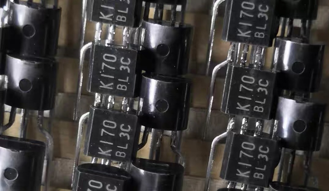

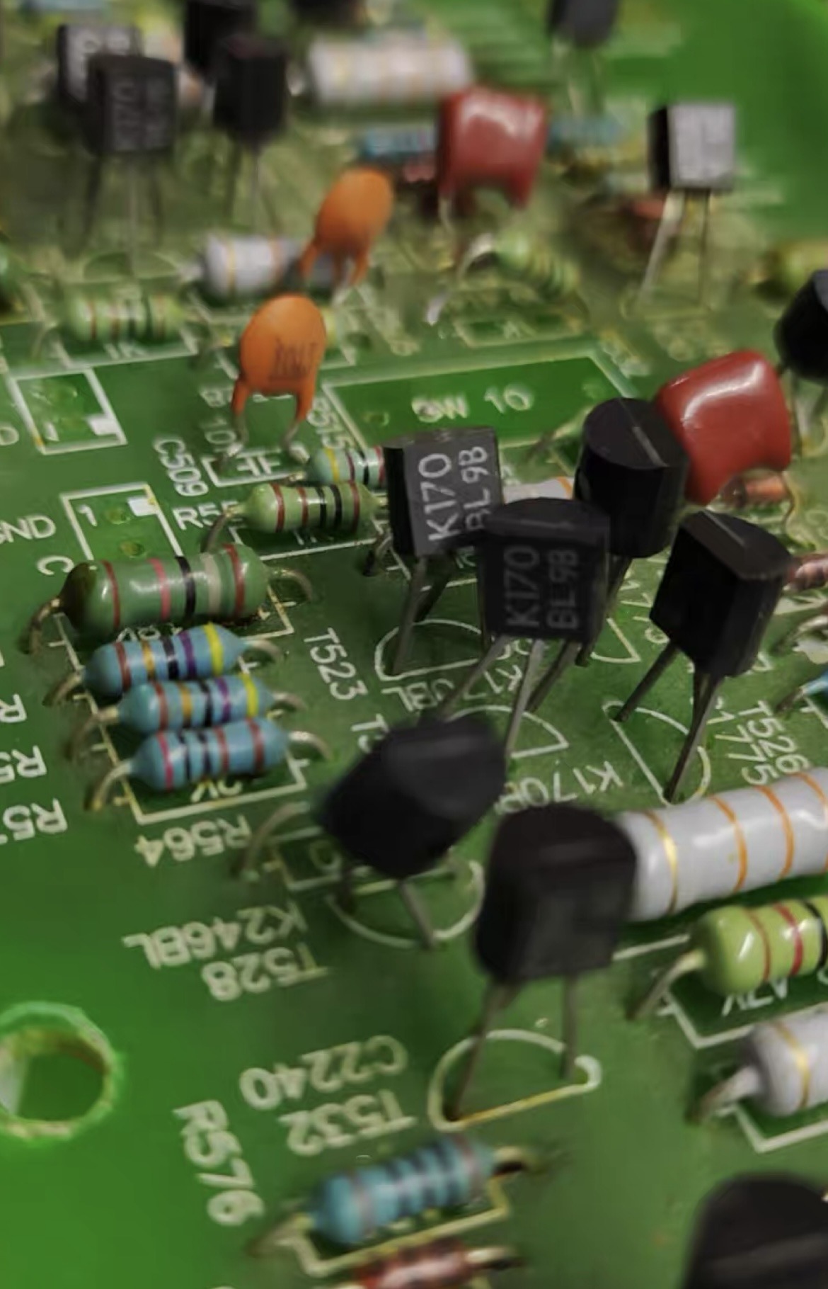

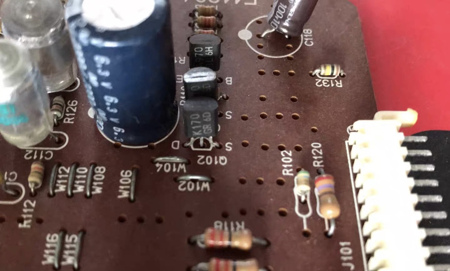

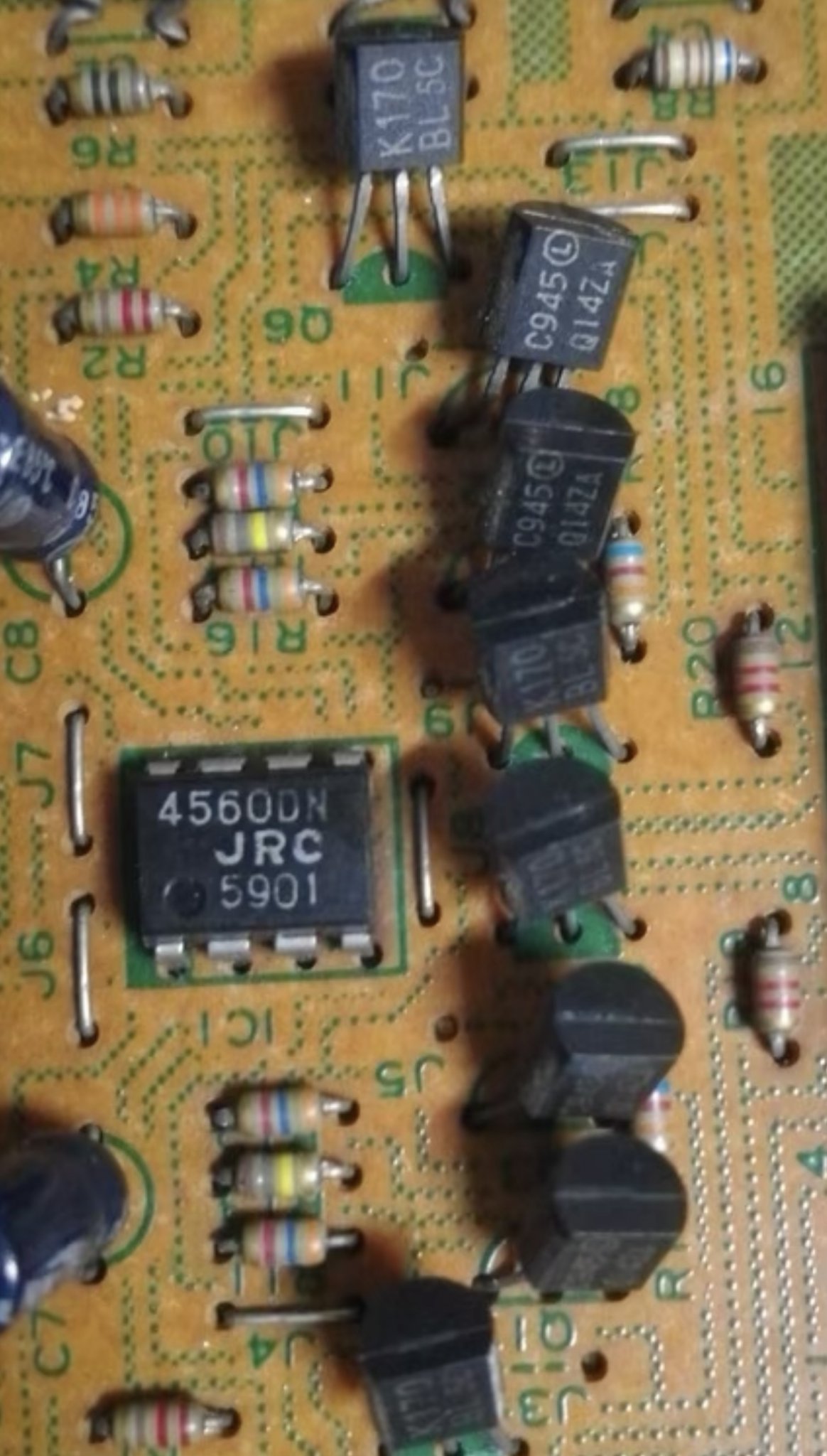

I flipped through some of the early Japanese circuit boards today, and found that the K170 pipe body of Toshiba's period had a font face that was slightly concave and convex, and the white print was consistent with my tube, and now I can buy the K170 is a smooth face, laser lettering, please see the picture, it may be caused by different production dates, my feelings, for reference only
