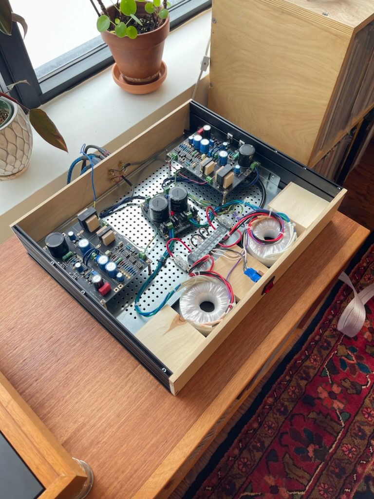

For R8, I have 39 or 47. Is there a best choice between these?In UFSP BOM - R8 and R11 "depends on idss of Q4 and Q5" see sheet. Not sure what sheet?
In FSP build guide - Q4 idss 8.2 - 8.5, Q5 idss 7.5 - 8.5, Q6 idss 9 - 10: I can easily find these values from my LSK170B supply. If I use these values(tested with DCA75) do I stick with R8=43 ohms and R11=1.5kOhms?
CorrectThank You, and I assume my LSK170B Q7 should be 4.7-7ma .5 difference between channels, same as PF5102.
Thanks for all of the support. I'm ready to start up. I have 44.7V raw DC unloaded.
Should I start with Raw DC connected to UBIB and UBIB not connected to preamp.
Also I dont have a TT rig at the moment(Listening test will be at a friends later) so what tests can I perform with signal Generator and scope..
You could proof test the 1.3s outputs by loading them with 560R or 680R 2W (or 5W not getting so hot) dummies instead of the phono channels.
For signal testing you could pass 1kHz 100mV RMS generator sinewave output through 1k series & 10R to GND voltage divider, use it as 1mV test signal to the phono input. It cuts the generator's noise. Then look for healthy phono signal output at least in the 300mV RMS range and compare the channels gain matching on the scope. Don't use other frequencies unless you got some anti-riaa filter.
Using 600 ohm resistor, It looks good so far. - Channel 1, DC raw loaded = 41.5v, regulator range 28.4 - 39.5V. Channel 2, DC raw loaded =41.5v, regulator range 28.2 - 39.1V. led trios come up matched brightness.
Im not liking my signal with 1k and 10 resistor. its more noisy with the resistors than 1mv straight out of the signal generator but its noisy straight out as well. maybe leads are picking up. I'll skip that step for now..
Anyway, both channels 34V from ubib and dialed in 4v at the test points.. listening is next step..
In this case use coax test signal cable and put the divider resistors in a metal barrel RCA at the receiving end for shielding. Its a matter of impedance as well. It is a 1:100 10 Ohm source impedance divider. If not terminated with a 100 Ohm to 300 Ohm as the phono does, but simply checking its test signal with a scope's probe, which certainly shows very high impedance, it will pick up more interference. Anyway, if you saw strong signal gain at the phono's output, even noisy, means it works.

Zout is 50Ω but with small current reserve. As much as Q5's Idss. The output capacitor value is also calculated for 20k minimum. Thus better avoid long high capacitance interconnects and a low Input impedance next stage. Use a higher value C4 if unavoidable.
I will eventually make up suggested test cable for testing second UFSP, maybe a third one and this first one later.. Thanks!In this case use coax test signal cable and put the divider resistors in a metal barrel RCA at the receiving end for shielding. Its a matter of impedance as well. It is a 1:100 10 Ohm source impedance divider. If not terminated with a 100 Ohm to 300 Ohm as the phono does, but simply checking its test signal with a scope's probe, which certainly shows very high impedance, it will pick up more interference. Anyway, if you saw strong signal gain at the phono's output, even noisy, means it works.
UFSP was delivered and worked in system perfectly. Sound is totally hi-end. Treble, dynamics, resolution, everything! temporary case as it will eventually go into 2 boxes of Slimline 3u with DCB3 and a DAC.

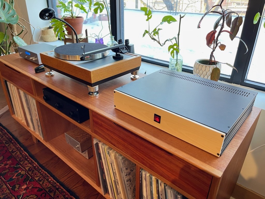

Congratulations for your success. You are welcome. Nice touch with the wooden panel, fits to the picture's installation environment. What C3 C4? Tell us a few words about that system too.I will eventually make up suggested test cable for testing second UFSP, maybe a third one and this first one later.. Thanks!
