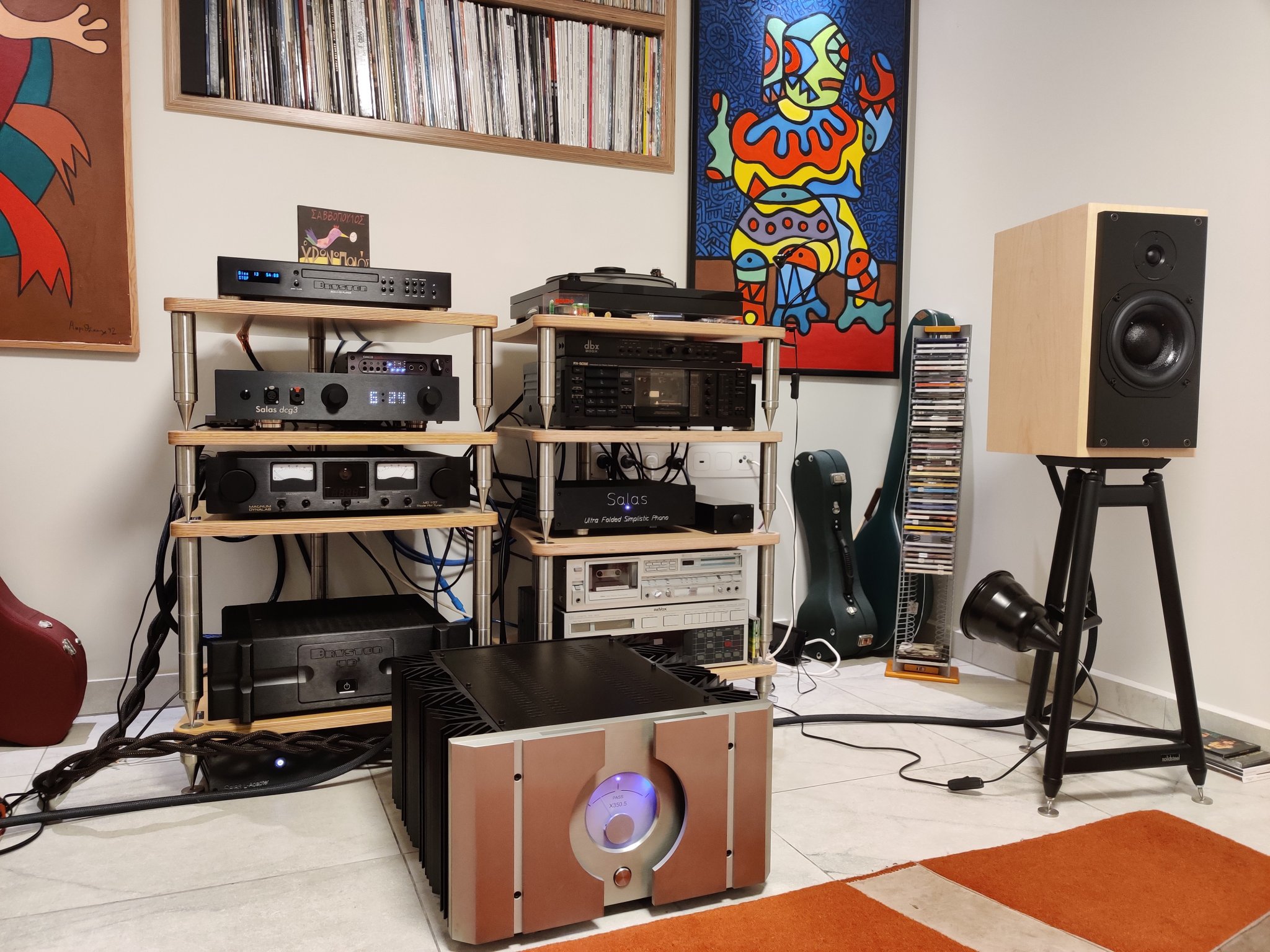

Was listening to a big Pass amp at a friend's today. He tried components matching the day before. Found him enthusiastic on how the UFSP and DCG3 are ultra synergistic with this amp's character according to his trials. I wasn't there the other day for more to say but I took a photo today.

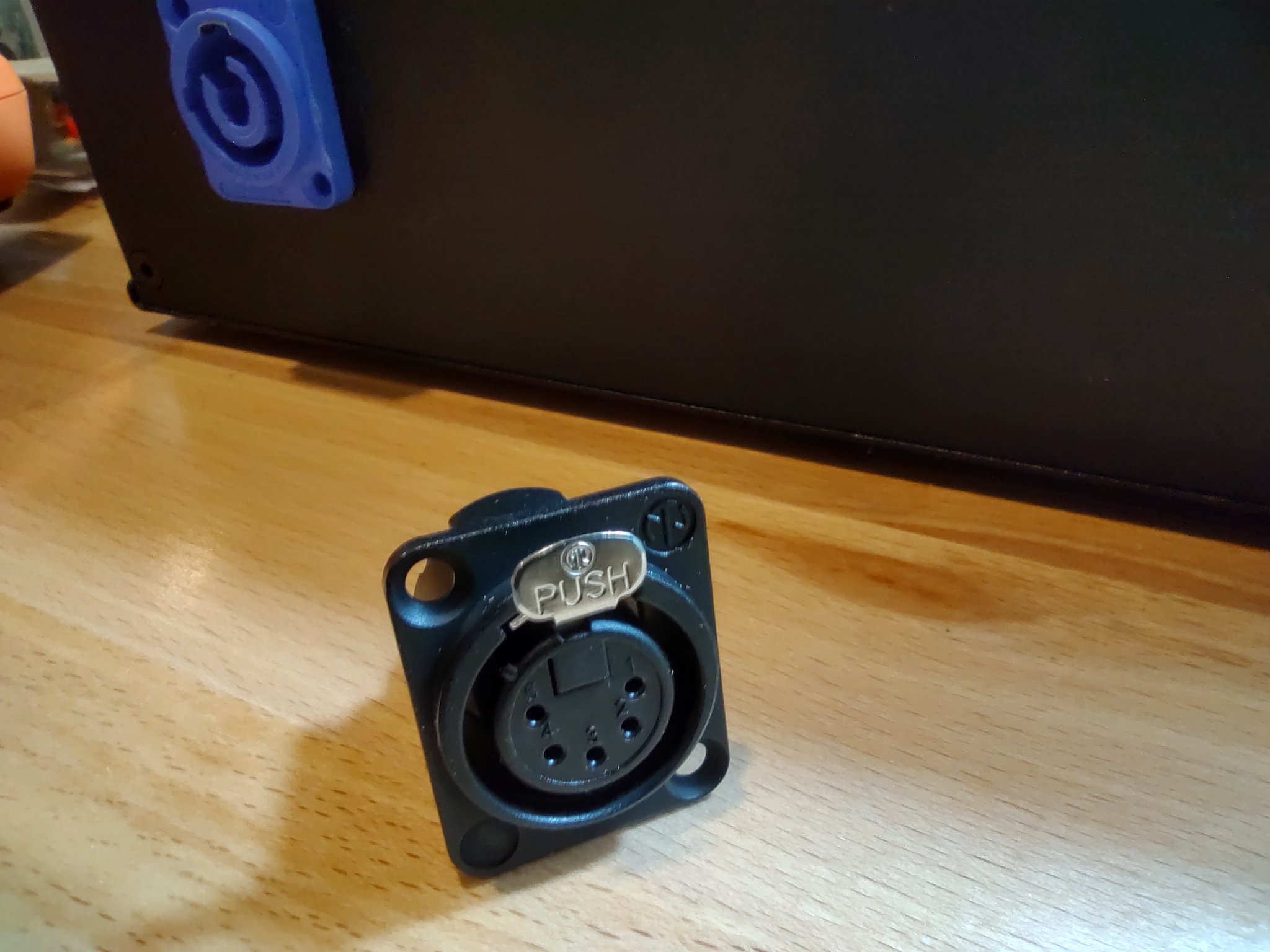

Like many here, I'm using 5 pin XLR plugs for my plugs on the power umbilical. For the female chassis mount jacks, I used Neutrik NC5FD-LX-B. They have a small ground tab, I see how others have done the connections on the cable end, on it's ground plug, but saw no mention of using the one on this female jack.
Reason I ask is, the body of this jack is metal, and there is continuity between it and this small ground tab, so it is effectively grounded to chassis.
Is this in any way a problem, and should I see if they have a 5 pin plug made of that plastic like material they use on some of their other connectors?

There is no problem for a two box configuration. The 5th cable (the shield) should be connected into one chassis and we concluded that it's better to the phono chassis.
What is important is to not connect the shield in both ends i.e. chassis to chassis).
So since the 5th cable will go eventually to the chassis I think there is no problem (I assume that this socket is for phono chassis)

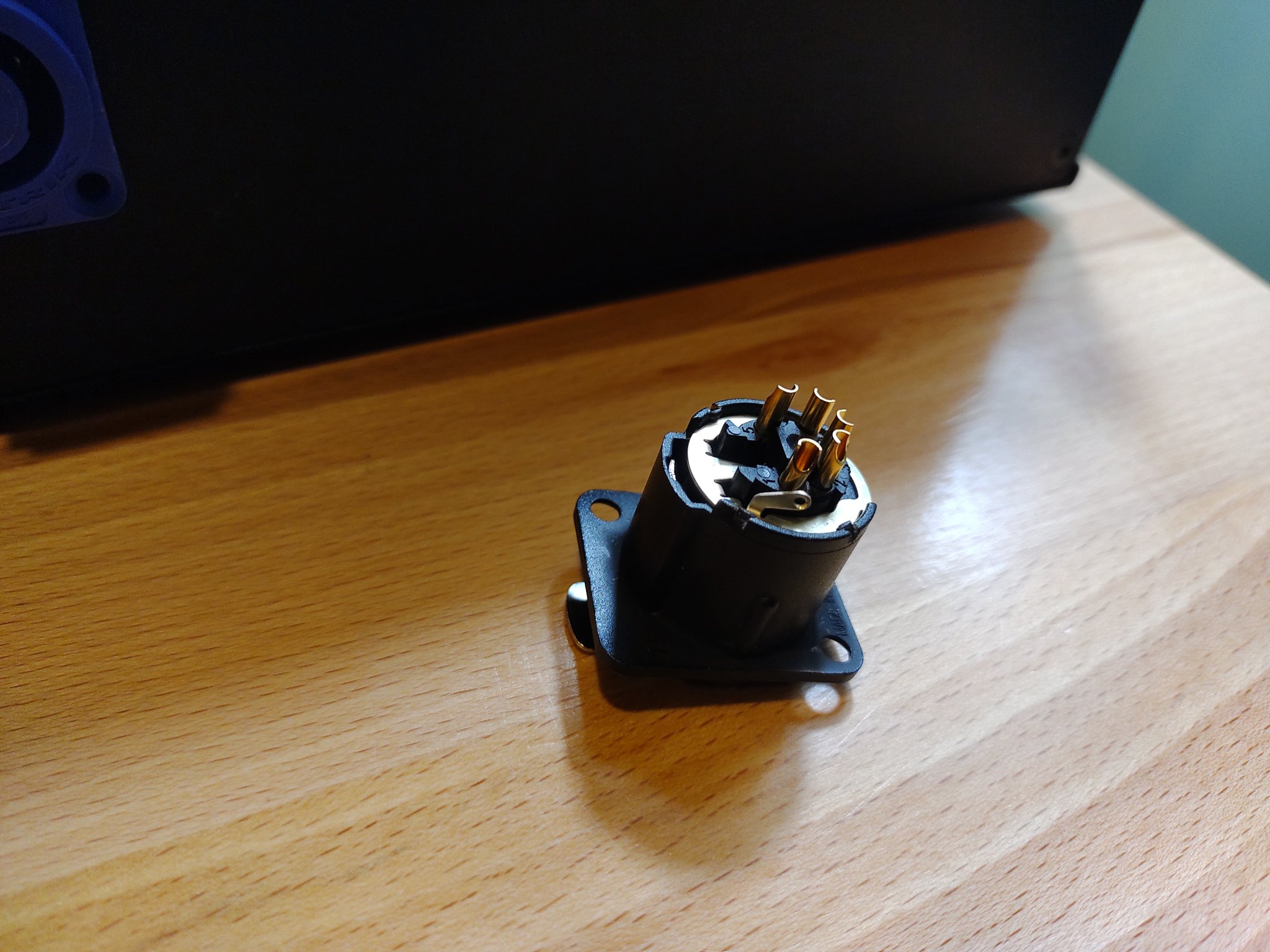

Is this only connected at one end of the umbilical?See pic of the grounded end. It's totally conductive—makes direct contact with the outer metal fitting once the connector is all screwed together...

Thanks. My question is more about the female chassis mount part I showed. Is that ground tab used?https://www.diyaudio.com/community/threads/simplistic-njfet-riaa.129126/post-6598127

Looks like umbilical shield only soldered to phono board end, not on power supply box.
Seemed odd it had a ground tag on back side, but had continuity to it's metal case. (And thus the chassis)

As I understand it. It is only connected at the Power Supply end. Yes, the ground tab on the female chassis mount at the power supply end is connect to Ground. The Male connector that plugs into the Power supply has the shield soldered to the ground tab
the shield is not connected to the ground tab on the male plug on the phone pre box.

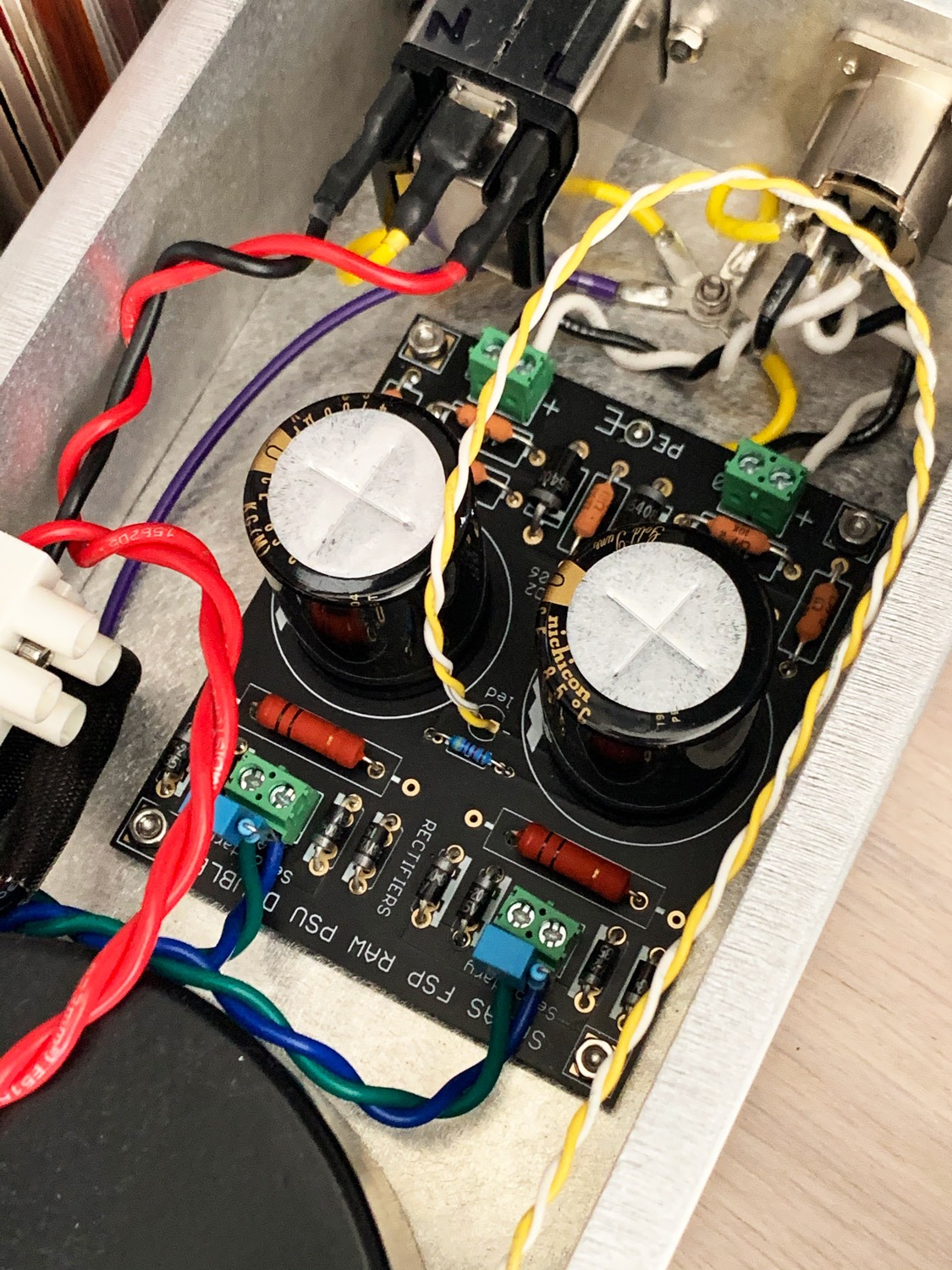

This is a picture of Pfarrell"s Power Supply. Note the ground hook up on the female chassis ground tab. One of the links above shows how he assembles his umbilical

@Russelic and @A321Drvr, TeaBags says that he didn't noticed any difference connecting the 5th cable to either sides.
@A321Drvr, I've connected my 5th cable the other way, to the Phono chassis/ground, while you say you have it on the PSU ground/chassis. The important is to NOT connect it in both side and of course if you don't connect it anywhere is useless.

As I have listened to his system, key aid in his choices is the increased midrange resolution and presence of the ATC monitor speakers. There's an SVS closed box sub in a corner too. He started to discriminate gear more apparently for their pros & cons with the ATC.
By the way, turntable is Bauer Audio DPS3 with the Bauer unipivot tonearm, cartridge is Dynavector DRT XV-1t.
