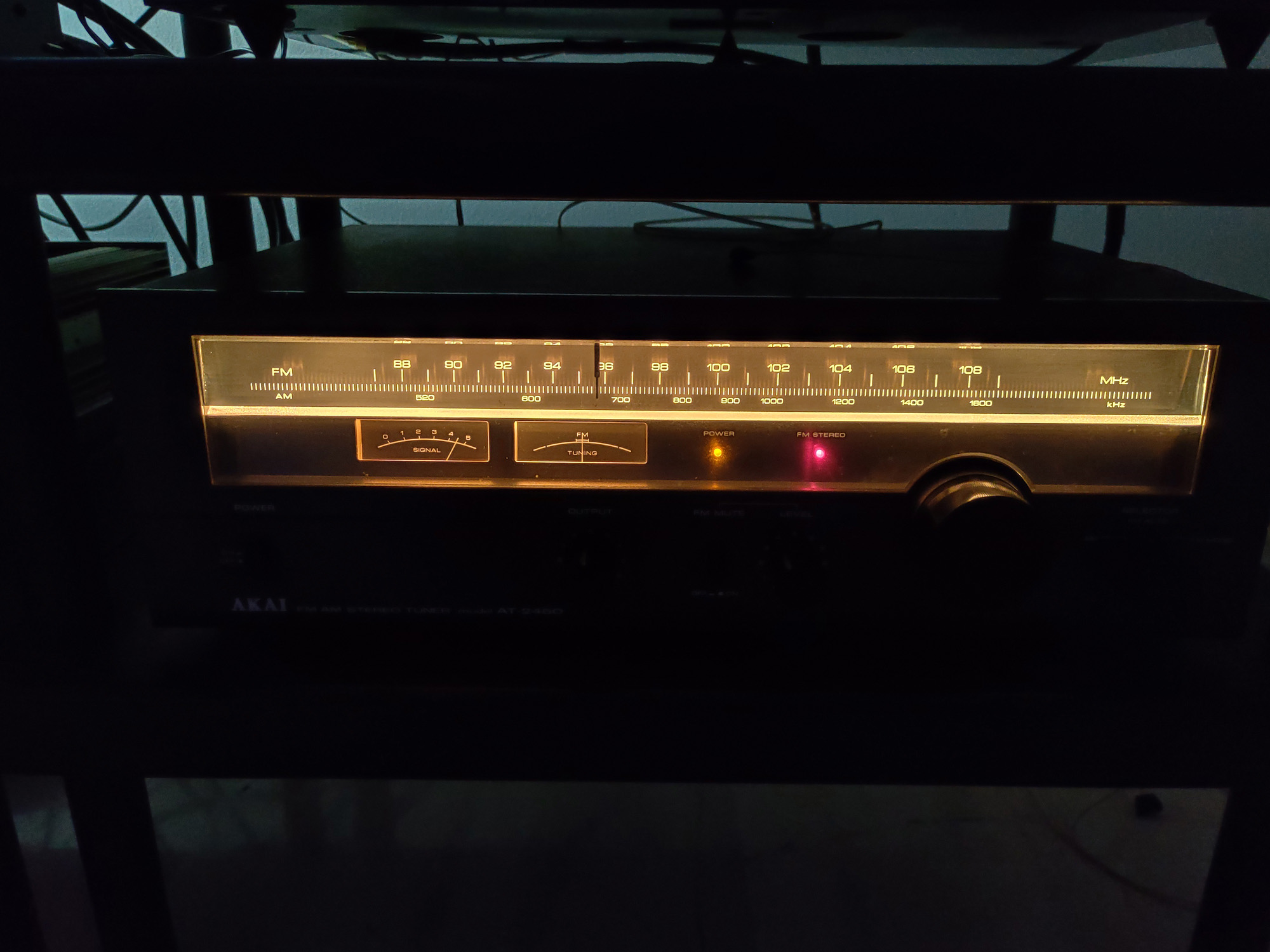

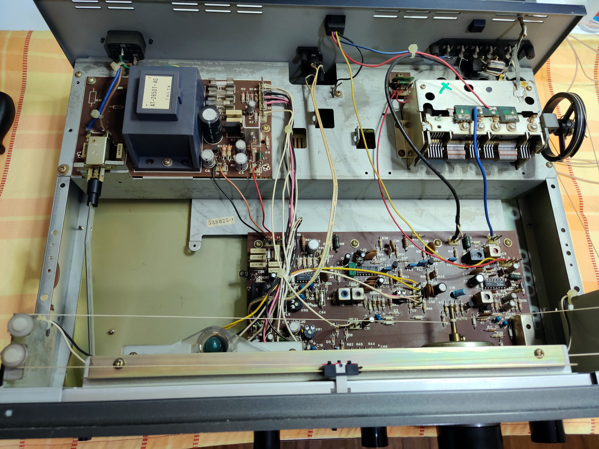

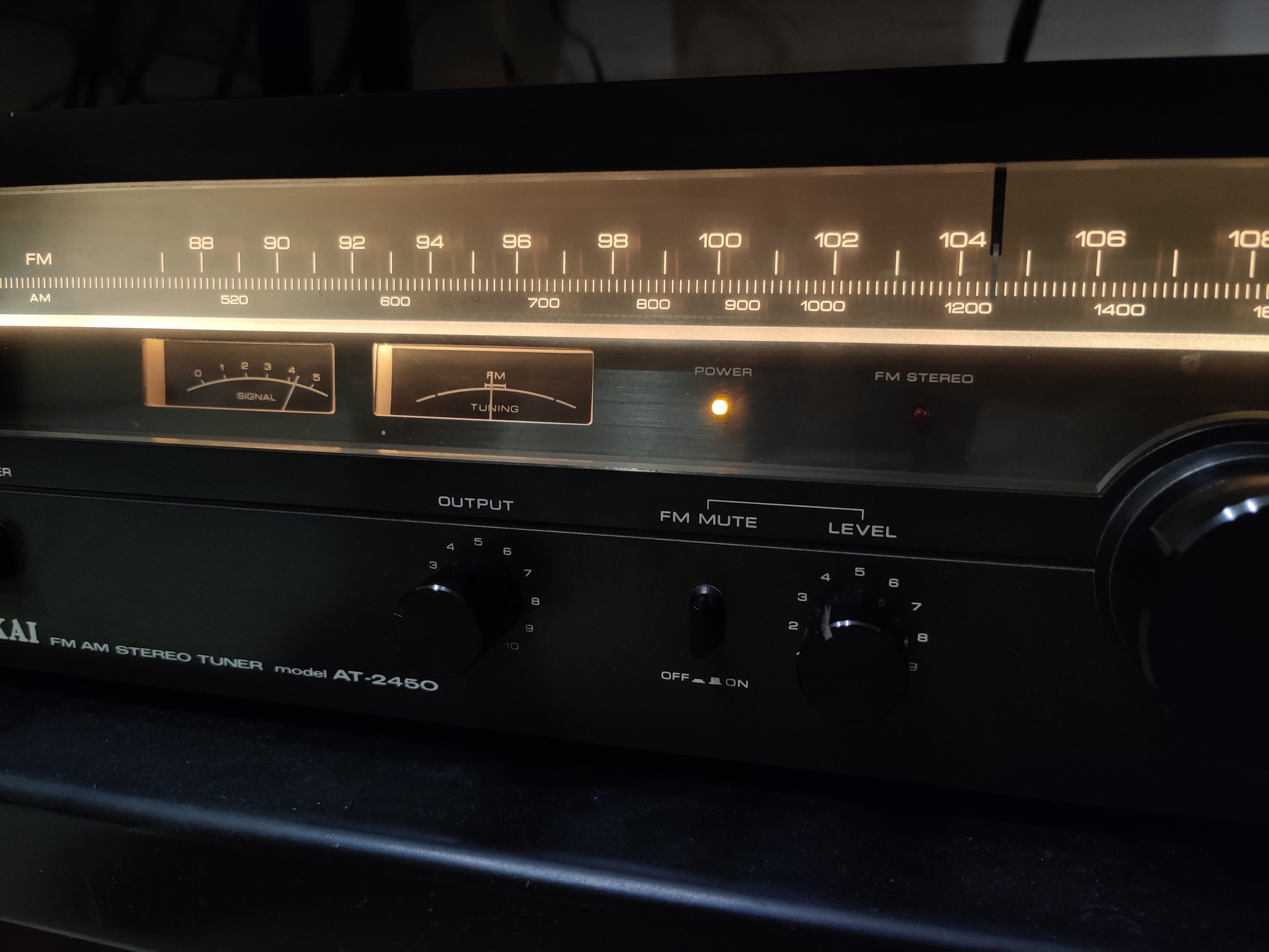

By the way I am happy because I scored an FM tuner from the late 70s that nobody had de-tuned or modified and all its lights and parts are original and working. An AKAI made in France. Weird thing that.
Just with four gang front end but brings full signal from a T wire dipole thrown on the floor. I am now listening again to old good analog FM stereo on a real system with it. Has warmth, strong staging, and sheer presence of body and drama in music. On good classical and Jazz transmissions you can listen for hours without fatigue. FM, tape, vinyl, are birds of a feather and flock together.

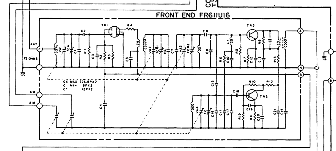

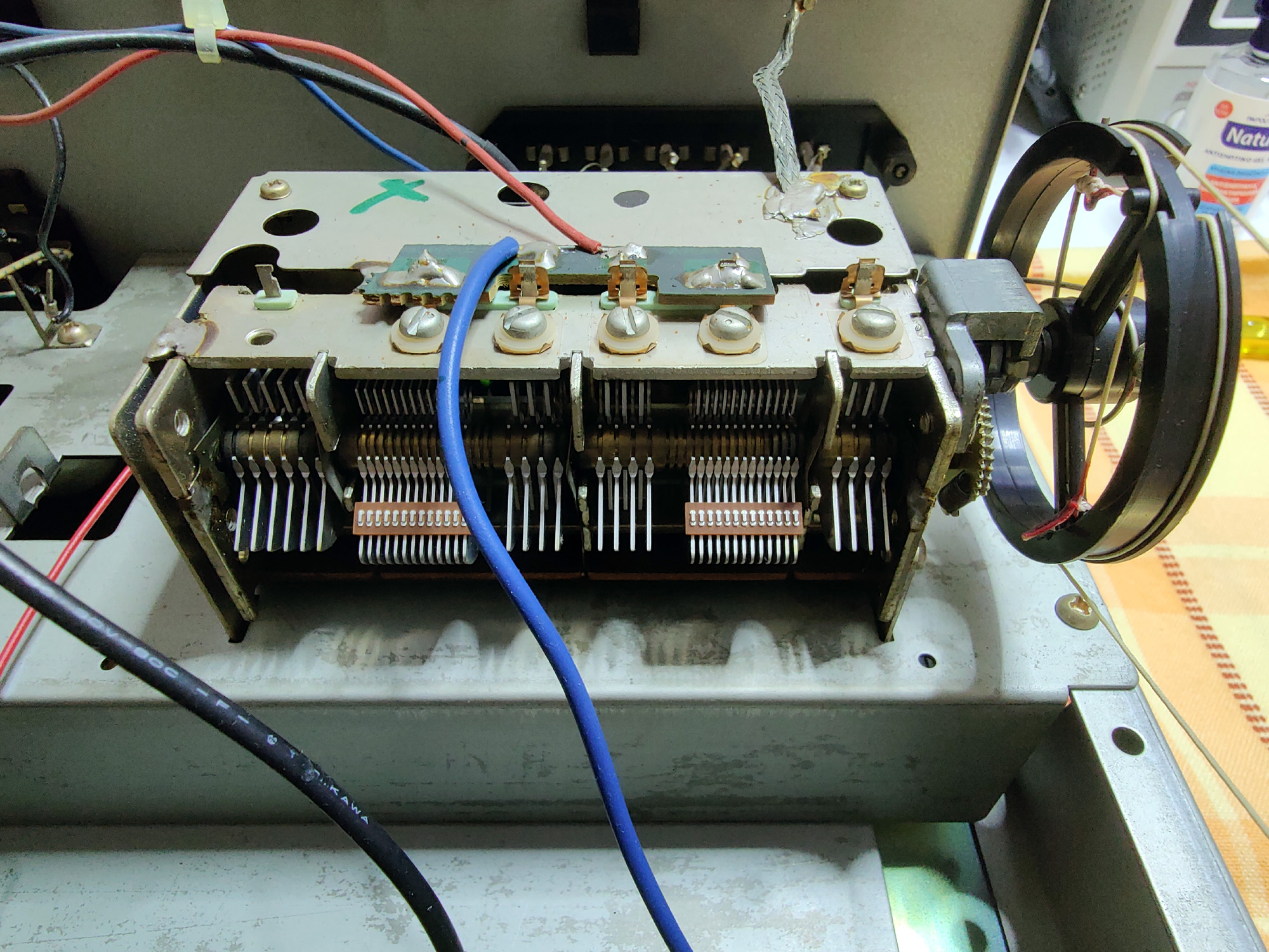

It looks like one of the variable capacitor sections is acting as a preselector on the FM input - is that correct?
Photo right to left first four discs section tunes the antenna to a booster using dual gate Mosfet TR1, next four discs filter the RF, another four discs sharpen that more, leftmost six discs tune the local oscillator TR2 that mixes output with the carrier at TR3 to produce the IF beat (intermediate frequency) to send downstream for detection. The two many sections groups with brown strap in between are for AM tune. The screws are TC (tuning cap) FM ant AM FM FM AM stages and in the hole at top mid-line left is TCo(scillator).
They used dual gate Mosfets back then in the better front ends. 3SK37 and alike. I have a friend who has a seven gang SONY ST-A6B which had been messed with before and it had low signal down to indication two. Also missing meter lights. He did recap to no result on signal and he tweaked the trimmer coils in the end to up the signal. It came up but who knows how it looks like on a swept signal IF bell curve test. Takes a ton of vintage lab gear to fully and surely align such beasts. Sounds good at least. And he recently located the missing fuse style lamps replacements.

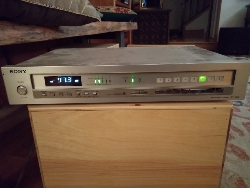

By the way as I see in its service manual your SONY is four varicaps FM (three tune one local osc.) and has a good build. Four gang FM equivalent.
Yes once the IF stages have been messed with it takes someone who really knows what they are doing and the right equipment to get things back. I've adjusted 455 kHz IFs on radio equipment but that is pretty basic compared to properly aligning a stereo FM receiver.
That is good info on the Sony, I haven't needed the service manual but I should get it - did you just google it? I did read that the audio opamp section in it could use some improvement.
