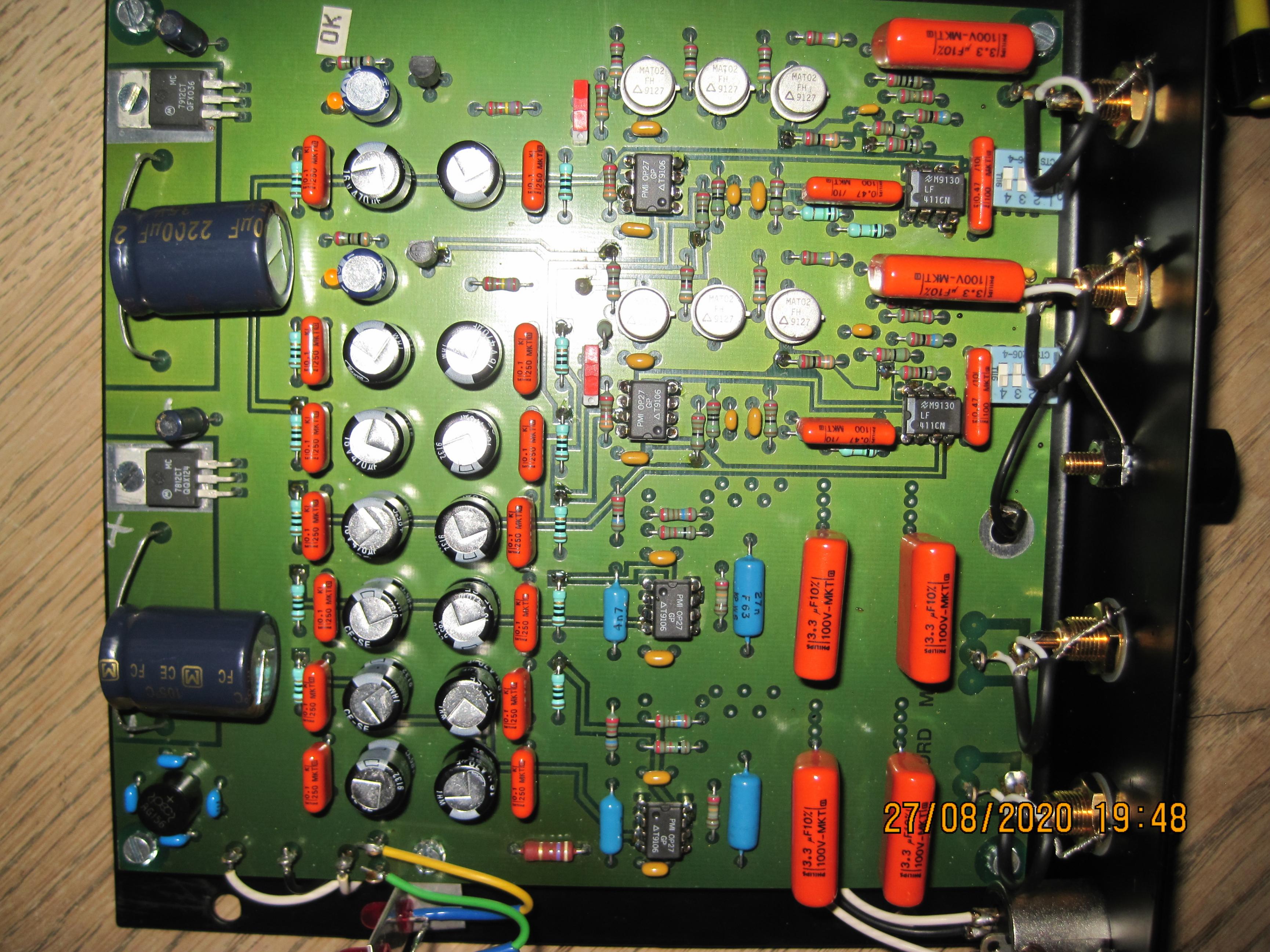

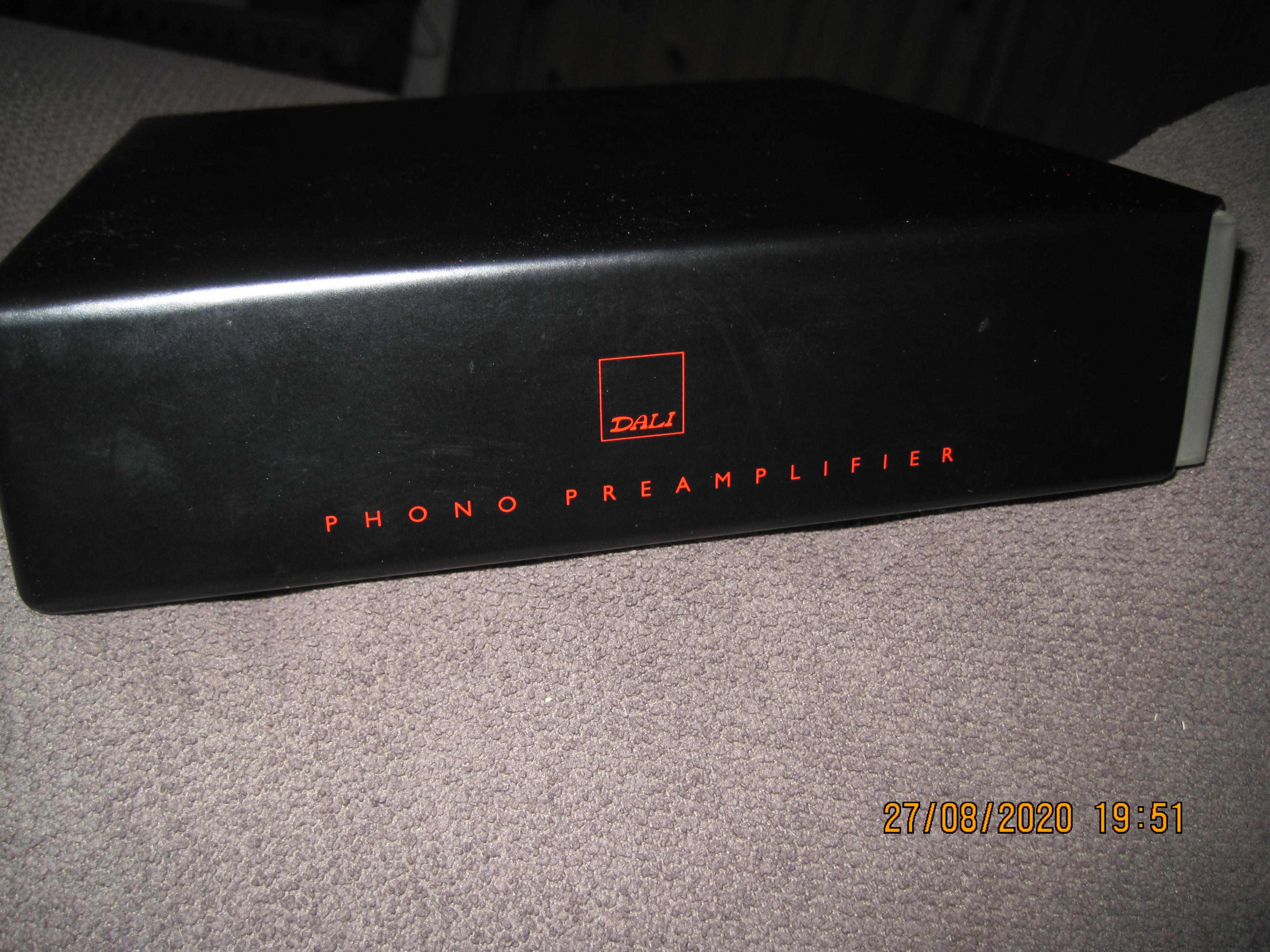

A Dali Phono Pre.
Looks sophisticated with three parallel MAT02 monolithic low noise dual BJTs. Film caps are many but the LF411 low offset & drift JFET input op-amp is usually employed as DC servo so most of them must be rail bypasses except for one to block DC offset to the cart from the MAT differential input stage.

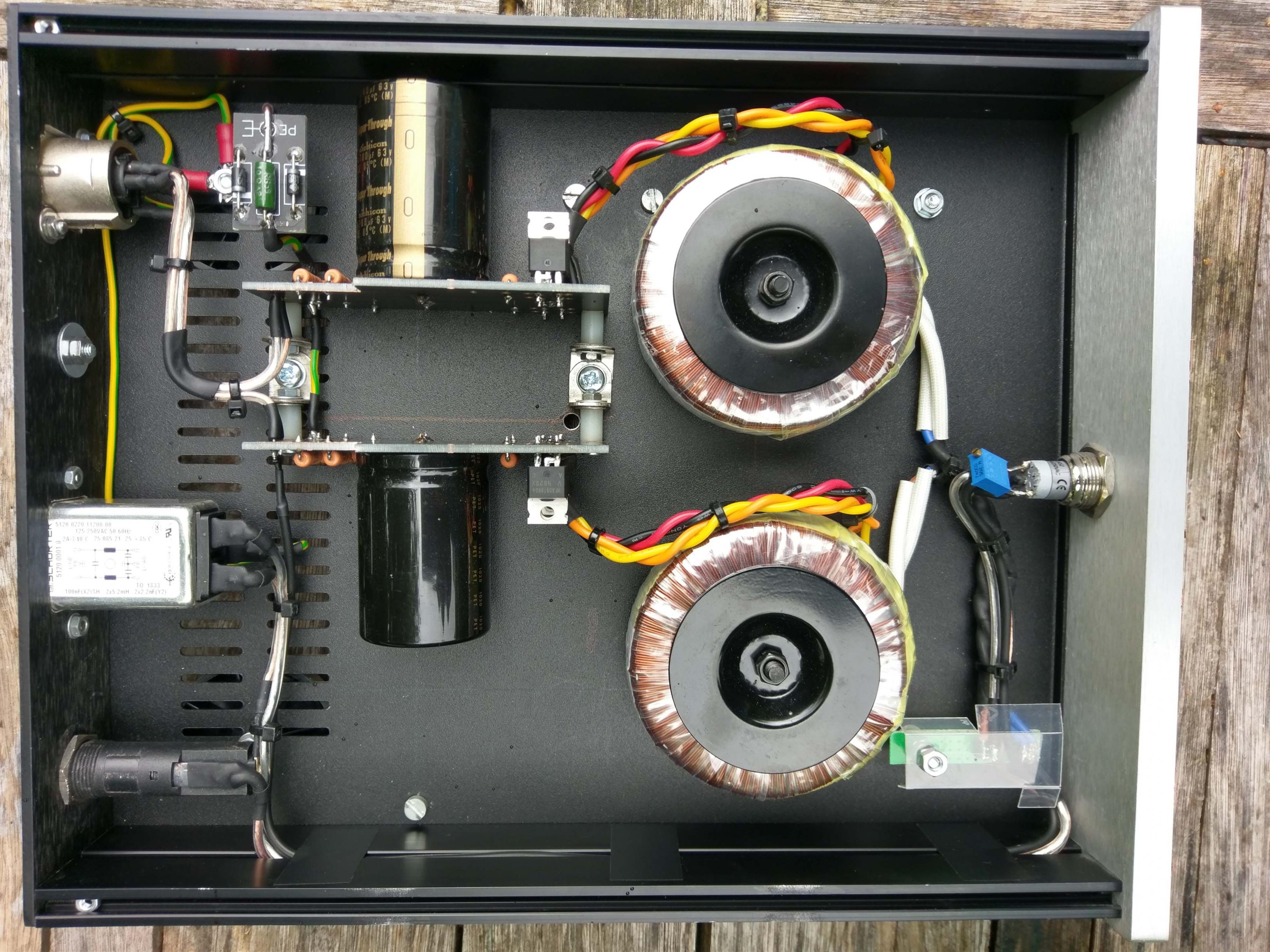

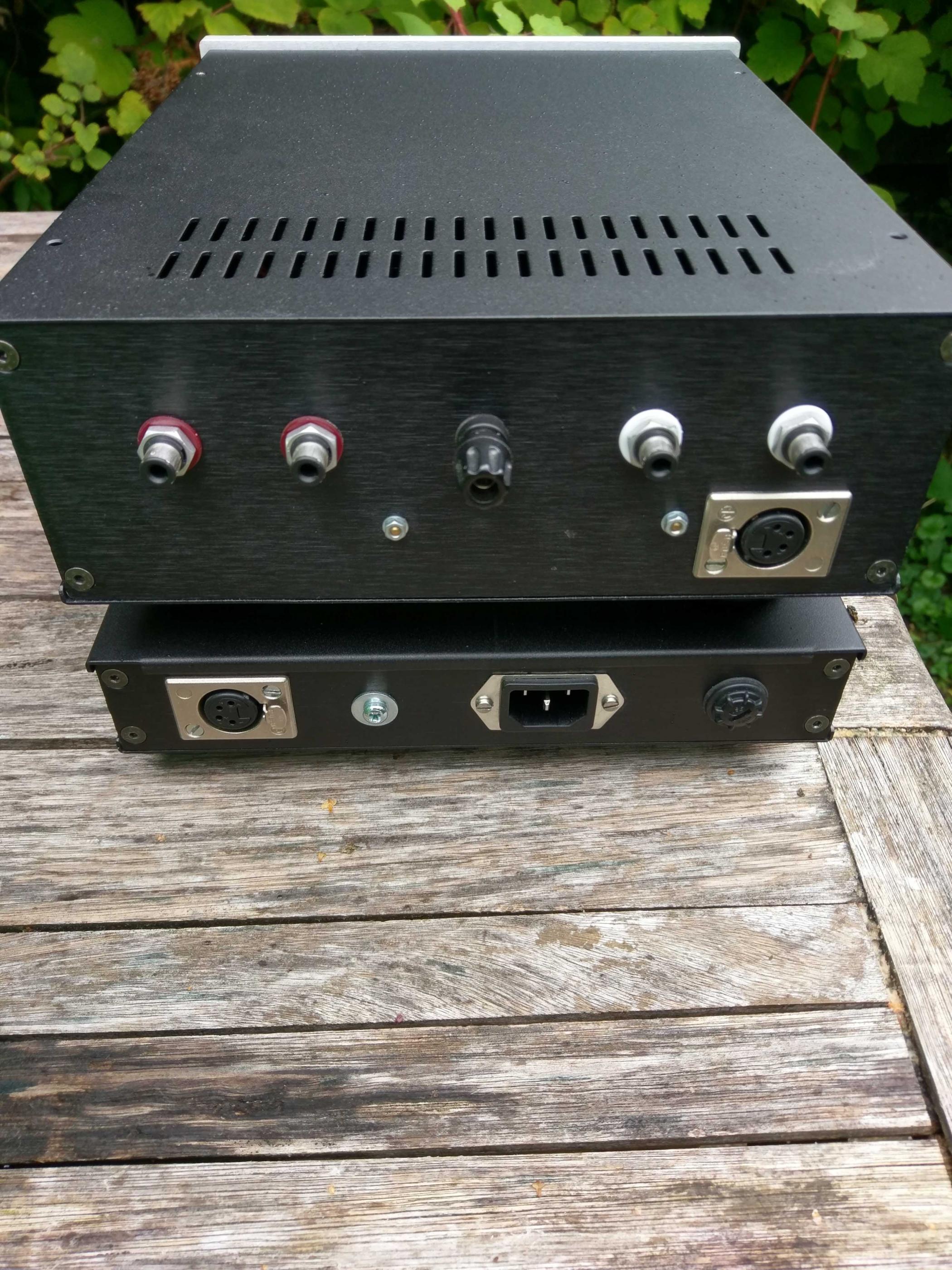

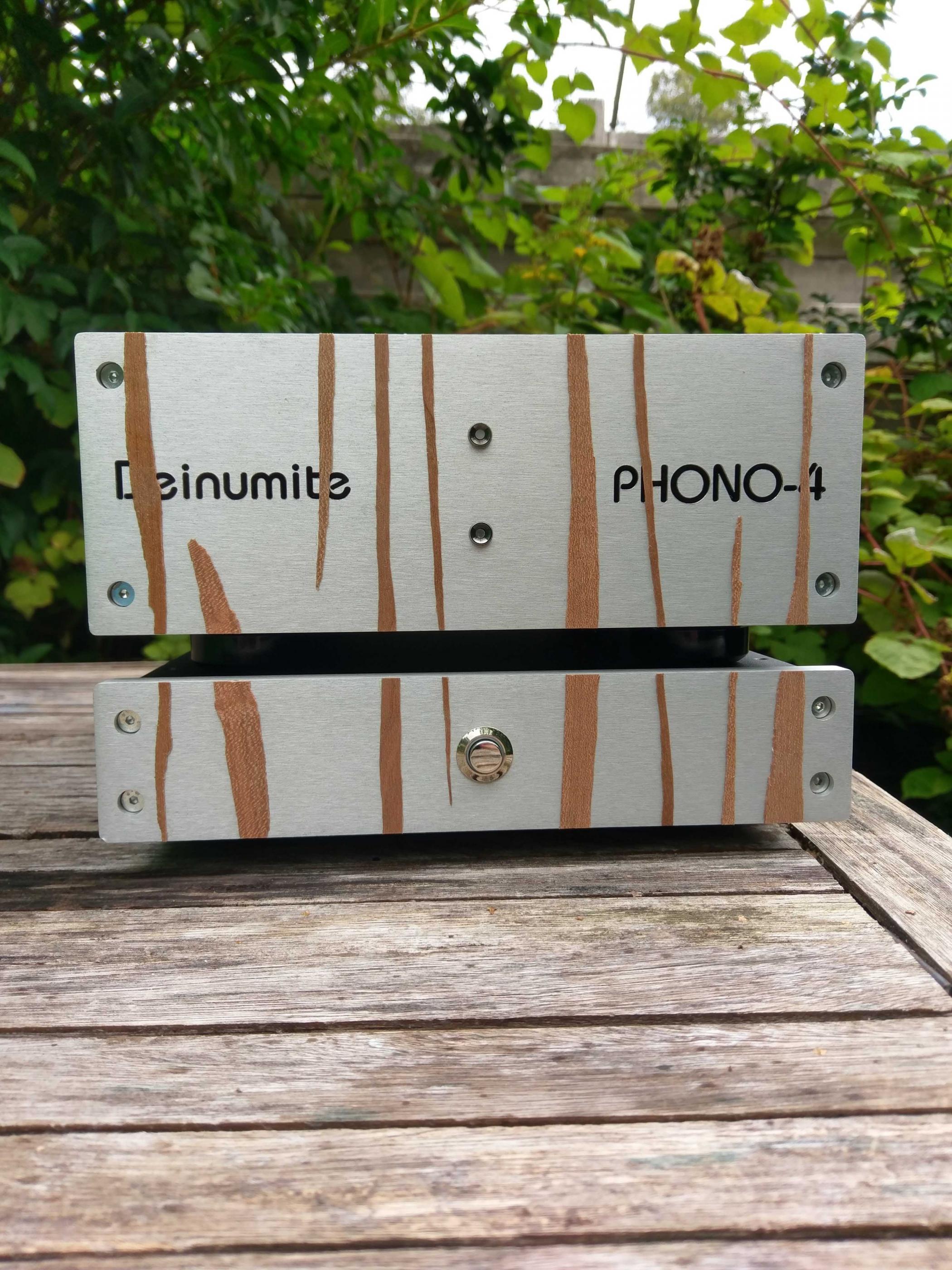

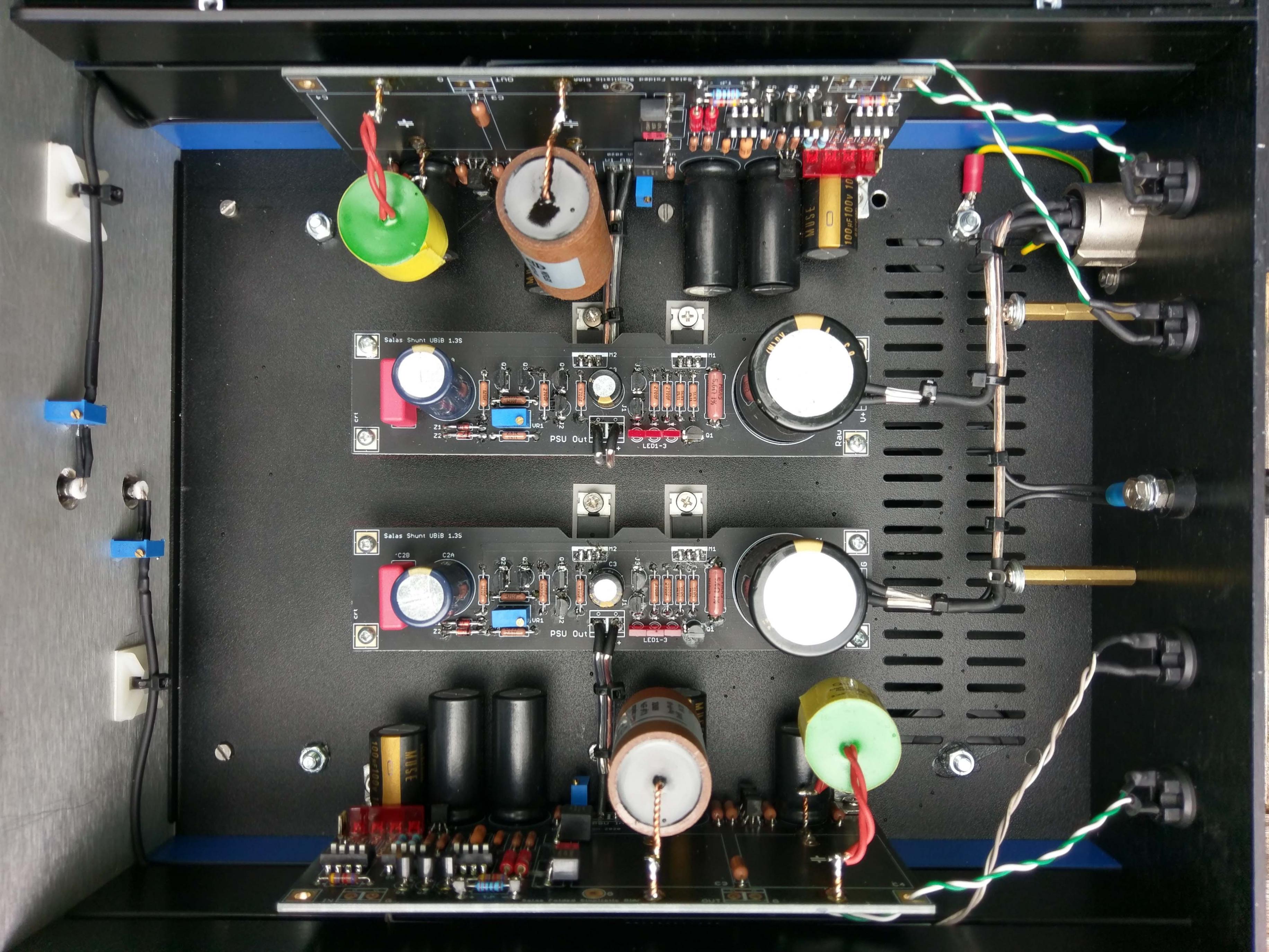

For now my Simplistic NJFET RIAA is finished, excellent sound and it stays no. 1😀
Salas & TeaBag, the magical duo.
finished the magical duo.
Woah, pretty!
What are the patterns on the fronts?
Very neat. Congrats! 😎
