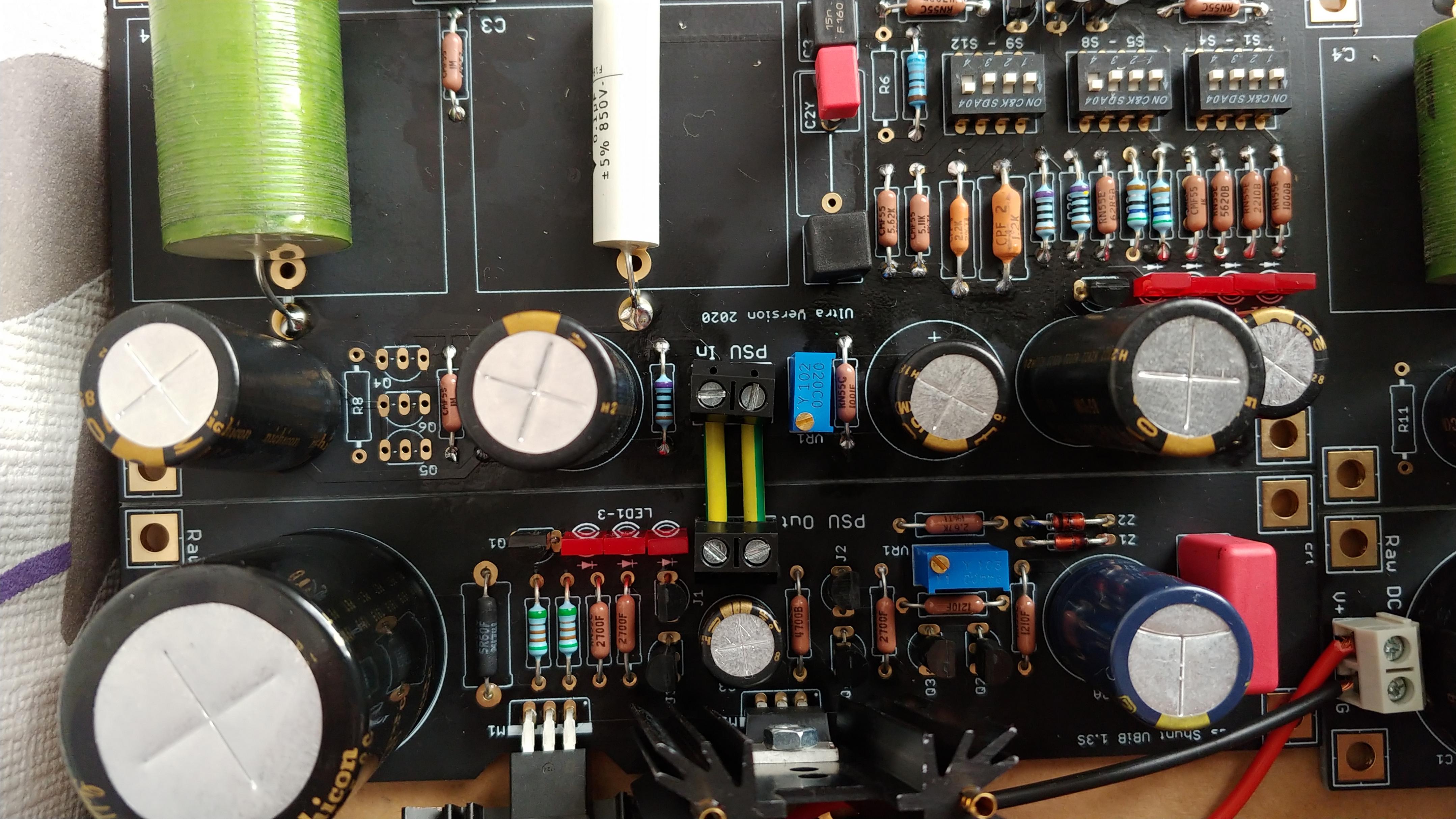

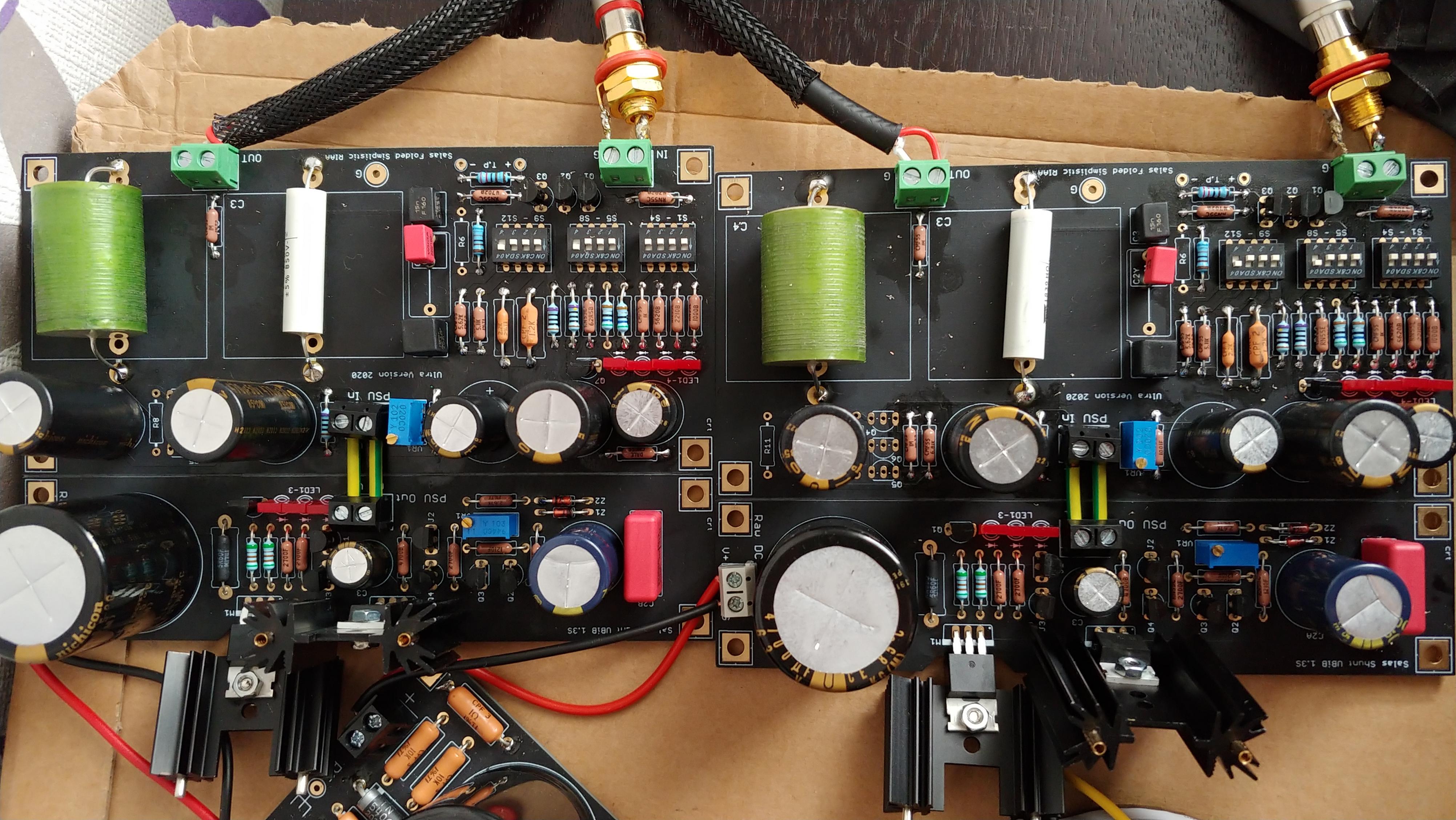

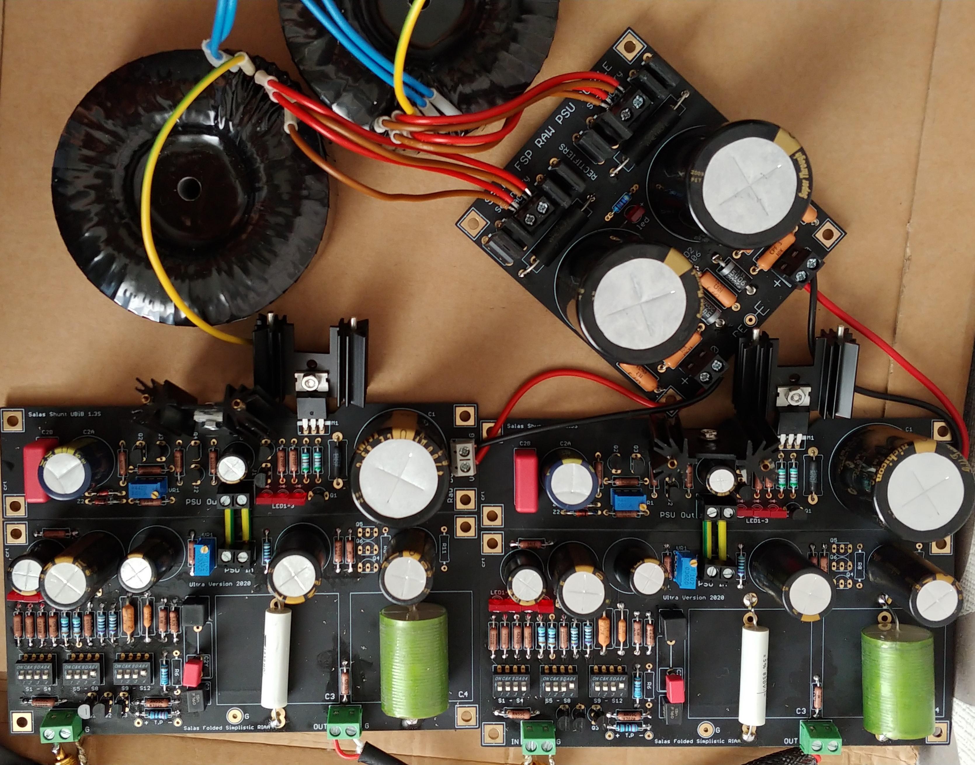

In UFSP you need everything installed, not only Q1 R2, but Q2 R3 too. Q2 alone actually does all modes other than LMC. So have it completed first.
Go down to 32V rail also and try again. MM mode usually demands less than 34V which is a general starting point.
If nothing changes, verify the switches are actually going on/off as expected by using the DMM's continuity buzzer on their pins across. On means a short. Do that with the power off. Verify the resistor values they connect to as well.
Thanks, better now. When I dialed down to 32V I got 4,23V on phono while it's pot was trimmed totally down. To get exactly 4V on phono, the UBiB had to be on 31.2V and another on 31.4V.
Is that OK to proceed?
Yes its within logical range for MM mode and OK to proceed. Remember, the other modes will likely ask for higher rail than that. When changing gain mode you set it up on the switches first with power off. Then you readjust T.P for that new mode.
Here are few photos. Not with best lighting, please let me know if need to try harder. 🙂
Thanks in advance!
