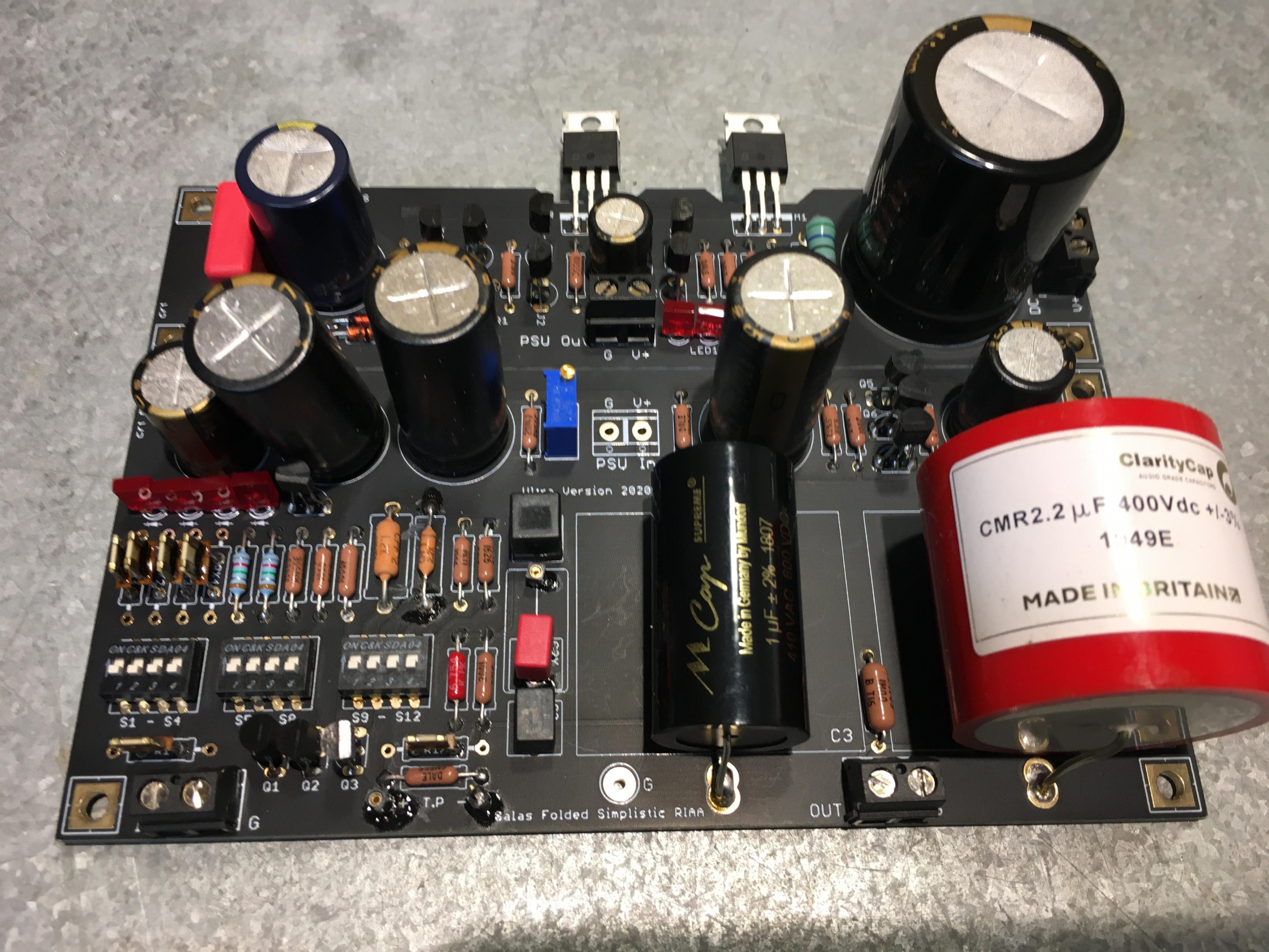

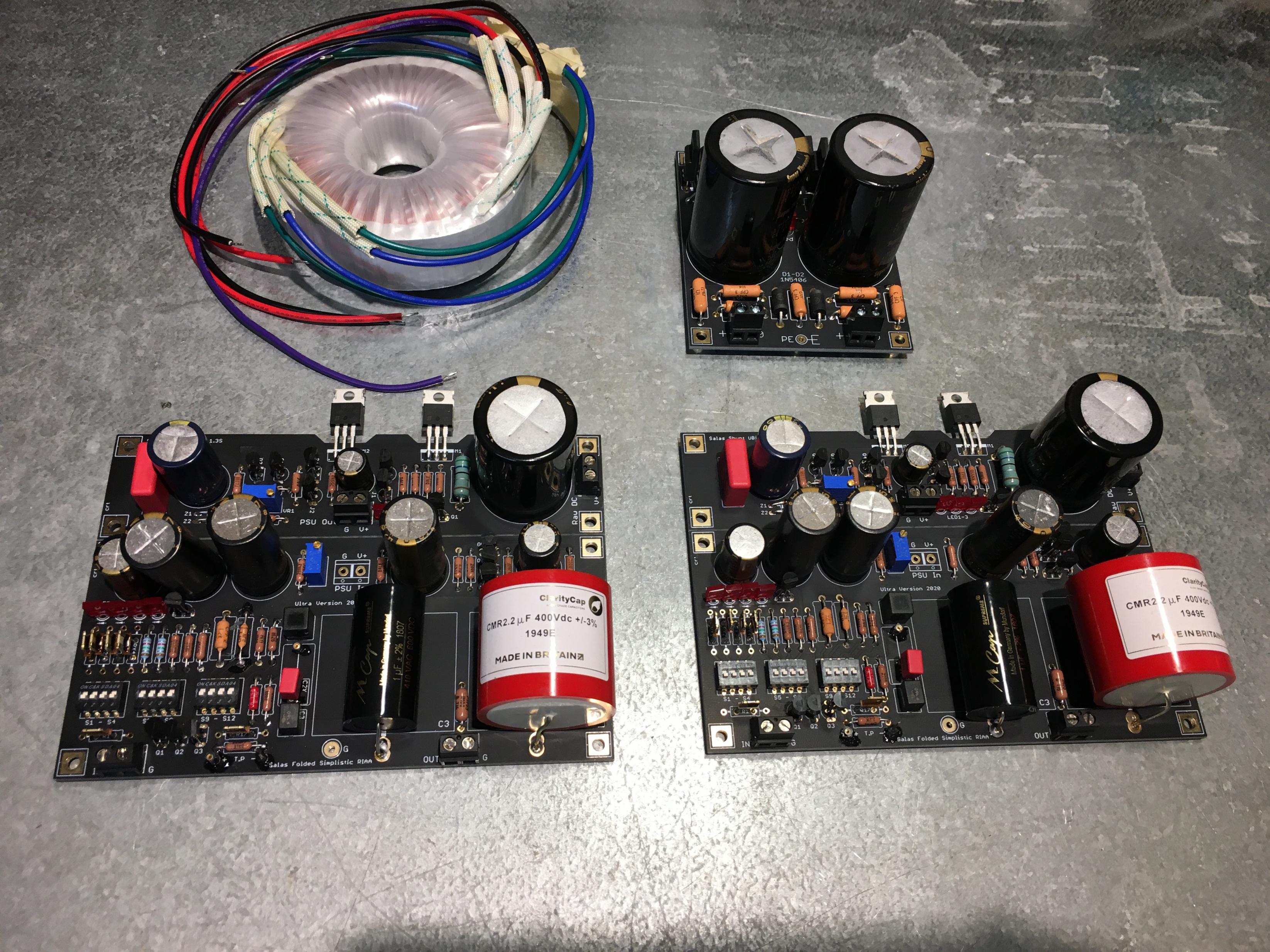

Finished populating the PCB's, tomorrow will test it and adjust TP to 4.0v for MC lo position.

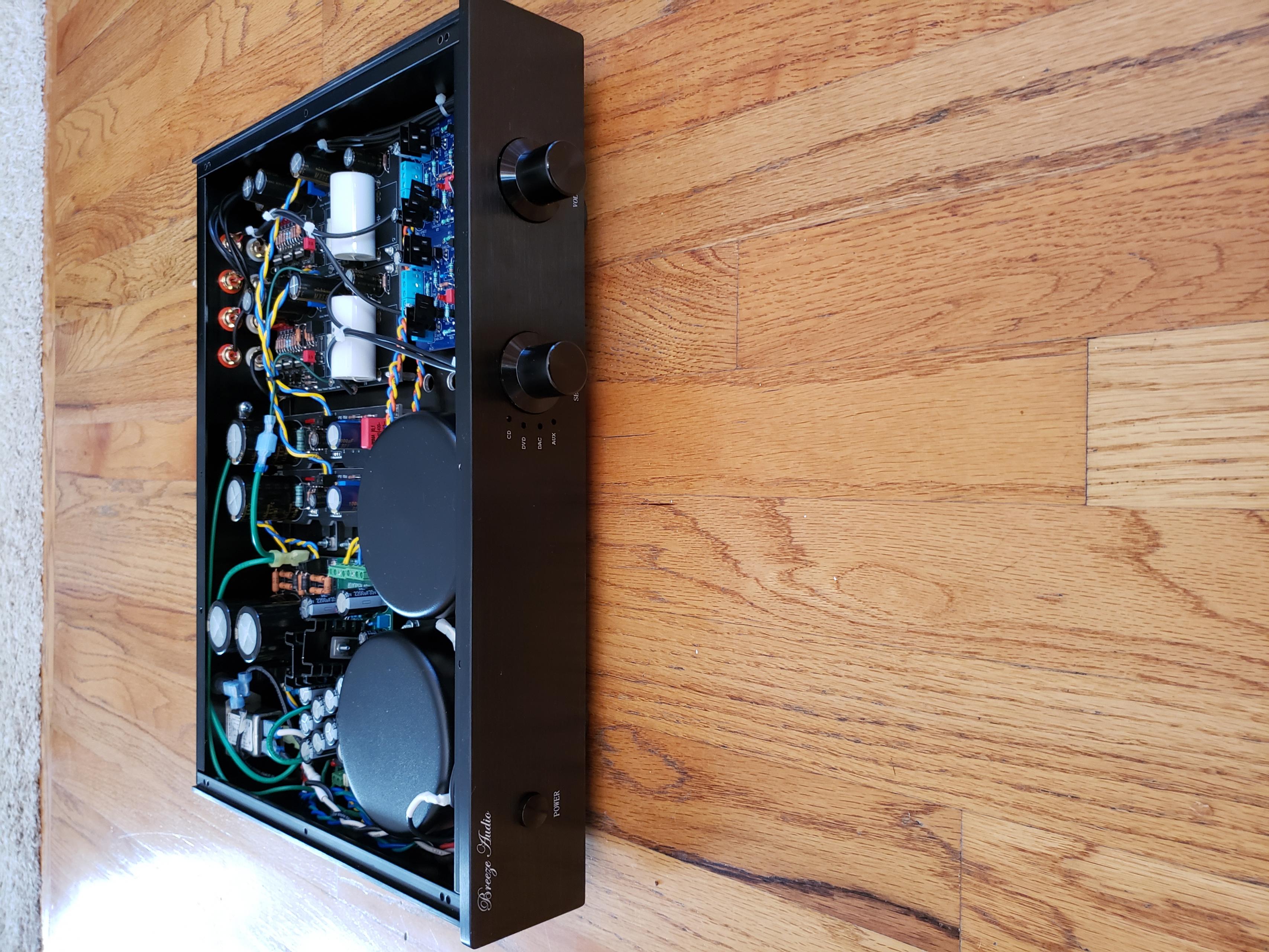

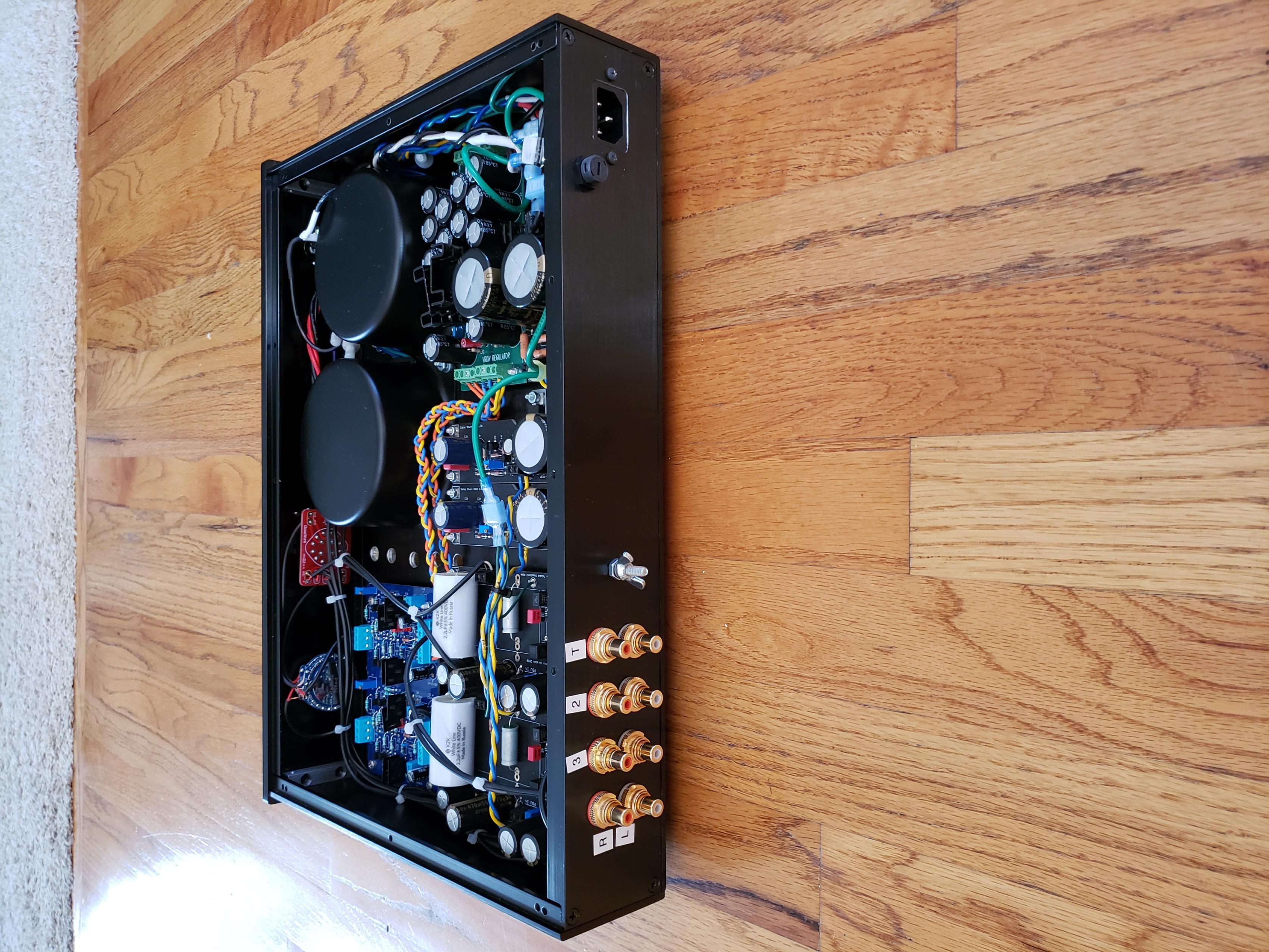

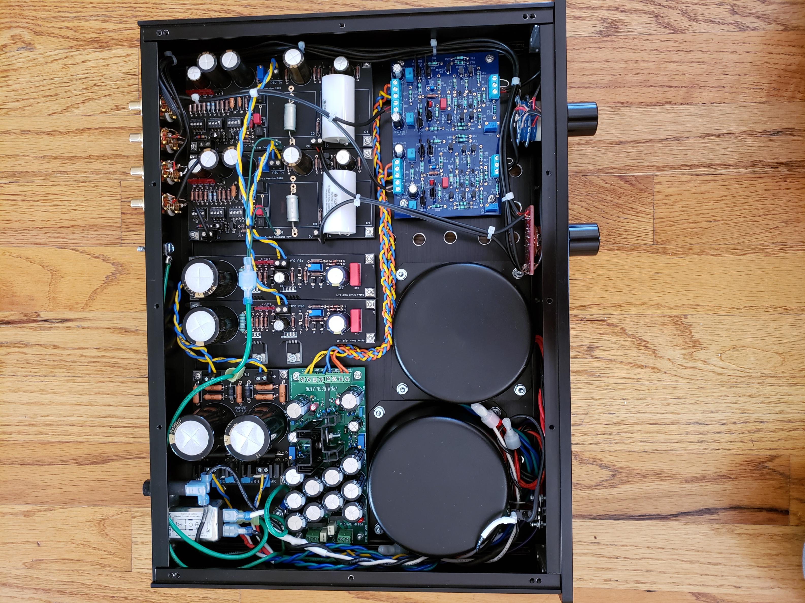

I finished my preamp, ULTRA FSP, Waynes 2018 linestage and power supplies all in same enclosure. I must say, my LP's have NEVER sounded better. The Ultra FSP is the BOMB!
I have a little hum coming from the speakers, my own fault being hard headed and putting the PS in the same enclosure. I've got parts ordered to fix that issue.
I also increase the gain on the linestage to 10, I'm going to decrease it to 6. Don't need as much gain as I thought.

First attempt
This configuration is surprisingly quite. I dialed 10X gain into the Waynes boards which is too much, I move the volume about 3-4 clicks and it's at normal listening level. When volume is turned all the way up you get some hum. No way I could ever listen to it that high. I'm going to move the A/C out of the enclosure and switch the external power supply on with DC to the switch in the preamp. I'm also going to dial the gain in the Waynes boards down to 6X gain.
The combo of Ultra USP and Waynes Linestage is AWESOME. Extremely quiet and very dynamic.

Looks well arranged and versatile as a full preamp. Nice that you like the combo's sound. Congratulations.
About gain, dial a line amount that reaches loud enough sound pressure level for your system and listening space/position at three o' clock volume pot setting from vinyl source. Re-evaluate background hum at full volume after that. Before you modify further. AC mains wiring and transformers in same box with phono signals is bound to couple some hum. Even when acceptably low in general it can also be highlighted by excessive line gain.
Joined 2014
I just received the power supply enclosure today and have made an umbilical cord to connect the two. I will incorporate both of your suggestions and move the A/C out of the preamp enclosure. Your raw PS and shunt regulators are made to have an umbilical cord with the large caps on the regulators.
I'm using a VRDN for the supply for the Wayne's linestage, I'll add a couple nice size caps in the preamp enclosure to make sure it has reserve. If I'm not wrong, it will also form a CRC filter with the wires in the umbilical cord having a little resistance. I'm using 20 gauge wires just for that purpose.
