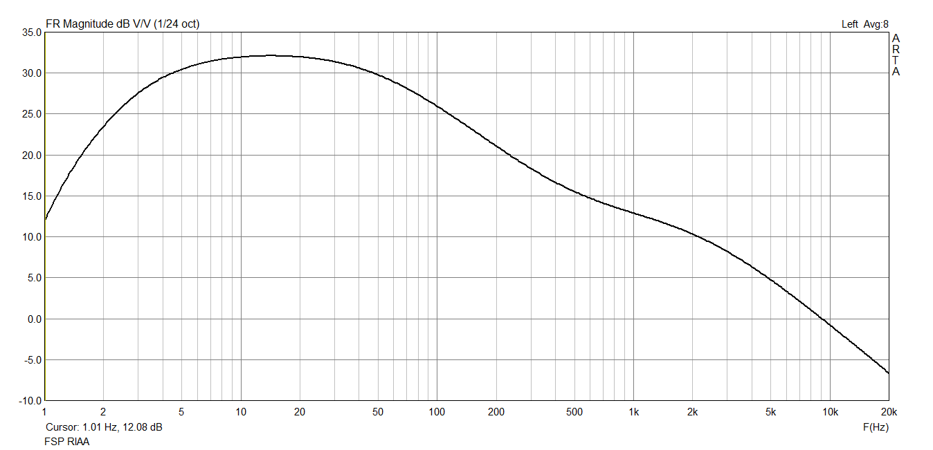

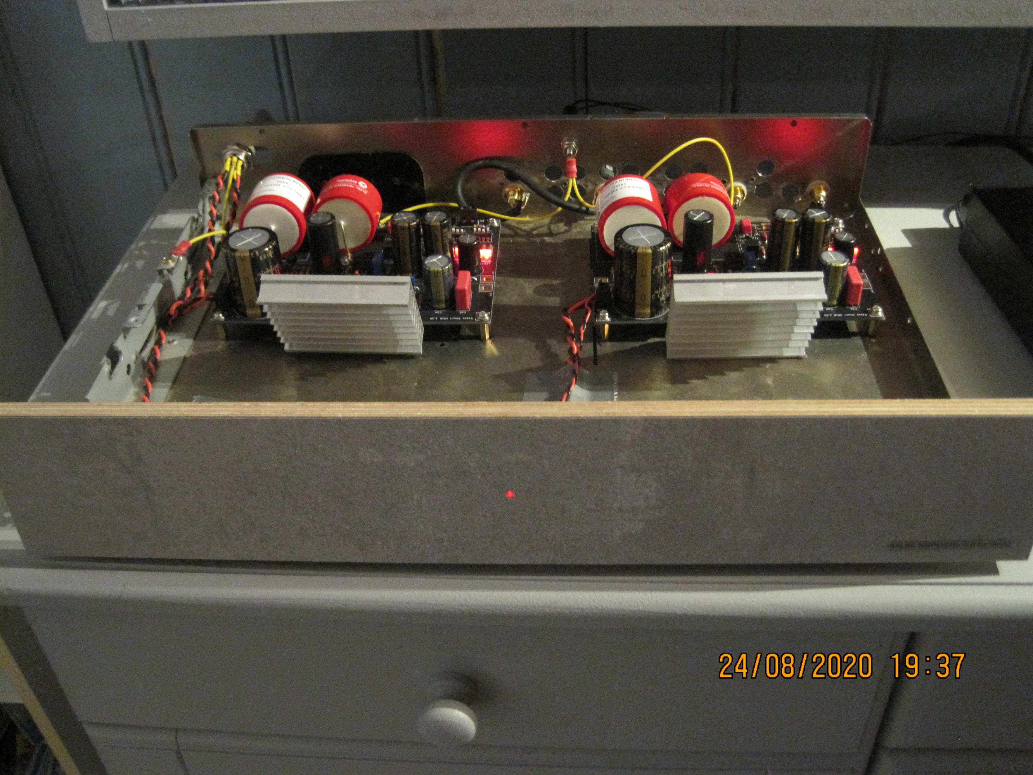

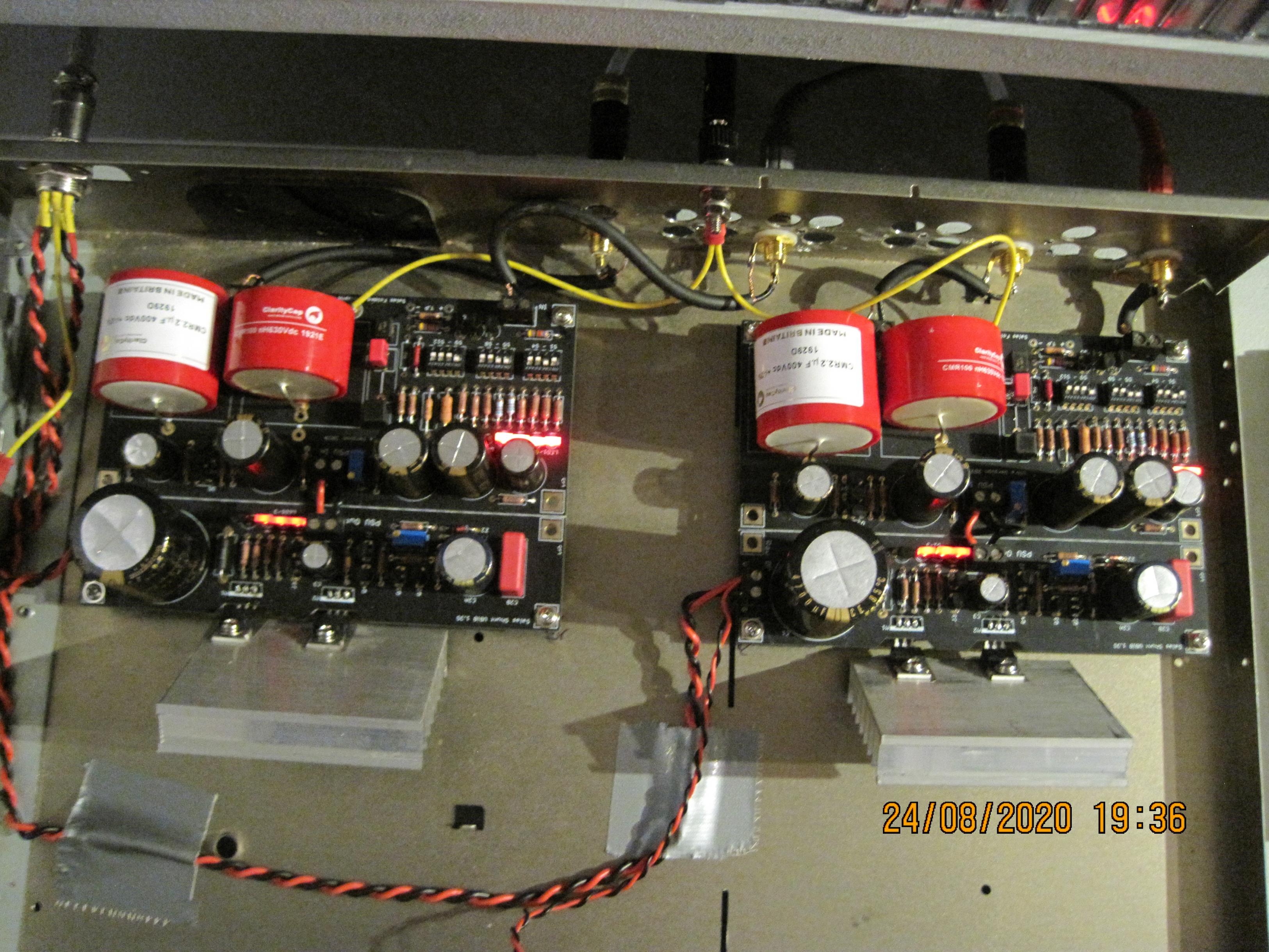

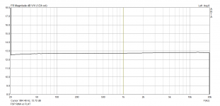

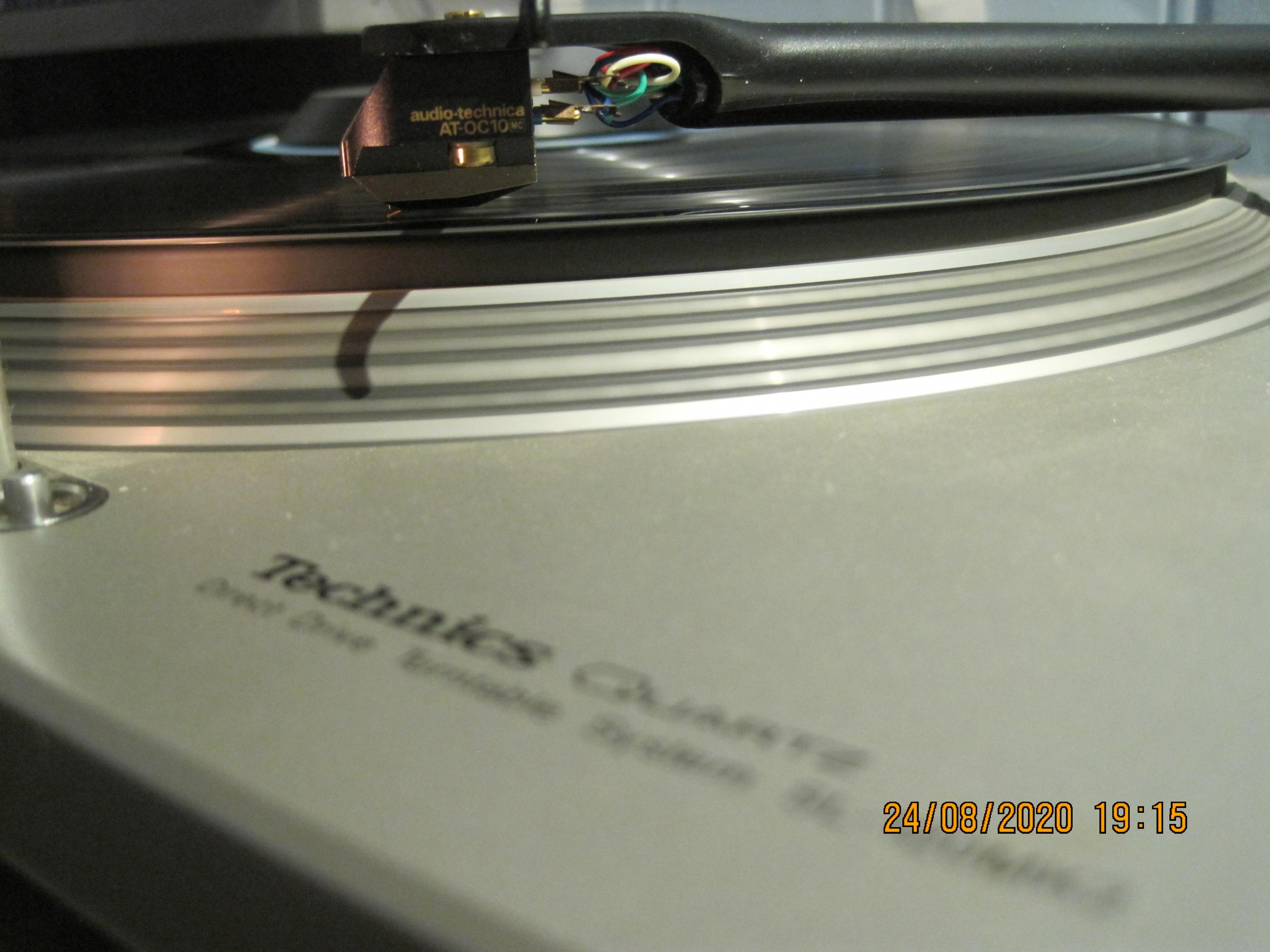

Thanks a lot to Salas and Tea for this build! My record collection is now shining as never before.
I have installed it preliminary in an old case, but this build deserves a new case.
some pic's:
The front panel has a concrete look. Same as my bathroom😀
My TT, cart and arm🙂
Had some hum problem on left channel on my RB300 arm. Had to modify the grounding of the arm with a separate ground wire. Now everything is silent.

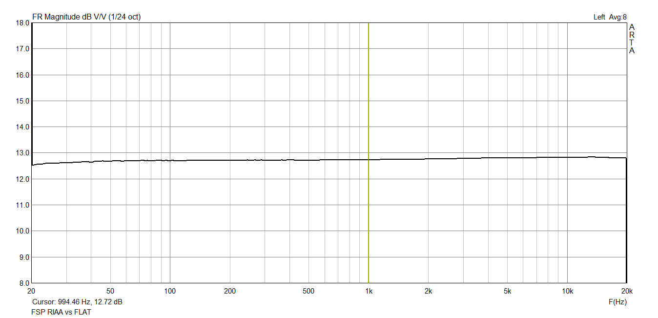

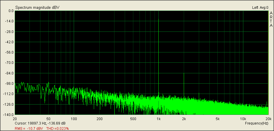

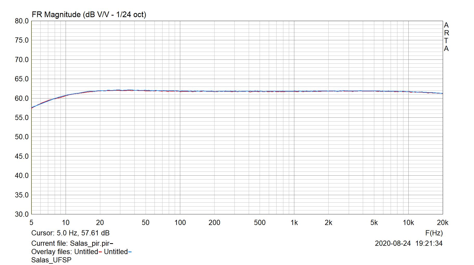

Tried to make an arta measurement with a RIAA FR correction.
almost 62dB Gain and channels seems quite close thanks to Tea's close matching.
best,
Paal
some pic's:
best,
Paal
Nice. Excellent match. Congratulations.
You could use the chassis floor instead of sinks in the new case. Is your Anti-Riaa 3.18uS "lost constant" type, thus the mild FR drop in last octave?
Or just 20Hz-20kHz numbers coming from a paper like TI's AN-346 app note?
Depends on the audio card too. Those numbers are elaborate, can't directly compare them to my numbers (fewer different spot frequencies derived from math) but they look near and they should be adequate. Try mine to see. What load resistor & C2Y you use with the AT-OC10?

Hehe, sharp eyes🙂 I bought the cart about 25 years ago (AT 30'th aniversary model. only used a few hours.)
I guess a new cart could do. I will try not to end up broke😉
Load resistor is 220R and C2=14,91 C2Y=220 at the moment. I will try other values later. Do you have any proposed values in mind?
