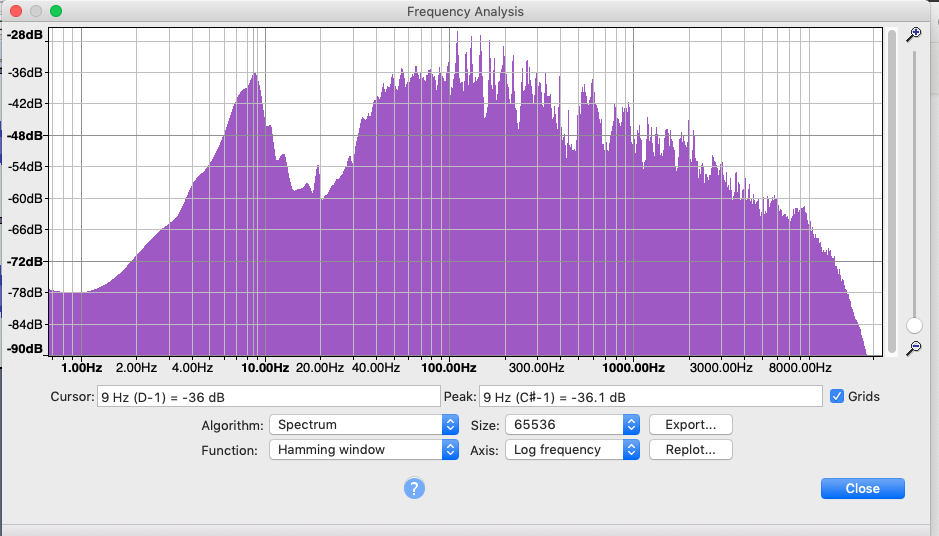

9 Hz is good. Indicates no problems with moving mass compatibility on your 1200 GR. But increase your VTF from 1.8g to 1.9g then to 2g and see if it takes more record warp into stride. The Benz Ruby 2 has 1.8-2.2g VTF span and you are on the light side. Leave it where it tracks and sounds best.

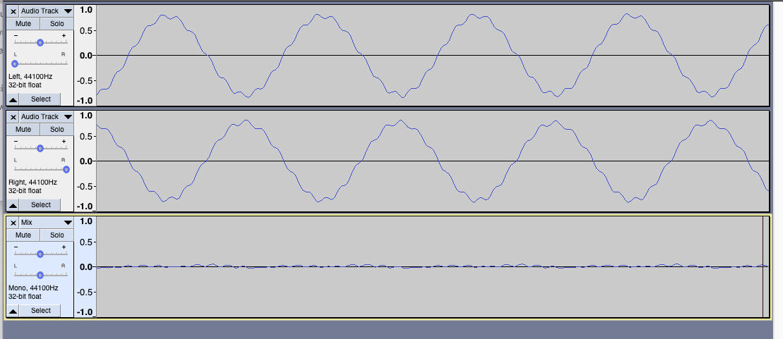

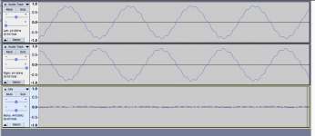

Good catch, I had forgot to go back and optimize VTF. I decided to do a bunch of tweaking this morning and ended up at 1.9g, reduced the anti-skate to 1, raised the VTA by 1mm at the pivot, made some very small (tenths of a degree) azimuth adjustments and switched to 560 ohm cartridge loading. I used a two-tone (400 Hz and 4K at -12dB) test track at 14.3 cm/sec on the Shure TTR-102 and captured it in Audacity. The idea was to get to equal looking waveforms which I think should indicate the best tracking, I could see subtle waveform variations as I changed things. The sound is terrific, it's like things snapped into critical focus. The attachment shows one channel inverted and the mono sum on the bottom. In doing a FFT on the mono difference the 400Hz signal is -36.9dB which seems to correlate with the cartridge channel seperation spec of >35dB so I think things are good but I'm still learning the on the Salas Ultra vinyl adventure. I'm very thankful for such a good guide!
I went back and looked closely at the resonance and it is closer to 8.5Hz, seems ok but I know it's probably a little low.
Well done. Now you know its optimally set. Sounds like it too. If the capturing card and software chain preserve enough musical fidelity of what you actually hear you may even share needle drop files of favorite recordings excerpts. Cloud type upload services abound.
Antiskating is not straightforward to perfectly set against VTF just on dial agreement, different stylus profiles slide differently in a modulated groove for one. I had a Dual CS 505 budget turntable in the early 80s. Its antiskating dial had a scale for elliptical and another scale for spherical. So I knew that already. And who knows about line contact or what other mechanical details may affect such micro forces when between different carts and arms combinations.

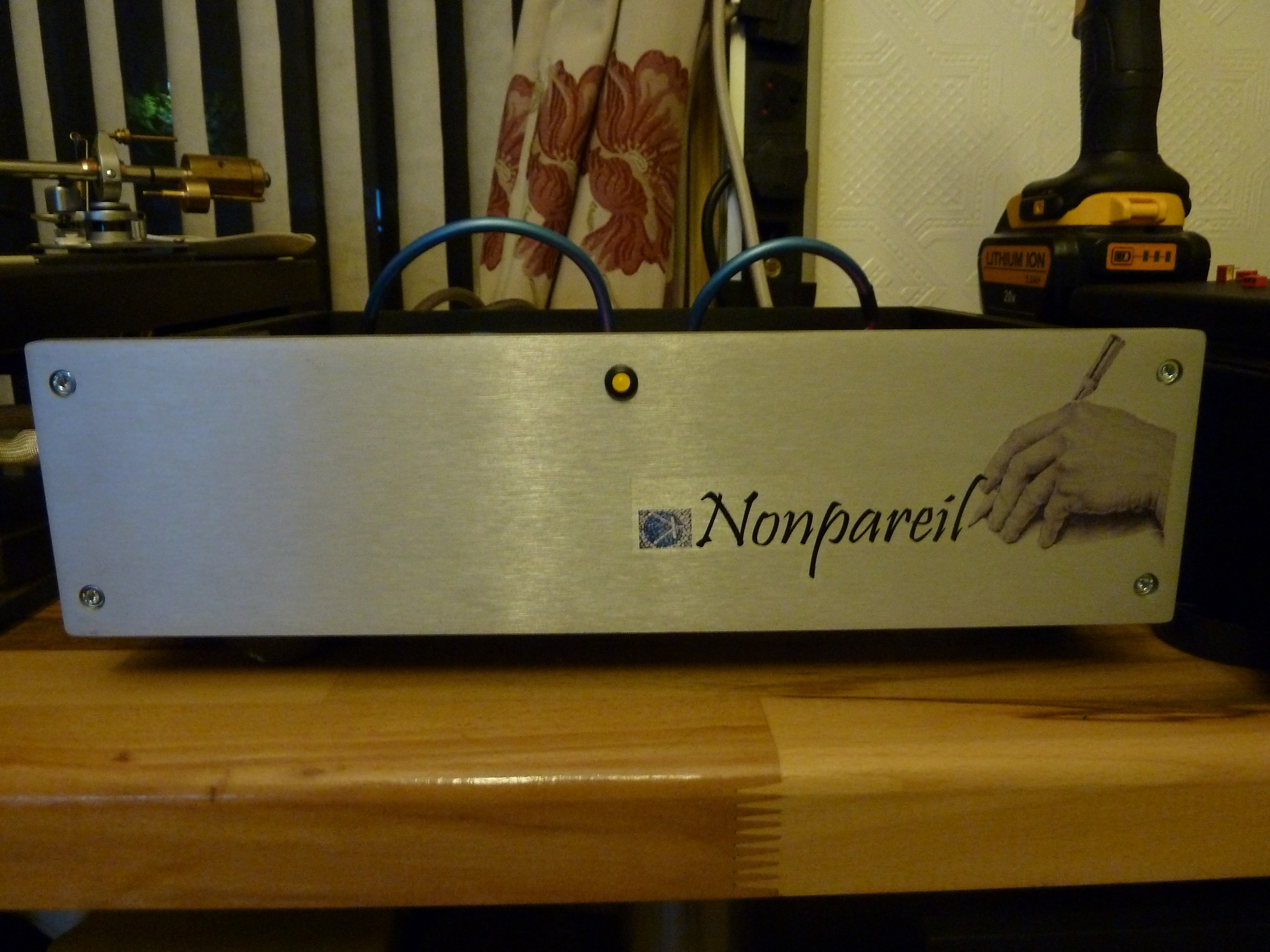

Congratulations!

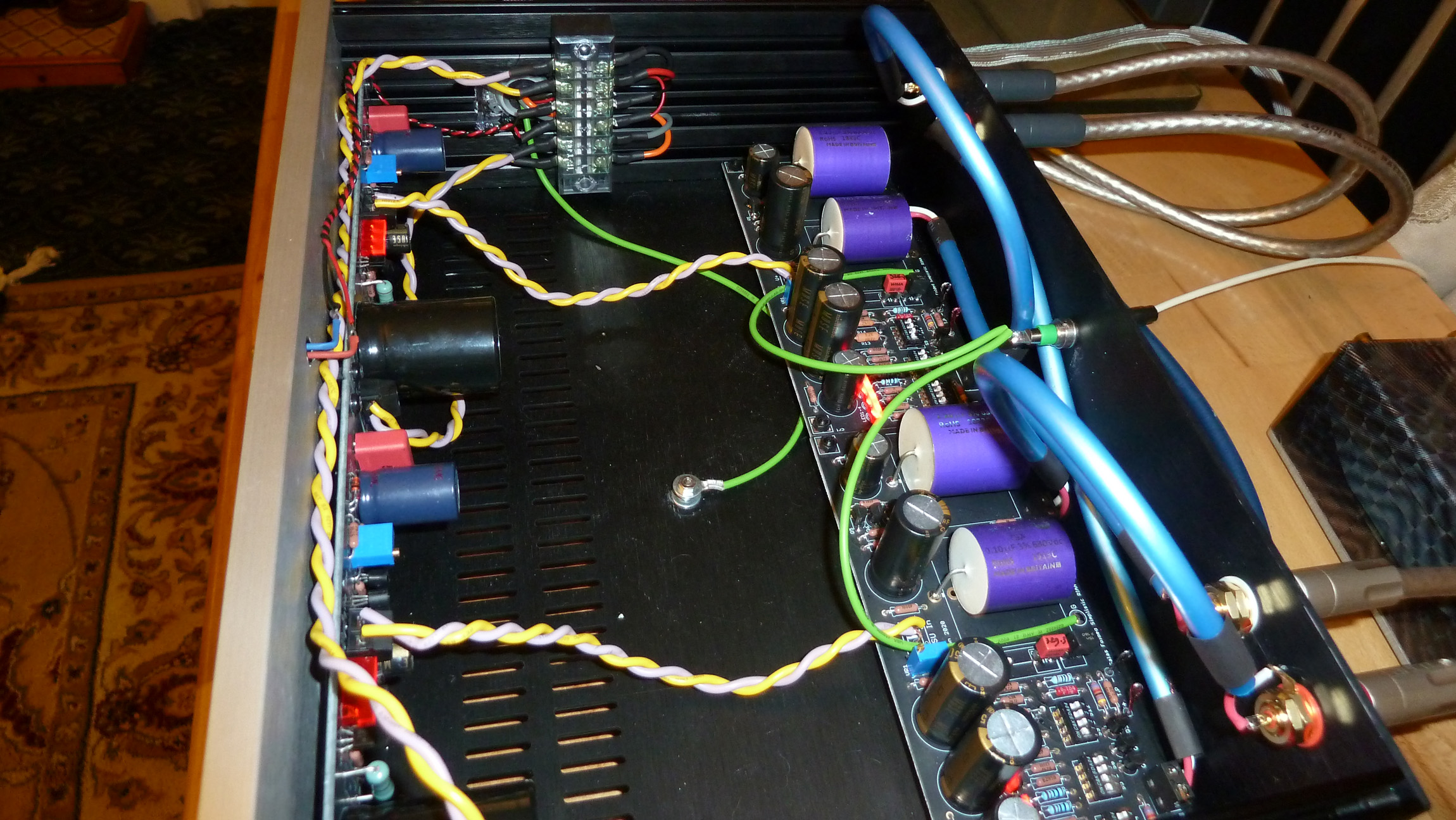

The build looks nicely arranged with the shunt PSUs against the thick front plate.
