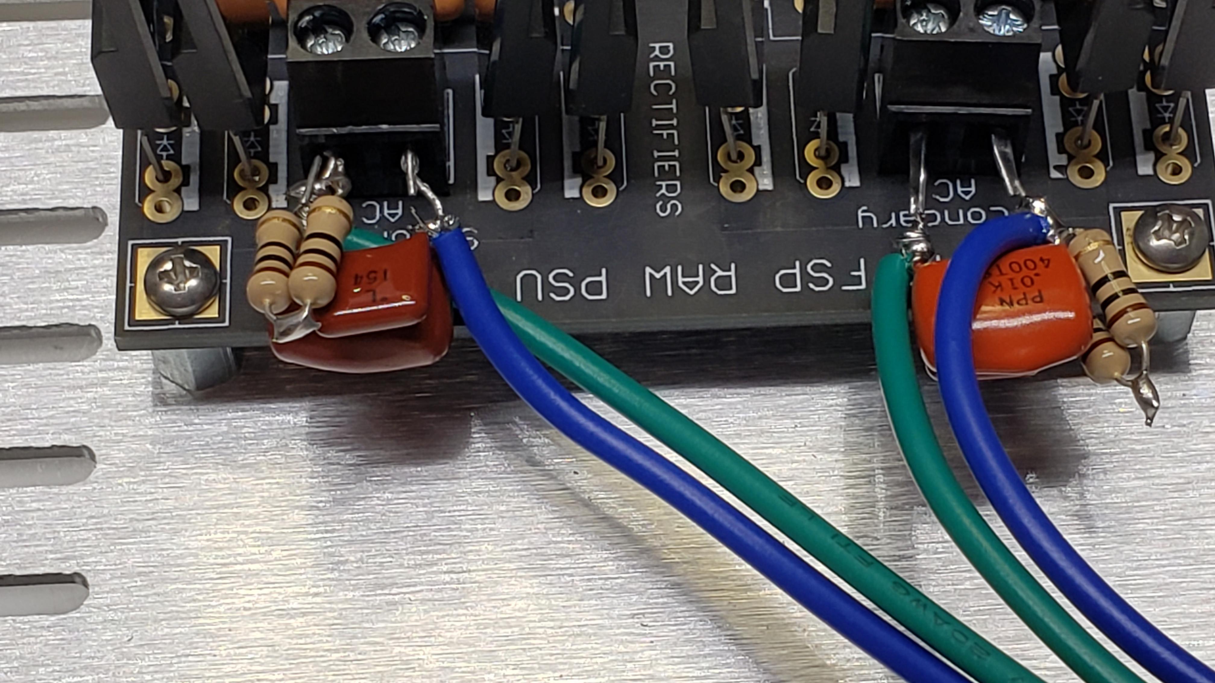

Do post in the Quasi thread or where appropriate any impressions about snubbed vs. non-snubbed amps. I skipped the no-snubber step—got too inspired... Kinda curious about audible differences... I'm gonna attempt to see if I can get some measurements on the snubbed and canned RAW PSU I made for Ultra.

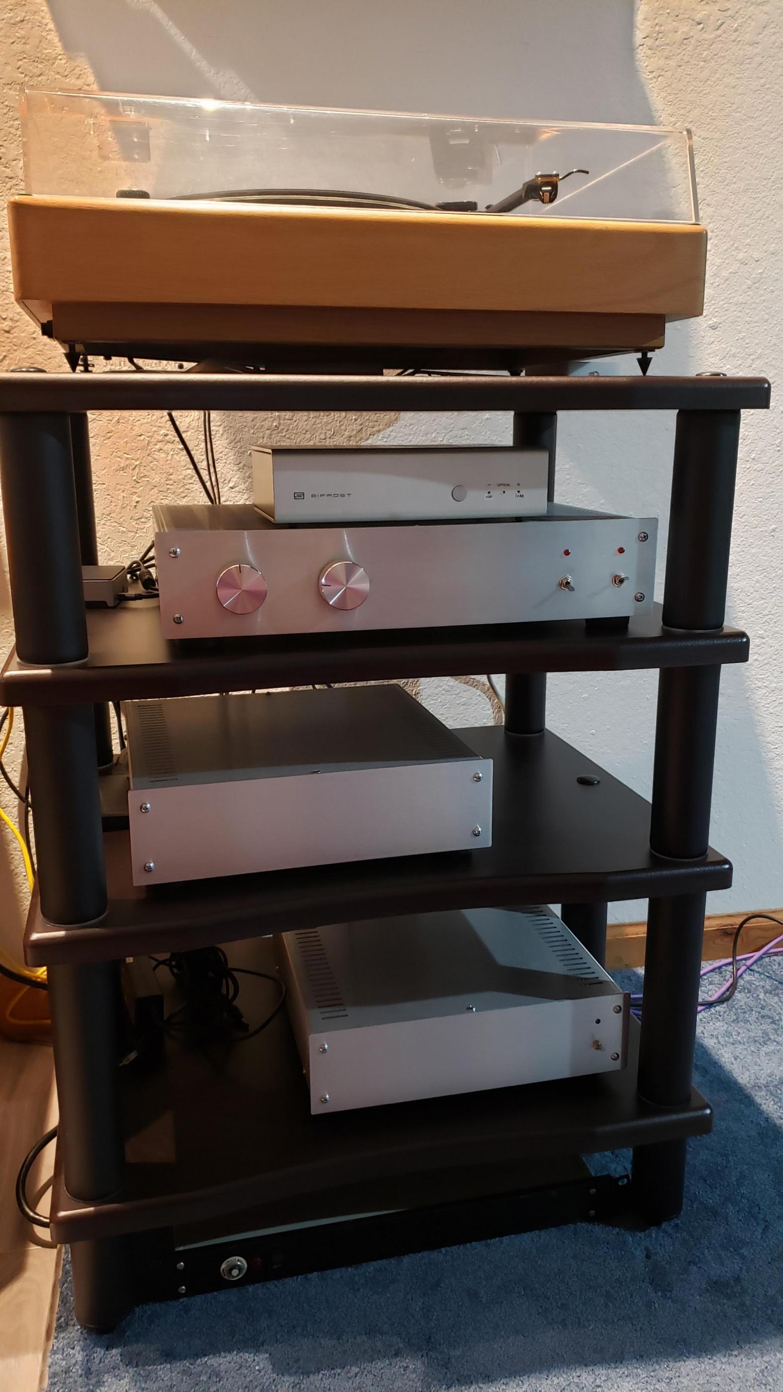

I might recommended keeping those nice matching cases far apart from each other. :yes: Curious about with and without snubbers too, did you try?
Salas—I finally got around to playing with ground lug isolation, or not. Uh. Didn't notice it before—because it's much less apparent at low volumes, but last night I deleted the isolation on TT ground, ie—TT ground now connected to chassis...and WOW—HUGE difference when the volume is pegged. Massively more quiet in my case. YES! Which is how I did FSP (TT ground connected to chassis) in the first place... so... good learning here. What I haven't tried is connecting ground all the way to PSU.

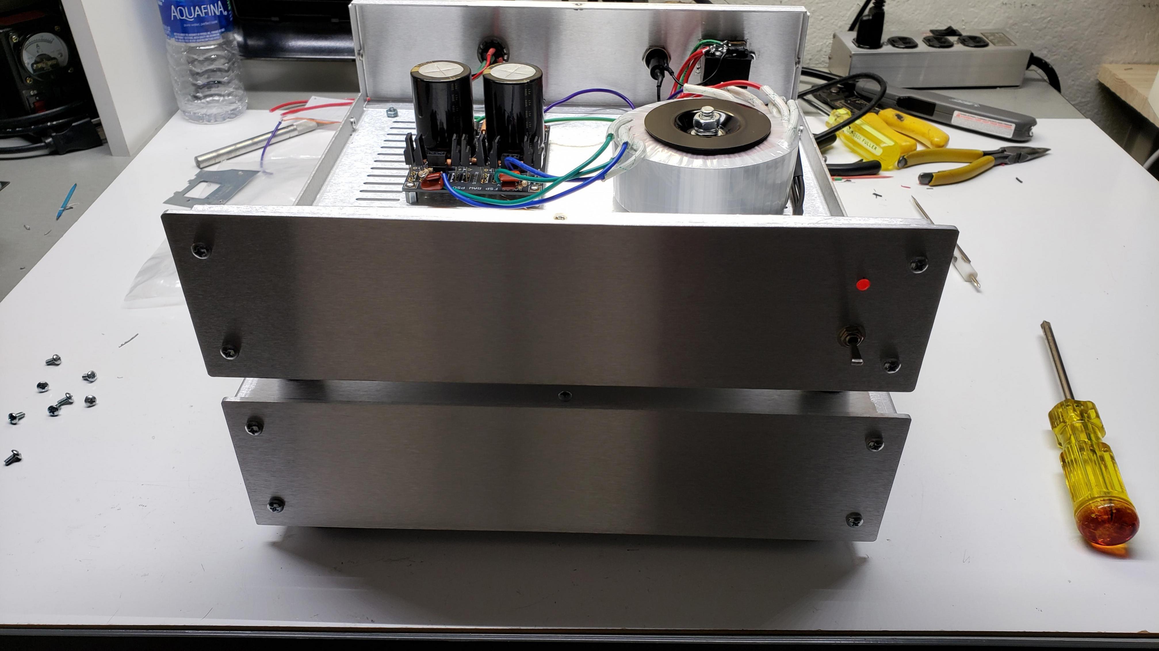

The two chassis are on different shelves. The turntable is on the top of the equipment stand. Next shelf down is the DCG3 and my Rasberry pie music server feeding a Bifrost DAC, followed by the phono preamp, then on the bottom shelf is the power supply. On the floor is the power strip. All is quiet. I did not notice any difference with the snubbers. But I have not listened for any length of time.
