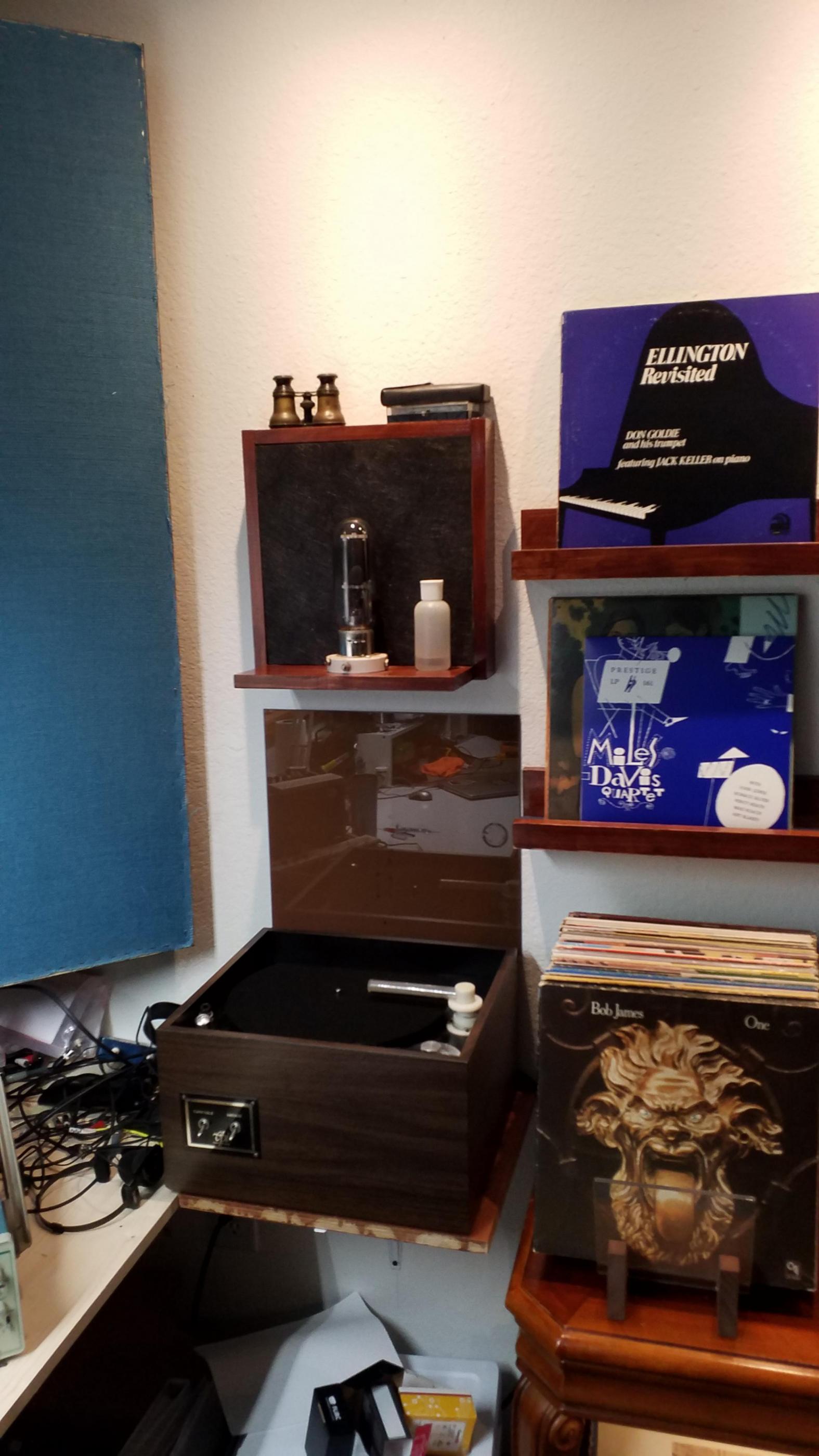

I like the display of big tubes on the wall, are these RF transmitter tubes?
The monster tube is a Cwl-851 aka VT-41 . I lit it up once, way too much heat ( 11 volts 15.5 amps ). All the tubes on the wall are radio transmitter tubes. The black material behind the tubes are sound absorbers and the the tubes themselves are for diffusion. Nice too look at and yet somewhat functional. The attached picture is of a 838 transmitter tube.

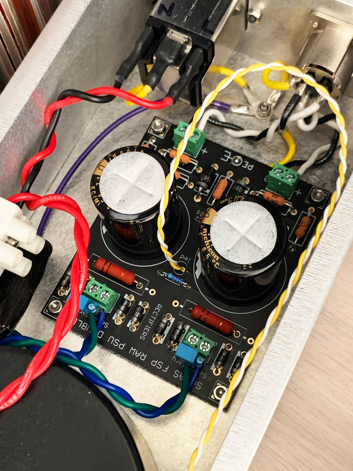

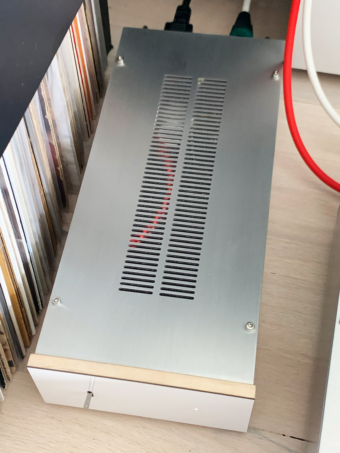

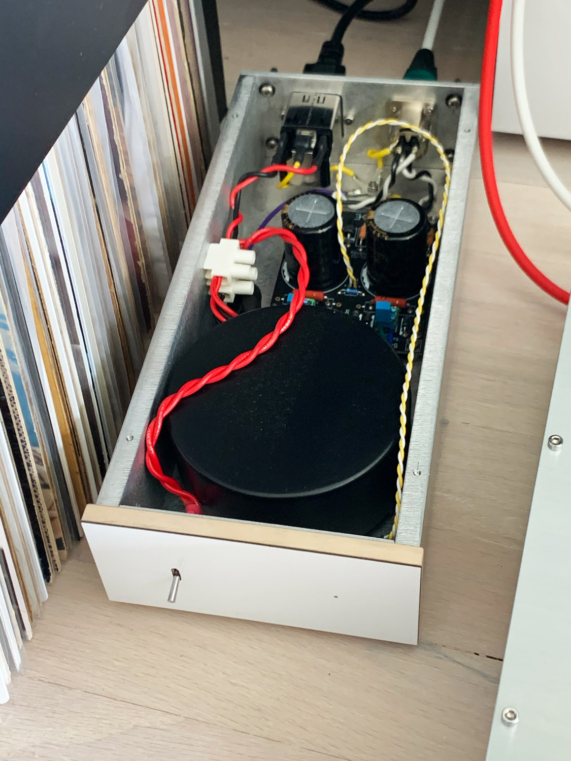

RAW PSU!
Completed the dedicated RAW PSU for Ultra. Now I can run it concurrent with FSP.
With new PSU I observed that 1. the system seemed even quieter than previous with my FSP PSU on Ultra (Was already superbly quiet, so this is almost more of an instinct, but there it is), 2. T.P didn't float around as much, if at all—very stable as far as meter would tell. Coincidence? Or can this be attributable to PSU changes? I threw a shielded can in there because—why not? And there are 6 toroids and 2 autoformers inside a 2 foot radius of the amps etc... no idea. I have a minimum of 4' distance between Ultra and PSU.

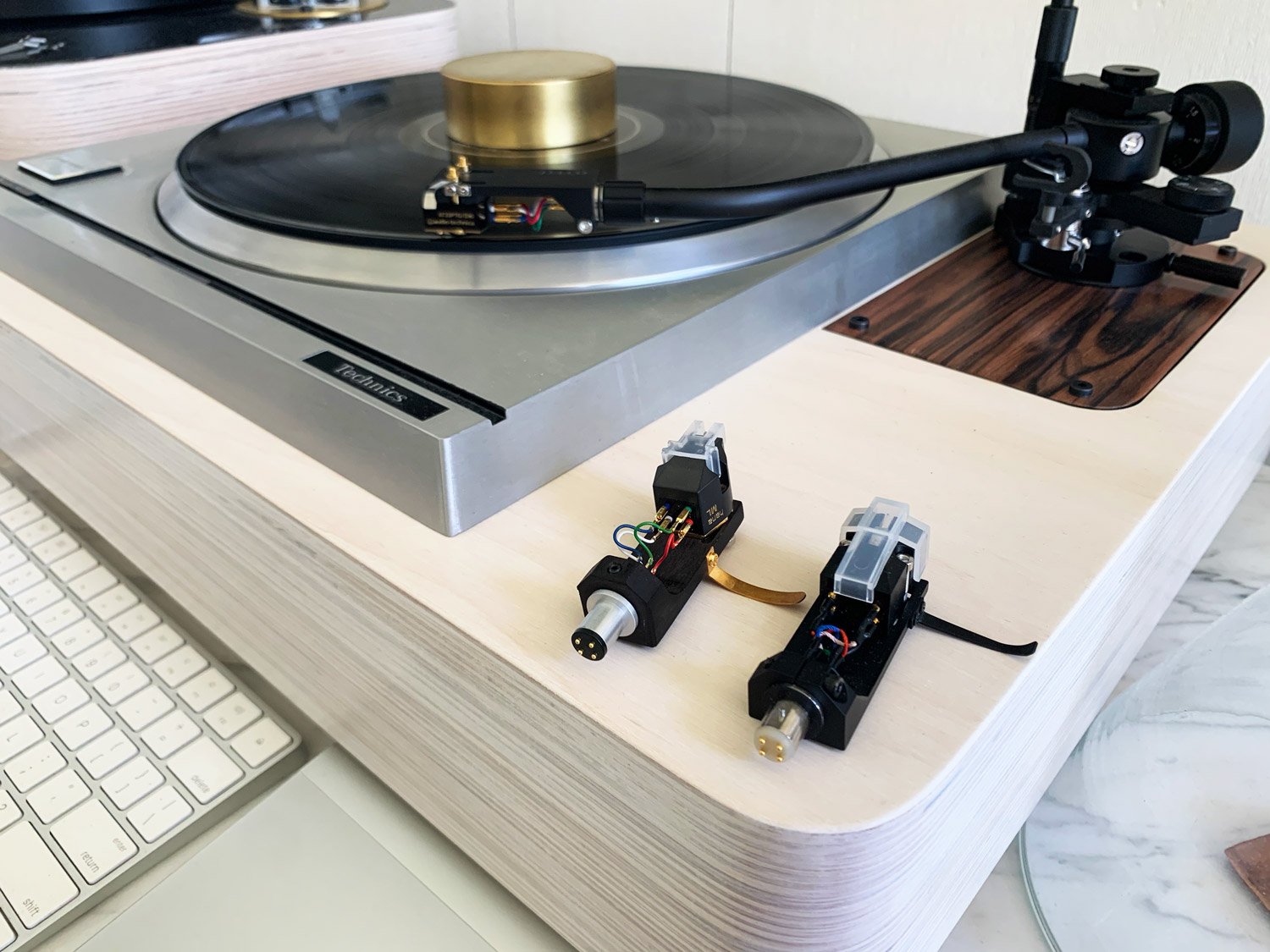

The AT33PTG/II is in fact sweet. Thank you Salas. You have succeeded in making me move up the project list a new plinth for two arms!! The HanaML seems "bigger" in room presence and more full in the mids. BUT—I need and want to give the AT some time in the system... 220R loading. It's lovely—very "clear" sounding out of the box. Can't wait to put the Denon 103 back in after getting a good sense of all three. WAY way too much fun. Thinking I will be socketing the 560R spot. I don't see why all builders shouldn't socket one of the loading positions from the start.

Raw PSU does not play a direct role for T.P. Temperature change in the main box affects.
The AT has boron cantilever while the Hana has aluminum so expect different presentation than the Hana no matter if both have line contact styli. The AT prefers a neutral VTA in my experience and a few days of play to open up.
Yes!! So perhaps T.P was super stable since I let it all warm up for a bit before tweaking and holding my breath. Hana seems to benefit from neutral VTA as well—to my ears. Two arms is the "solution" for these two carts, Ha!
