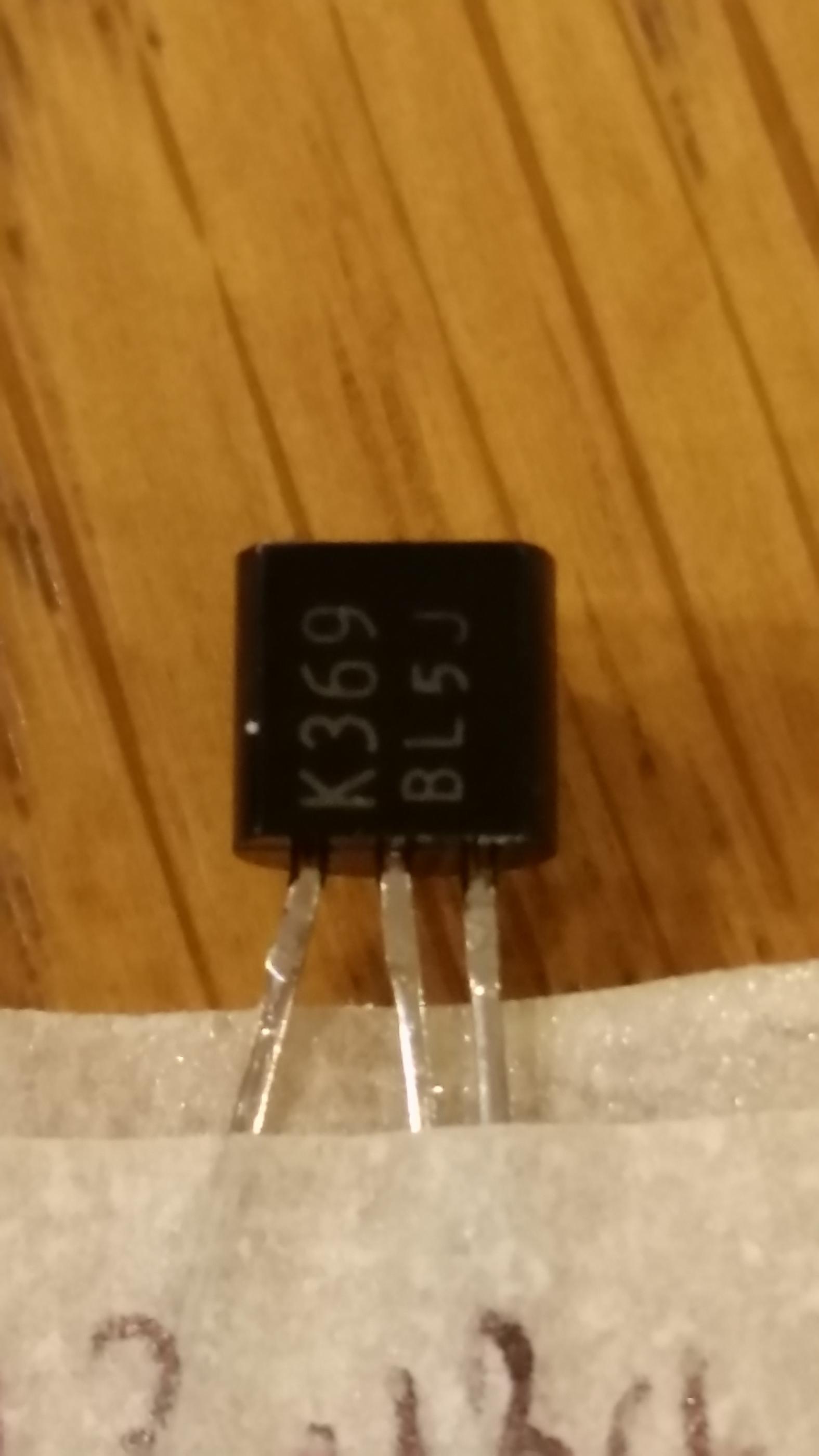

The specs for the two installed 170s are out of whack. I had only one useful spare 170 and my goal was just to get the board to work, figuring I'd straighten it out later. As noted, I asked Tea to supply three matched pairs (or at least two) for q 4, 5, and maybe 6. I'll probably replace the 170s on both boards.

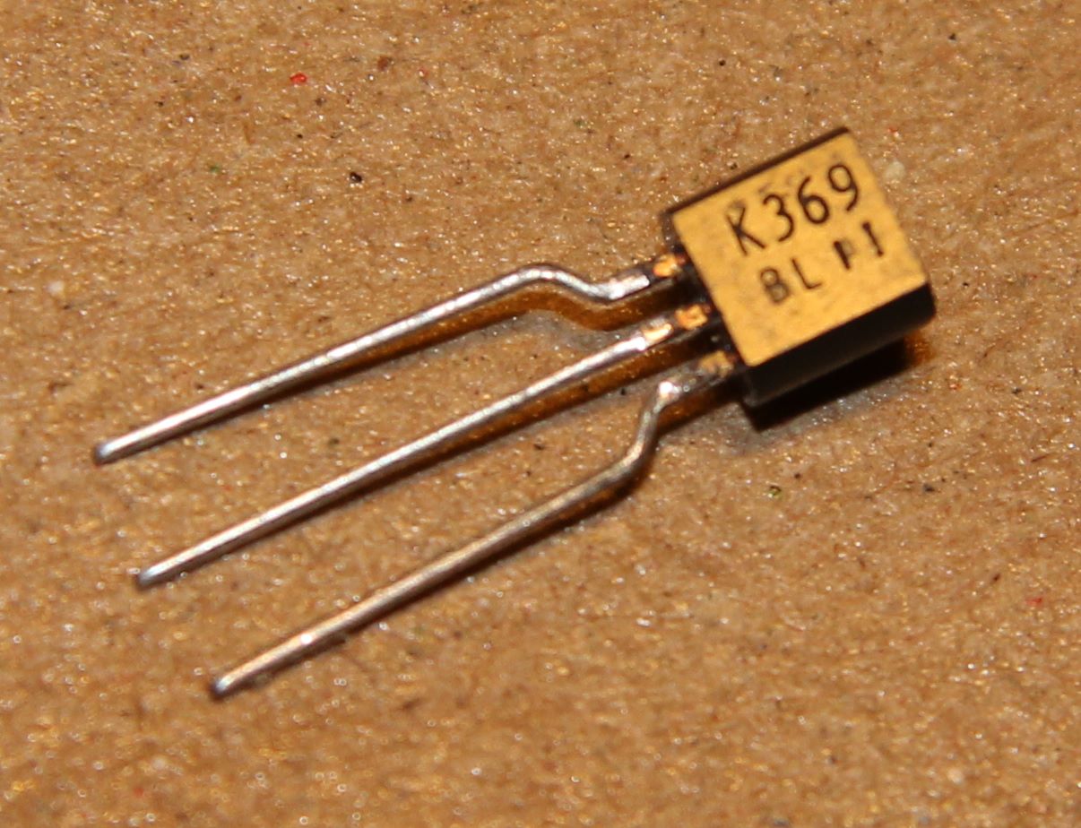

They could be alright. Fix your rail range and run the build first to see what happens. You may need the wider range with other samples too. There are other factors also that weigh in the bias like the LEDS etc. You could also post a close up pic of those JFETs so we may say if they look the deal at least.

Here is a photo of the K369.

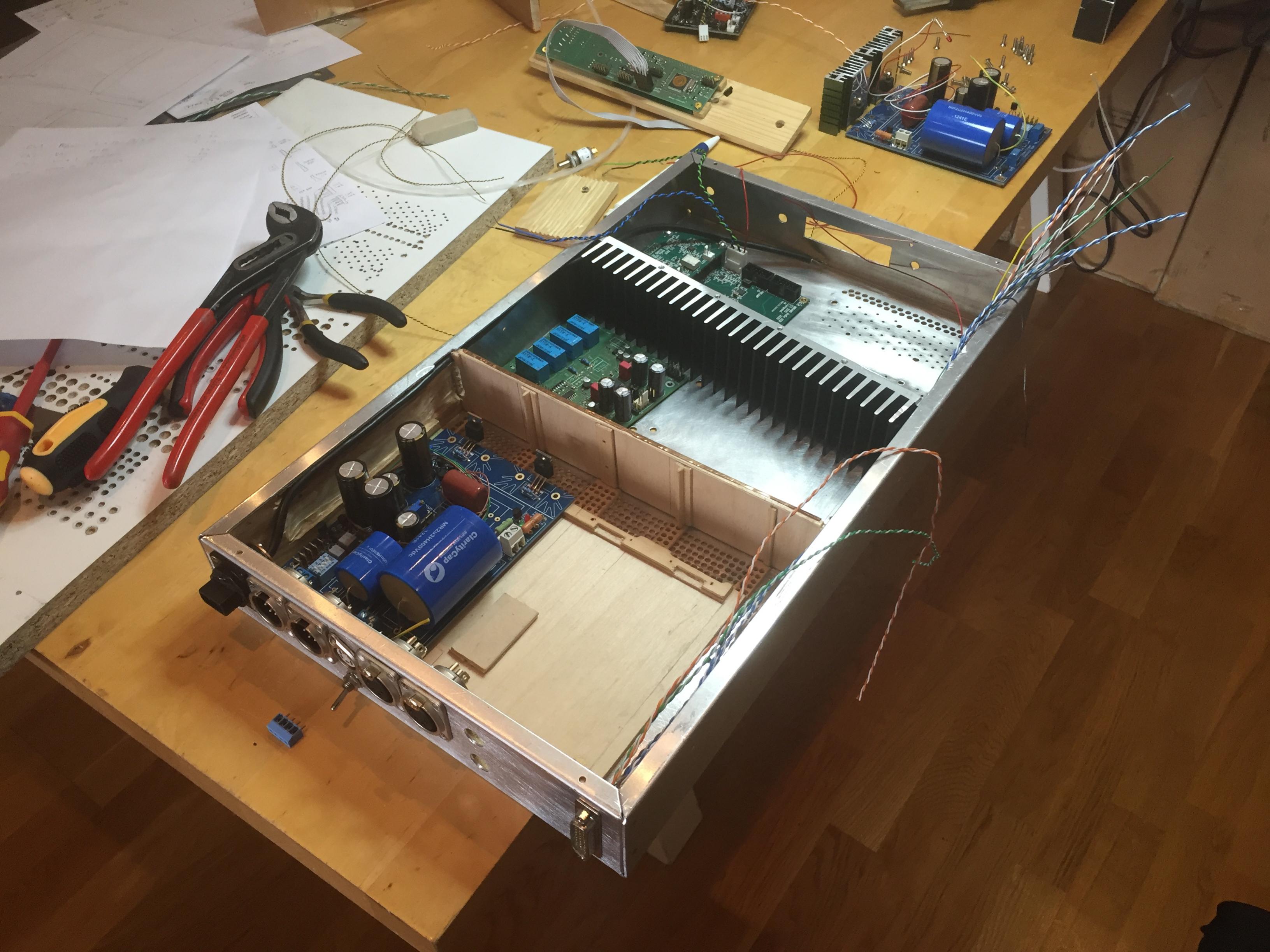

A little higher, 2 inch not 1,75. It will host FSP, USB DAC with SSLV pre reg, Muses electronic volume control, FSP+DAC+2 analog linelevel input select, 3 way output select from a DCB1 and maybe some more. Pondering about selectable hotrod in 3 steps.
Many things, much work, but one stop box in the end. Will save many interconnects and rack space.
