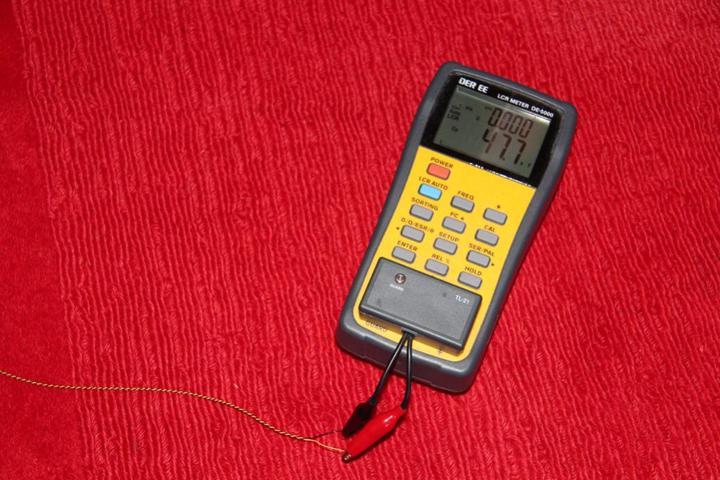

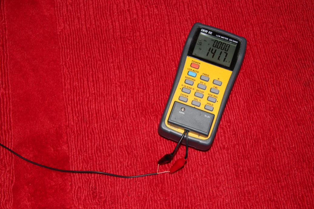

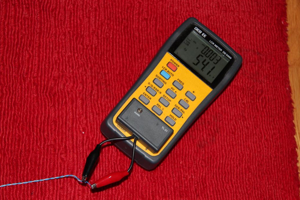

Hi guys,
FWIW I did a little cable capacitance compair today. Posted it here because its for internal use to my FSP/Pre build and cables are often up here. I twisted (very tedious) 118 cm of 32 AWG (very thin 0.0320 mm2) MIL speced PTFE insulated silver coated copper cable from Alpha Wire. Then I compared that to my regular thin coax, Belden NFR 0801 avr 100 pF/m and a cat5 twisted pair, known for low capacistance for HF use, Those were also cut to 128 cm length. Here are the results:
Twisted 32 AWG 47,7 pF
Cat 5 54,1 pF
Belden coax 141,5 pF
Recalculated to pF/m:
Twisted 32 AWG 37,2 pF/m
Cat 5 42,3,1 pF/m
Belden coax 110,5 pF/m

Sensible values findings and useful info especially to MM carts guysHi guys,
Cat 5 54,1 pF
Cat 5 42,3,1 pF/m
Twisted pair is alright when there is no benefit in noise pick up compared to shielded coax. Its all a matter of interference clean position of use. In general the coax is more secure when the signal level is very low. For MC carts the extra pF would not play a role anyway.
