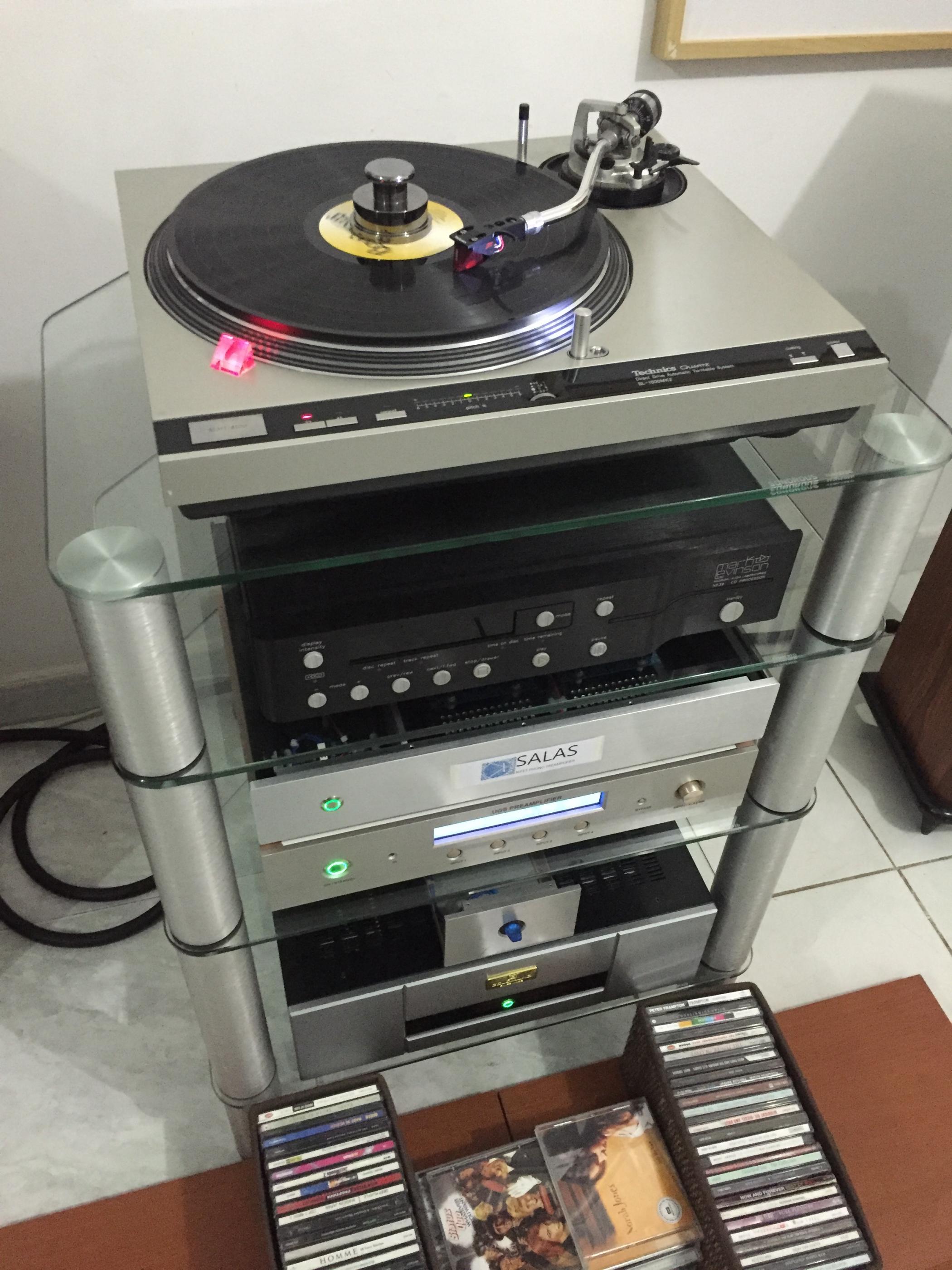

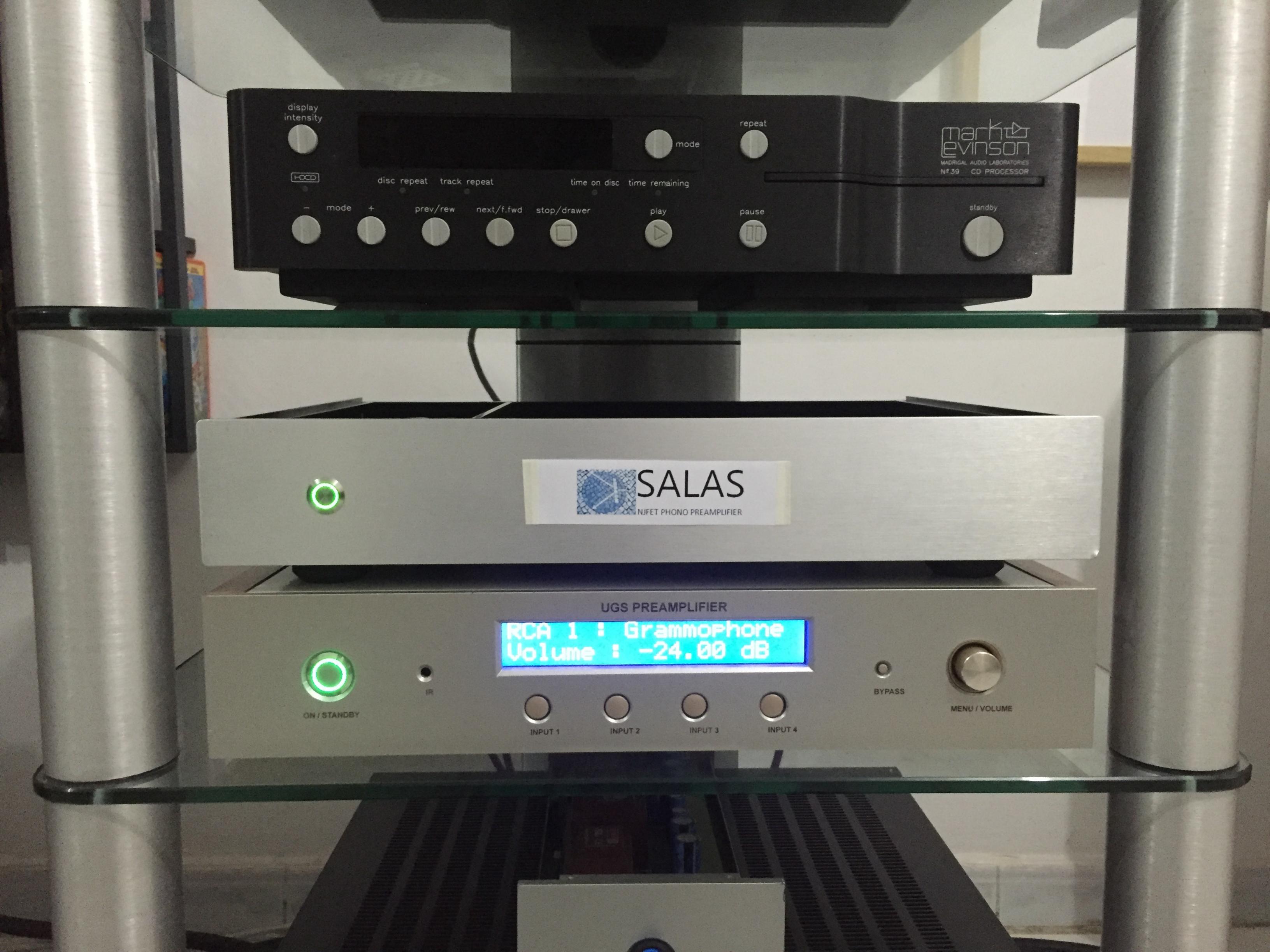

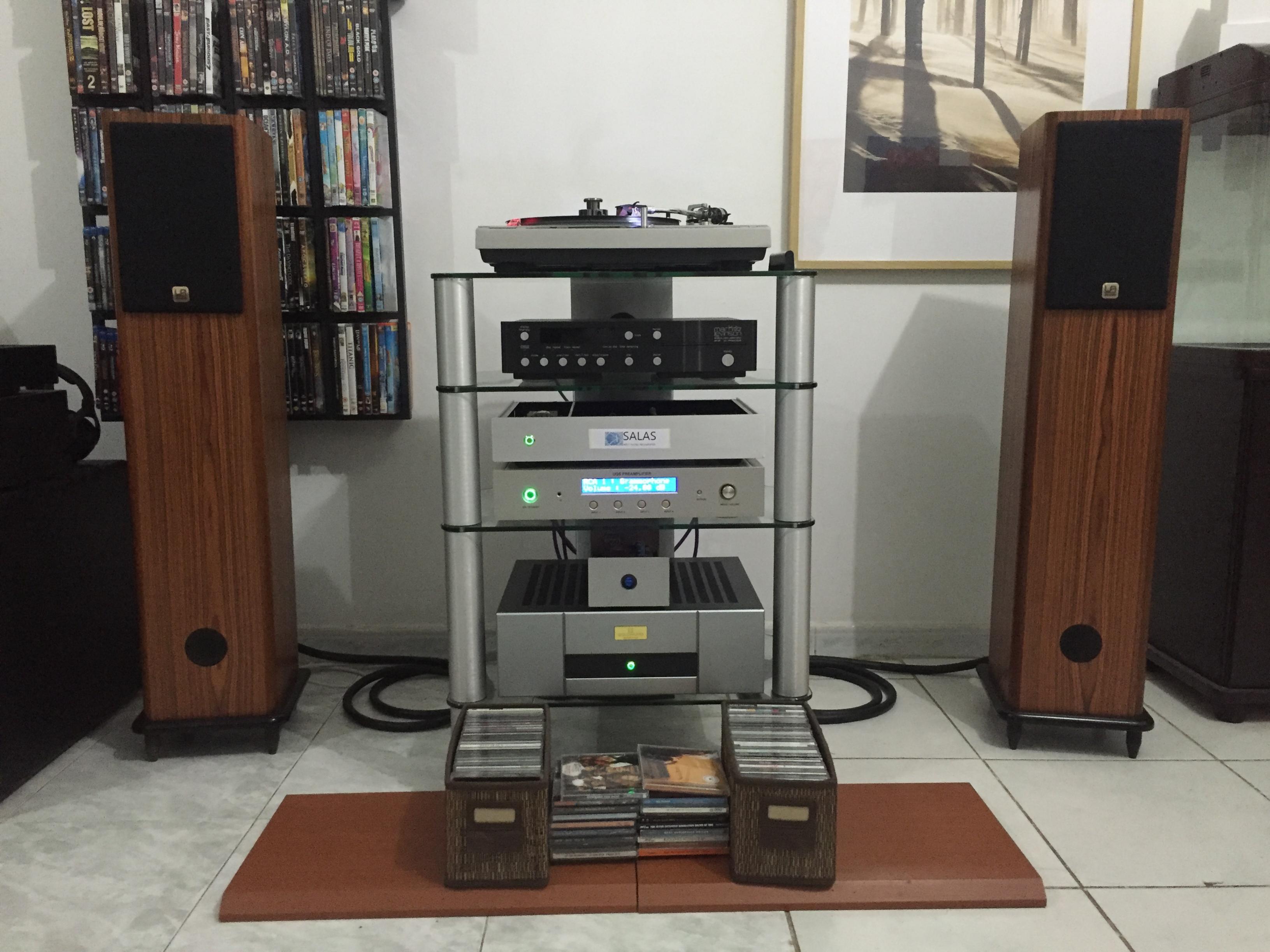

Great pictures, lovely arranged build, nice equipment. The "for now" sticker is nicely funny too 🙂 How do you like the sound on first impression?
I once had a chance listening to Devialet with a Sonus Faber speaker and that's an experience i cannot forget. That sound is stuck in my head. I have a few DIY amp and I can say the combo that I have now is the best to my ears and to add the FSP on that combo is an additional enjoyment to our living room. Once again thank you very much.
Some future cartridge upgrade when the needle gets old, like a budget high output MC, Denon DL110 for instance, or going to the black Ortofon needle on your 2M ($$) could bring further joy. Thank you as well for your build feedback and nice photos. There is no audible hum we were afraid of to be possibly coming from the PSU in the end I would suppose.
Let me share some pics of my FSP 🙂. As discussed I did wrap the transformer with copper sheet. Thanks Salas.
Very nice build...
Just Wow - looks much finer than my effort and its a good looking transformer. I like 🙂

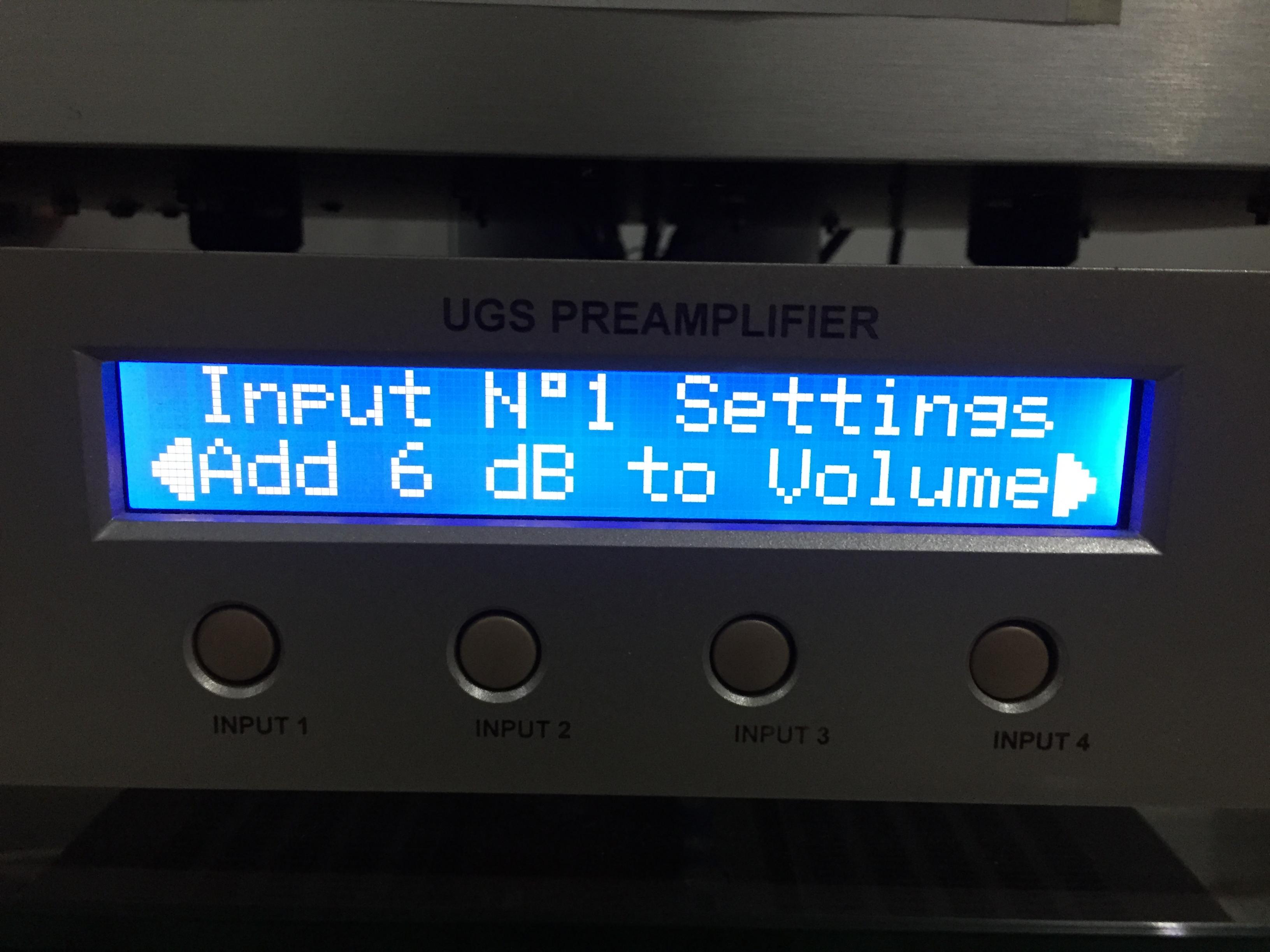

I check my UGS preamp and it has the below feature. what an added bonus. without you I didn't know it was there. Hats off to you Sir![]()
Ha, I did not positively know that for your model, pure guess. I better bet on some UEFA Euro 2016 before it ends 😀
