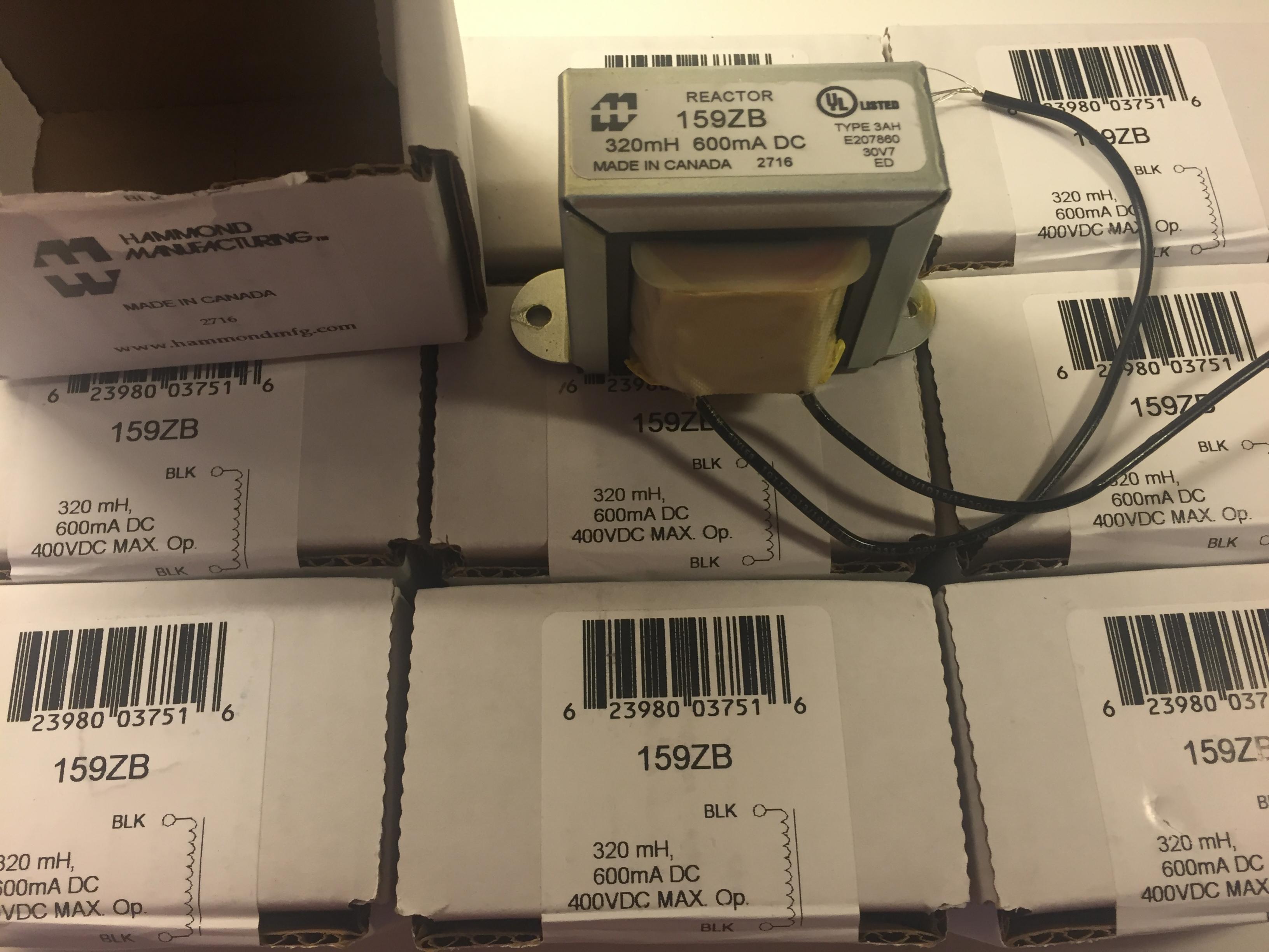

Beauty ! Congratulations. OK with the sound? Any pictures of the chokes in PSU?
I'll take some pictures later today!
The chokes in the the psu are inside one of those industrial AC filters, it is not a CLC supply.
You are talking about CMC (common mode chokes) probably and it is AC line filter parts, not DC chokes.

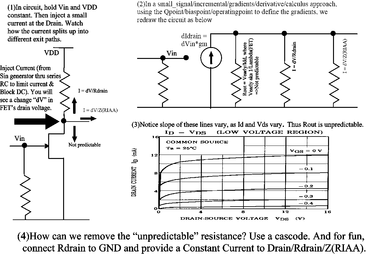

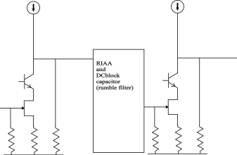

new circuit with no PowerSupply vulnerability, and stable gain
Hello
Been tinkering, measuring, designing and analyzing for 50+ year. I offer this circuit approach --- gm device and its Rload, both tied to GND ---- as a way to completely eliminate the VDD as a problem. Of course the "current source" now becomes PSRR limiting factor, but at least Rload no longer directly brings VDD ripple and trash into signal chain.
A second benefit is improved gain-accuracy and gain-stability.
The flatness of device output curves no longer sets the stage gain.
Ideally gain is set by ratio Rsource and Rload, but we know 1/FET_GM is involved. Not having studied the JFET specs, I don't know if there is much tailroom (between GND and Source) for degeneration of large value R.
I suspect not, given the 33ohm values I've seen you homebuilders use.

the PSU has a dual choke AC input filter
Here came mine to be PSU filter chokes.

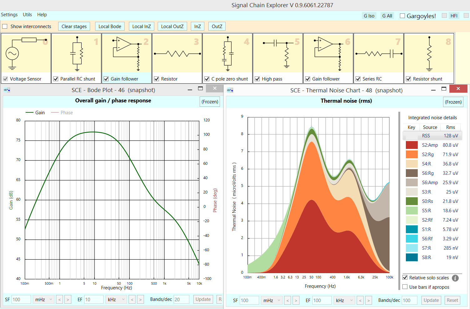

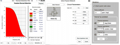

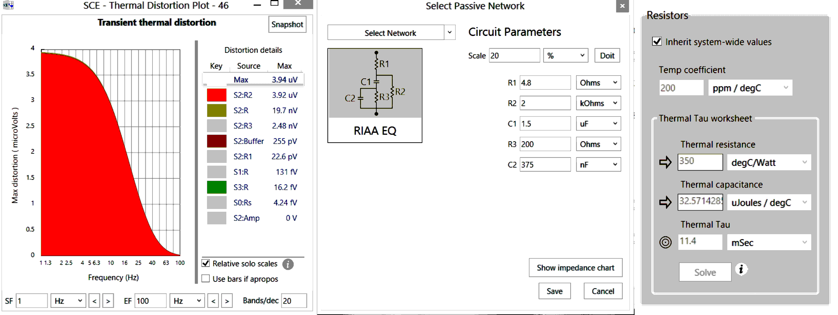

I hope this comparison of NE5532 versus 2SK170 is a useful explanation.can I ask you to explain what you mean?
The primary issues are: Left-Right gain matching, PowerSupply trash, Thermal Distortion/Modulation. [I'll post PSRR results if anyone is interested]

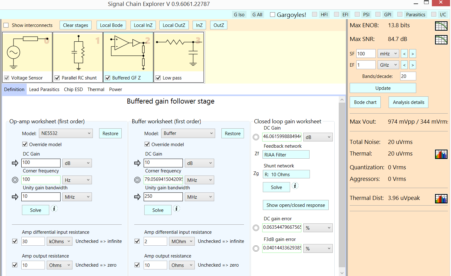

First 3 attachments show NE5532 on GainAccuracy (0.07% at 1KHz), 85dB SNR,and then 4 uV ThermalDistortion at 1volt output[TD is very low because a lowgain Buffer provides the high-current, taking the heat away from the OpAmp's differentialpair. This is not your father's NE5532.].
Then 2 attachments discussing the 2SK170 need for Cascoding and ConstantCurrent drive to provide drain Current. The intention is to achieve much more stable gain, so a one-time tweak of the Left_Right balance control is good for all time.
Note in the referred-to-GND circuit that when the FET conducts less current, the current into the Rdrain (the 5Kohm) increases.

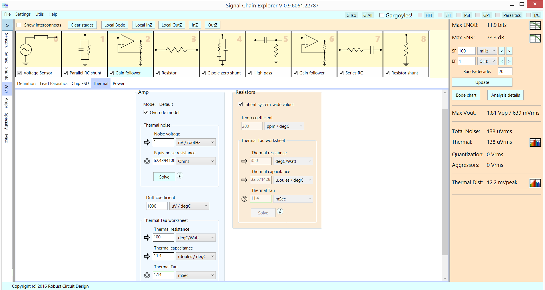

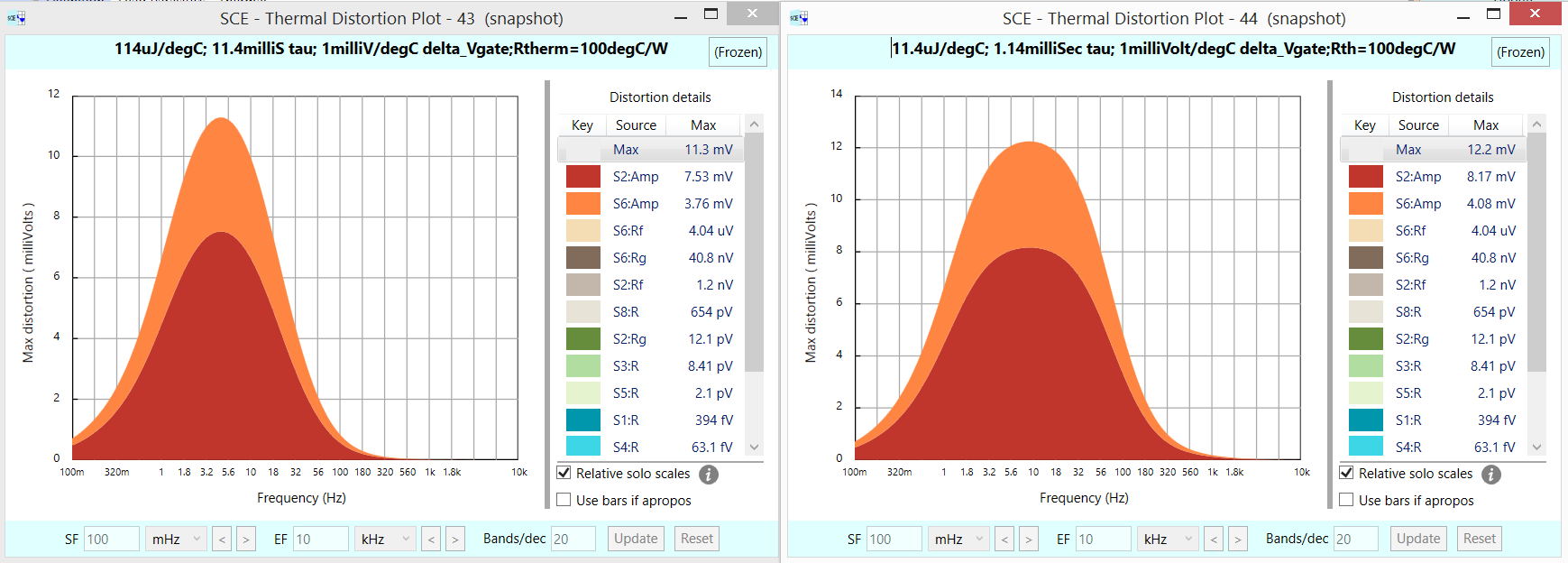

Altered an OpAmp thermal model to better represent the 2SK170, which has larger area, but is a non-differentialpair device as there is no cancelling of local heating effects.
Accordingly, (a)edited the model for 11.4microJoules/degC thermal mass.
And (b) edited Drift from 1uV/degC (suitable for OpAmp) to 1milliVolt/degC (suitable for a single transistor).
Result? given 250uV (moving coil) input, the simulation predicts 12milliVolts thermal distortion for 1.8volts output, or ratio of 150x or 44dB.
Attachment1 shows the thermal distortion for 2 different thermal masses. Note the peak frequency changes (by sqrtroot of mass change).
Attachment2 shows the signalChain (pretty much a Salas topology shoehorned into an OpAmp-oriented simulator) predicting 78dB SNR and Vout of 1.8volts.
Attachment3 shows the BODE and the various thermal noise contributors.
