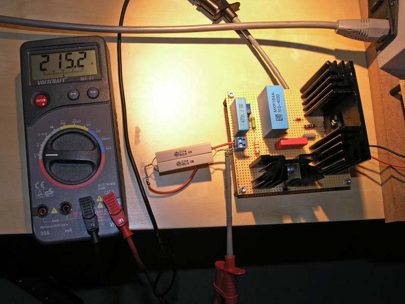

Also it can look nice if made with nice symmetry. This reg was made by member Stixx for instance. He has shown it on my HV shunt thread. Is it ugly?

I haven't got any right now from the finished good stuff but you can get an idea from the early prototyping phase, remember? When first testing the idea with a battery. Now it looks much more tidy without trial components underneath.

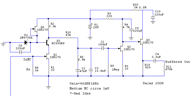

Here is my first draft of the riaa.... Please guive me your comment and advise.... (It will be used for p2p).

When you have time, please comment on the drawing... I must be sure there are now flaws this time.
Post the matching circuit version with matching part numbers also. But I don't think that I will have time to inspect today. This is to make in P2P?

I'm collecting the parts for the RIAA but I'm not able to find Q3=BC550BP.
Can you help me? what is BP or can I use something else?
