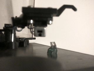

It looks like Japanese OEM. Maybe an old Nagaoka? Someone will spot it. In any case, soon enough, Kent will finalize the PCB for phono & Shunt for standard parts designations. It will be cascode first stage, so self capacitance will be negligible and there will be a Cx load capacitor position for adding the capacitance needed for any cart above the capacitance of cabling. So cable capacitance + Cx = total capacitance specified. There will be one common board for the phono and one common board for the 3 different voltage but same schematic improved shunts. Out of 3 respective schematics with same part names but different values and PSU voltage you will be able to construct either MM, high MC or MC. You can make the MM version then.

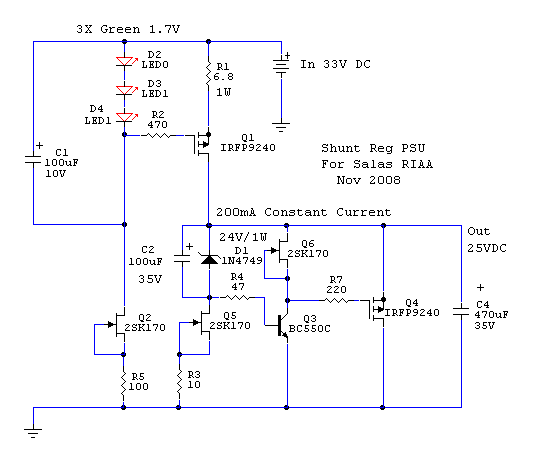

salas, something that might be interesting to you and anybody else that is using your regulator.
http://www.diyaudio.com/forums/showthread.php?postid=1780592#post1780592
Something I have omitted to say in that post is that the variation of your shunt regulator that I am using measures just a little more noise than the noise of the quietest LED I have. I guess I'm saying this as another confirmation that your regulator is performing very well
Thanks Iko for the noise tests. They confirm what jwb said also. Its noise, at limit down. Most important thing for me in a reg for MC Riaa. Mission accomplished as they say.
The local CCS currents have shown smoother overshoot with some damping. That helped the overall step test transient behavior.
See test
In the resume posts to come with Kent's Riaa and reg PCBs, the reg will have the R6 mod as standard, and will be Vbe CCS. Enhanced with local JFET as it happens with the LEDS example. So no fine tuning of R1 regarding to various LEDs. Vbe is standard for silicone. That will be the finely tuned and noise/output impedance tested reg recommendation with its mate PCB, as Ikoflexer have looked into the finer details of its circuit performance, and will assist Kent with the layout points of attention.
See test
