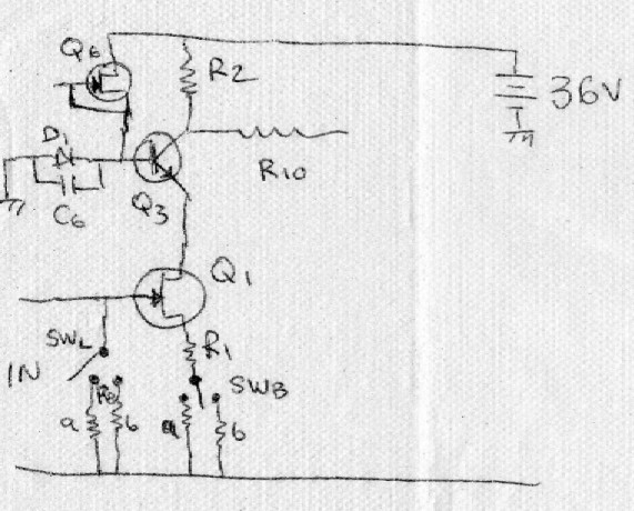

I`m trying to follow this thread, which is growing.
I thinking of building a version that will work with both MC and MM.
I have a Micro Seiki TT with an unknown cartridge, since there is no writing on it. The cartridge sounds very good, I also have a Shure cartridge that I never used.
What I`m thinking is adding a switch to the input to select the load(R8), and another switch to select the gain, something like this(see attachment)
Do you think this will work

We must know the output in mV of your 2 cartridges. Do you have the data? Switching the Rs resistor changes it not as much as you will need. But we can switch a bypass capacitor or two.
P.S. Since you don't know the model of the unknown cart on the TT, maybe you can tell if it is MM by examining if its stylus assembly is exchangeable. Also with what gear do you listen to it by now? Does the gear have MM or MC in? Is the level adequate, and on what kind of input designation?
Currently its setup as MM on my preamp. I did notice that when I switch from phono to CD, I have to reduce the volume, I suspect that the cartridge is a H MC type. The stulus is removable. I could unmount it and take it to a high end stereo retailer that's about an hour drive and see if they can ID it.
The second cartridge is a Realistic (Shure OEM) that I purchased at a local Radio Shack, like 15 years ago, when radio shack stopped carrying cartridges. It was their high end model, the cost was $40, this is the reason I purchased it. I think its the V15, I will check when I get home.

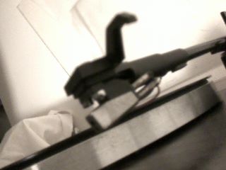

I didn`t know that removable stylus means MM.
The new cartridge is a Shure v15 RS. It has 3.5mV output, Optimum Load 47K // 400-500 pF.
I will mount the Shure this weekend and see how it sounds compared to my unknown cartrtdge.
Anyway it seems that the MM version is the way to go, right now.
Attached is a pic of unknown cart, with the stylus removed.(sorry about the quality of my cell camera)
Pete
