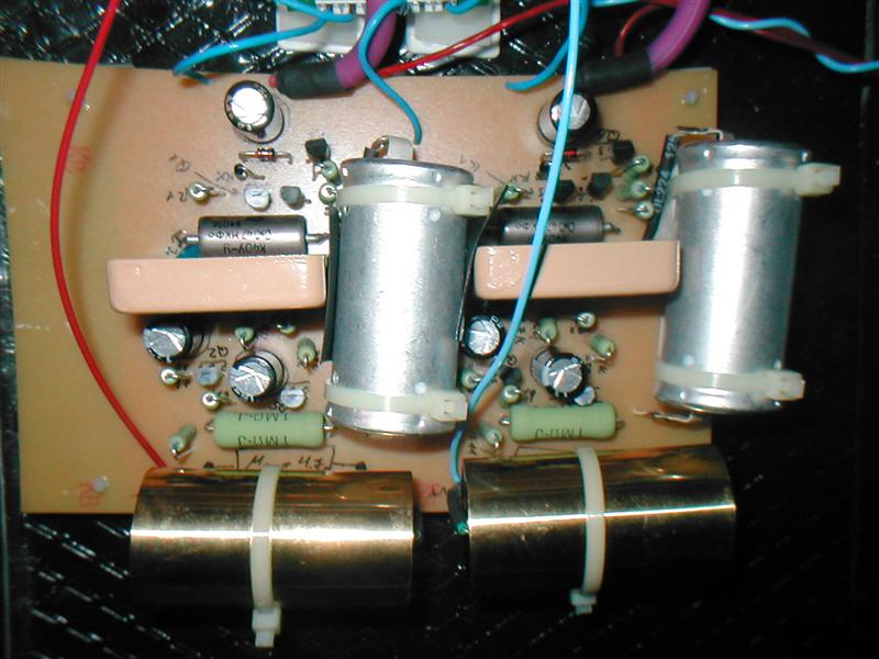

Today, while looking at my new FT-3, still lying on the bench and listening to my son´s comments about the "bilhas russas", the left channel started to puff at very low freq.... pooooor woofers...😱
So I decided to mod.
First I replaced Q5 (buffer jfet) and the annoing sounds persisted.
So I decided to clean up the board again.... still oscilating.:cannotbe:
Finally I decided to probe (very tricky thing due to my newly aquired human handycaps) and found that R4 oscilated quite vividly from 12 to 8v... the other channel was steady at 10.5v.
Looked at the circuit and decided... Q2 have to go.
After replacing this one, the circuit stabilized in 50 sec......
FT-3 are in place and even from the beguinning I can say these are much better for this job replacing the PIO K40y on C1.
Better bass control and seemingly infinite extension on low freq.
No proheminense in the mids.
Sweet very integrated highs.
Now I will have to listen to all the records again...:worship:
Ricardo (Very happy... Very confortable... Very very...:smash: )
I soldered R3 without heat sinking the jfet leg 🙄
As usual I am learning with my mistakes.
Now Lee´s board is looking like a madman project.... It is not suitable for frequent parts removal.
After 30 minutes playing, the sound is already awesome.... Unbelievable....
Ricardo
