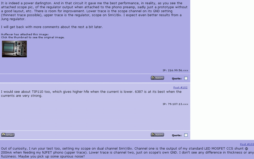

P.S. The noiseless scope line comparison (Ch1 shunt on phono without R6 mod VS CH2 scope's GND) was done without any RF cap at all, so no big worries, its just a good add on, given there is significant cable length and a strong enough RF field to pick up. So some will listen to a benefit and some will not.

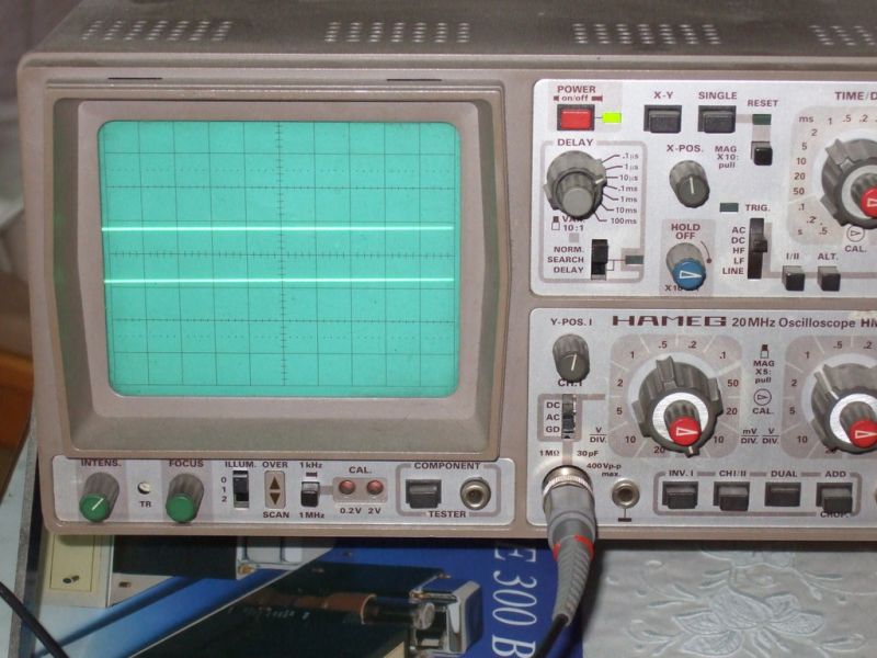

My scope trace without the bypass cap in place is about 2.5mV thick
and is reduced to thinner than GND trace when cap is used. Huge RF polution where I am, I guess 🙄 To each his own, but for people without a scope it makes sense to add a bypass cap. Can you think of any downsides to adding a small ceramic cap?
Yes, as I said, a prudent add on. Remember when I was warning you against external pick up, when you could not see it really thin?
For ceramic nothing against its tec HF merits, but every time I substituted such a b@gger for a fast PP cap it sounded less edgy. Either for a cart load or in PSU decoupling. So I avoid.
