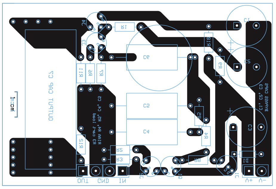

kstlfido said:ikoflexer and all-
Here is the copper and top side art pdf's of my Salas Riaa board. I can almost visually walk through the circuit now! If someone can see mistakes, please let me know.
I gave the input cap C8 a hole next to the signal in terminal. Just tack the other end of the this cap to the ground plane.
Unzip and thou shall find 2 pdf's, both reversed ready for printing!

Here it is. Only suggestion is that the right most JFET is better to face to the right so the g,s short together instead. The decoupling capacitors earth to the right needs an individual wire to the star, since Kent divided the signal return from the psu decoupling returns.
Thanks Salas. It looks like on J1 I got the orientation 'flat' backwards but the G and S are together, D goes to + rail.
Actually, I noticed some other inconsistencies now. Part numbering is a bit chaotic; and some redundant parts. I suppose it depends on which schematic you look at. I will get to these issues later this week. So, please do not use until I figure it out.
-Kent
-Kent
kstlfido said:Thanks Salas. It looks like on J1 I got the orientation 'flat' backwards but the G and S are together, D goes to + rail.
-Kent
Till then I will see to post 5 schematics with standard part numbering and 3 different sensitivities, so you can rename the parts to follow. I will post 3 with cascoded input and 2 with non cascoded input. Also shunts with standard schematic but set for the according Vouts.

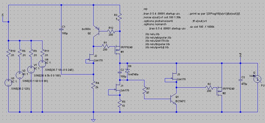

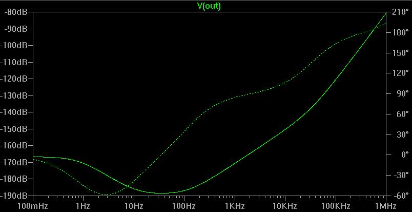

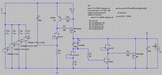

Hi guys, I hope you're not getting sick of my twists to the regulator. There is an improvement that I would like to report. salas, you've already seen the opamp version, and I have improved that too. The psrr plot of that (simulated) is superiour by a mile to any other regulator I have seen published on the net. I have implemented it too, but there is something about the sound which is off. I cannot trust my years, but I prefer your regulator which does not have an opamp.
However, I have made a small change which has further improved the performance, both in simulation and in real life. I have built it tonight and the scope trace is as thin as the GND line (even a little thinner). The sound is good too.
Another detail which might help others: a ceramic 100nF capacitor right at the B+ and GND entrance to the njfet phono is a great improvement (high freq. filtering).
Here is the schematic.
Hello Iko! What's up? So the Op-Amp super reg was a bit not good sounding? In what way?
This mod you did, is about the extra JFET CCS for BJT load? And also a JFET CCS for the main CCS control BJT in a Vbe controlled one?
Yes, you wouldn't believe the psrr of the super opamp circuit. In simulation. I put a picture of the psrr in its thread in solid state.
Yes, the small change is the jfet loading of the bjt. Its psrr curve is close to the Jung regulator, without an opamp. Not bad.
Edit: I am not sure how to explain the sound of the opamp circuit. Somehow restricted, but somebody else should listen to it; it's easy enough to build.
This extra JFET CCS for the BJT we have checked out here too and we all got somewhat better sound, but Ricardo got the most subjective benefit. Maybe because he uses a cascode first stage. Its code name is ''R6 mod''.
For the 100nF directly on the B+ receiving end to gnd, I have to agree, the more the wire length from shunt to phono, the more work it does. I have recommended that to Ricardo and vgeorge. Always to be used when separate PSU and Phono boxes are employed. You can see it on mine too, where the red and black B+&GND twisted pair meets the phono board.
Salas- thanks. I'll wait on the corrections. Then we are all talking the same part #'s. I will try to design a matching shunt PCB (the R6 mod one) as well.
One thing I'd like to do is to make more room for bigger R's; namely the 2W Kiwame's you and others are using. What is the size of them? I do hate standing them on end- ugly! 😀
-Kent
