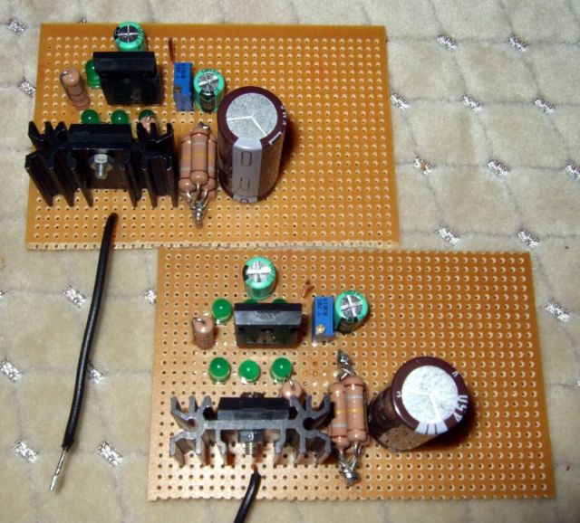

Hi Salas
During this weekend I will be updating the shunt with the R6 modd.
Should I replace also some resistors ?
Can you identify the most important resistors ?
Regards
Ricardo
Regards
Ricardo
Hi Salas,
just did R6 mod in less than 2 minutes, and what can I say, sound seems even better. Must be also capacitors braking in.
Also ordered some Mundorf silver oils for the output.
Still looking for the chokes to change them.
Did you perceive smoother treble after the mod? That is what I mainly got. You are on a good sonic road I believe. Are you content by the performance in this early stage? Listened for some hours? After 50hours total, the shunts will mellow down and in less extent the phono.

No I haven't used such alternatives yet. Just BJT cascode and enhancement mode T0 240 Mosfets. I would like to get some depletion mode since they don't need the LEDS, hence more practical, and compare. The concept remains the same of course. So someone has to maintain the operational point and check for subtleties regarding different cascode parts. BTW 10M45 can have oscillation tendencies I have read.
Hi Salas
Just replaced R6 by a jfet and the sound is much more sweet without loosing any detail.
I am hearing chet baker and his trumpet is much more lifelike now. Also his voice is crearer and with more "grunt".
I believe it is a fundamental mod to this shunt.
PS: I still have some hissing and spiting noises after power up... I must review the shunt to Riaa wiring...
Ricardo
