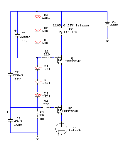

You just stack 2 IRFP in the CCS, the one above is shielding the miller of the one below. Have a look in one cascode anode load for a tube preamp that I did, to get the idea. It extends the performance up high a lot.

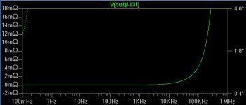

ikoflexer said:
L=100mH, C=4700u psrr of the above.
I don't know about the peak and roller coaster curve. Although great in dB region. I like soft trends. My guess is that a wee bit of capacitor imperfection, some layout reality, and a few cm of wire, will never let any reg do better than 100-115dB real life magic.
The peak and roller coaster curve has appeared on absolutely all the regulators I have simulated so far, the Jung, yours, all, when the LC filter is inserted in the input. I agree with you that those number don't mean a thing in reality, with all of its imperfections. Ah well, at least it looks good on paper 😉
Better avoid then. It smells interactions. To the contrary, a cascode CCS surely helps on self noise, extending the good region of CCS performance a lot in frequency. But it is more of a hassle to implement. Good for low parts count are DN depletion Mosfets from Supertex.
The cascode doesn't seem to help at all. I might try just go ahead with this version to see what it can do in reality.

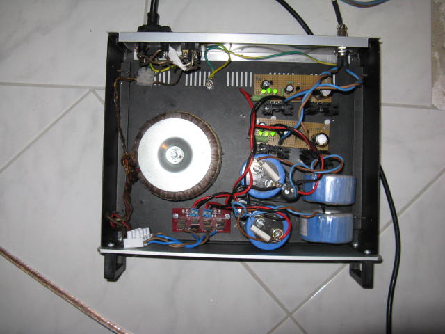

Hi Salas
Just did the GND mods as per your sugestion and the result is a better stereo image, better stereo integration and much better bass (detail - extension).
There are two issues that I need to deal with:
1 - The hum I am hearing is lower but always present... I can hear it when not playing a disc and the pot is half way up. It seems to me it is related with the regulation because it sounds like a motor running (a little faster than 50Hz).
2 - Everytime I cut the power to the Riaa (to do some mods) and power it up again, I need to wait for 5 - 10 minutes until it stabilizes. During this warm up period, I hear spitting and thunder coming from the speakers. I measured the DC offset in the output and it oscilates between 200mV and -40mV until it reaches 9mV and stays put.... Is this normal ?

Ricardo, hunt for those noise issues you got after so many substitutions and soldering at your leisure, with clear head. Since they were not there before, they will be taken out again somehow. I still recommend you to try your shielded wire that you use for input, in the same way for output too. It may lower your hum further.
They had a very nice analysis about low noise regs over at the solid state section forum by professional level engineers, me and Iko took part, and an easy to implement suggestion came up for our shunt too. I have it on test. Seems positive for now. Will extend and confirm my listening, and I will let you know if we got an easy shunt mod to adopt or not, soon.

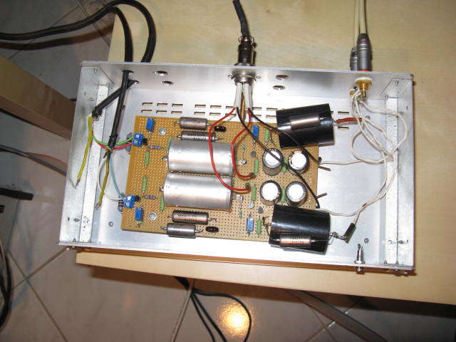

My Salas RIAA is finally finished!
First, it is totally silent through 96 db speakers, without proper connection of tonearm wire shield. The sound as far I can say is excellent! I have not make a proper audition yet, but I it is very promising.
The output caps are temporary 22uF bypassed. Maybe order some auricaps 3.3uF today.
Also I gave the schematic to a friend of mine to built it, he is has no internet and he is amazed too!
Thanks a lot Salas.
George
