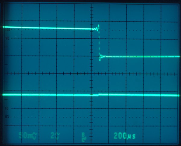

Also good news from solid state forum, member jwb made a breadboard shunt and runs tests. His findings till now that I took from his posts:
''Here's my 9V version of the design by salas. I think it's brilliant.
It doesn't oscillate at all, and whatever noise there may be is well below the ability of my scope to measure (also well below the noise from the bench supply input.)
I like it!''
''I had a chance to play around more with this simple shunt this morning. The output impedance is flat from 10Hz to 20kHz at 30milliOhms. Not bad 🙂''
''Transient performance isn't bad either. The top trace is the load signal into a 62R load (about a 25mA load step), and the bottom trace is the regulator output.''

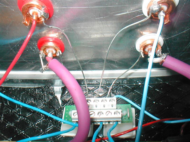

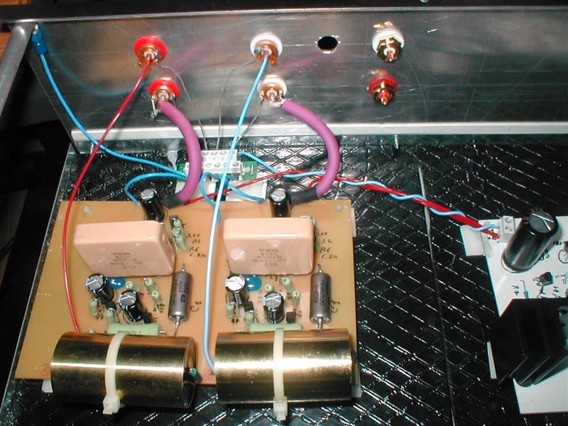

Hi Salas
Today I placed the 4.7u 630v obligato caps on the output.
I cleaned the pcb gnd plate around input and output tracks and settling time is now under 15 minutes...😀
The caps are burning ok and sound is becoming more coherent... I notice bigger soundstage and more low level detail but bass is a little shy right now. (Hope it opens up in the end).
BTW, can you point Kent´s board for me ?
Ricardo
Well, I still have to wait until the output offset stops oscilating after power on... It oscilates from 20 to -4 mv until it rests near zero.... 15 minutes spitting and puffing... after that, total silence.
It is channel dependent (one stops faster than the other) so the problem is not in the shunt.
Now the caps are opening... quite good so far.
Now the pic with the new GND arrangement (This gave a great improvement in focus and coherency so I believe it is very important)
