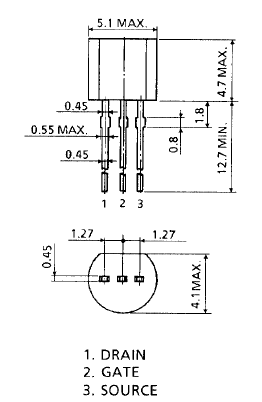

RCruz said:
When you have time, please comment on the drawing... I must be sure there are now flaws this time.
I think that you got all JFETS facing the wrong way.
I meant to have one point still, but different take off alternatives just in case. Regarding R20 I thought it may help you if there is less voltage across Q5 regarding the noises you get. Since nobody else ever got the noises, I don't know more. Its a proposed experiment. You will tell if it helps the noises you get during warm up or if it changes the sound. The current remains the same.
I believe noises come from bad solder joints... my pcb is now a real mess.... that is why I want to rebuild everything.
If nobody else reported any issues, maybe I should stick to your original design.
