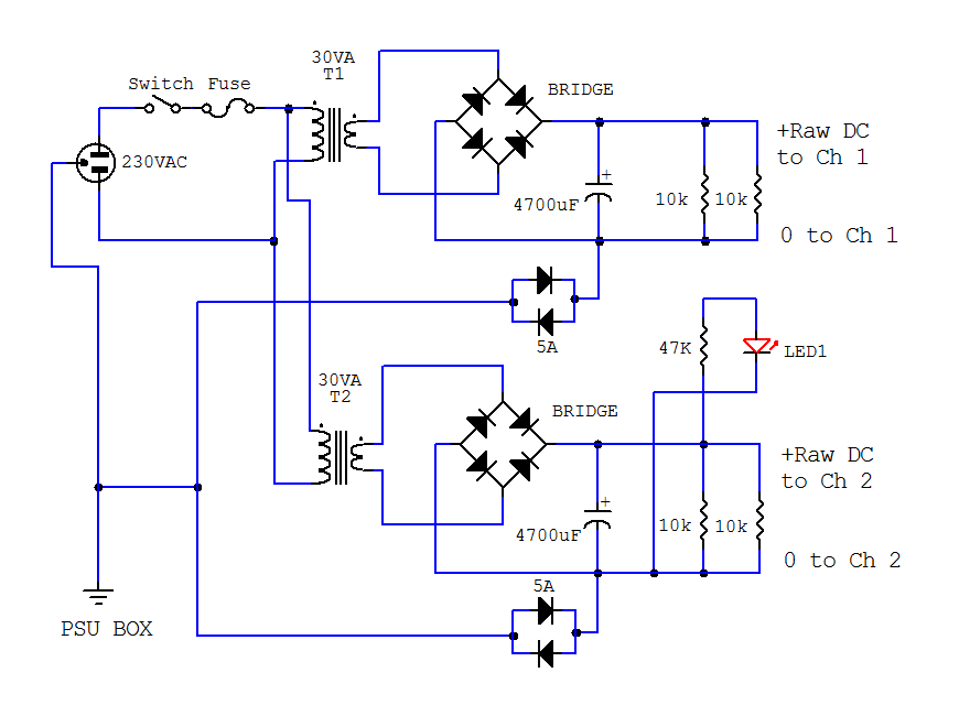

One more and detailed explanation for GND isolation technique:
1. Earthing (Grounding) Your Hi-Fi - Tricks and Techniques
2. House GND Kit
Stajo is absolutely right about 1R resistors purpose, but some guys use 2 separate ground lifters (one for each channel). At that case you can omit these 1R resistors.

Tanks for links and advice I take that the interconnect have the shield cut at one end
So to avoid ground loops
I would not recommend to any one to cut off earth cable at the plug for any thing I make
The Eliot site shows a different arrangement (bridge diode and no 1Homs resistor)
It does mention that ground loop are caused and made worst by different length of cable
Putting a 1 Homs resistor in series is like making the cable much longer.
It is confusingly obvious that there are different way to pluck a Duck and one wonders if the Pre regulators as on the Paradise would also work (I am pretty much confused now those do different job. U sure?😕 lets use those as well)
2 ground lifters is another option easy enough as got big bag of bridges and nearly 1000 3W 15ppm Holcos
But what wrong whit star or bus of stars for ground?

A coaxial cable between two modules is a TWO WIRE connection.
The Signal Hot Flows through the core of the coax.
The Signal Cold Returns through the screen of the coax.
You NEED the Flow and the Return to allow the signal to follow the route from Source to Receiver and back to the Source.
Cutting the screen connection at one end breaks the intended Return Route.
You must not break the Return Route !

Look at Eliot site and see loop whit shield in the inter-connecting cables
zero potential is mantained by the ground "earth cable" if same morron decide to cut that at the mains plug let him or any that got near the DIY FiFi die in case of any fault.

Before you cut the shield on your interconnect, just plug your RCA plug in part way so the center conductor (signal) makes contact but the shell (shield) does not. If you like the resulting sound, go ahead and cut your shield. 🙂
Well I did not make my PSU as described. I did it at my standards. You yell at your standards. Either do at workable standards or shut the **** up. Dodo

BTW Bksbth, here's the alternative raw PSU double lifted you mentioned, I had also posted back then. Trafos 32VAC-36VAC (loaded) and 63V lytics will do. Lift diodes pairs can even be bridges (~~linked to PE, +-to zero line), also resistor bypass reference and RF grounding cap can be added to each lifter as you know.
- Analogue Source
- Simplistic NJFET RIAA
