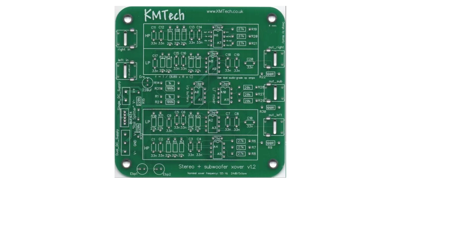

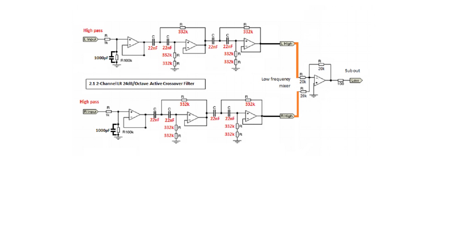

I wrote several articles about passive vs. active filters (design and performance) and I made my decision to build Linkwitz “20Hz High Pass” with the integration into my Sub. It is easy since a lot of good quality of PCBs are on eBay. I'm going to put an input and also output buffer. Just for the reminder: it should help me to remove subsonic frequencies which are causing woofing-flipping effect on my subwoofer when I play records. No issue when I play CDs since CDs does not have that low-frequency data recorded. Please see attached schematics and PCB picture.

That is a 4-th order LR with unity gain buffers on in and out so you dont need anything more then that.
Yes it is. This why I choose it.
It is a kit on eBay and I slightly modified it for my needs.
New 2 1 24nu llO ctSter eoActi veCrossov erSing leS ubOutp utButtkick erP | eBay
do you realise that you have used 4 extra opamps? Compared to:................I made my decision to build Linkwitz “20Hz High Pass” with the integration into my Sub. ............... Please see attached schematics and PCB picture.
Input summer opamp>>first 2poleHP>>second 2pole HP. equals 3 opamps for the same 4pole HP filter with a low impedance output to feed the next stage.
I did realize that I need an extra opamps vs. other types on HPs, but I have about 20 of OPA2134 in my home stock. They cost me 20c each and found them about year ago in local surplus store.
