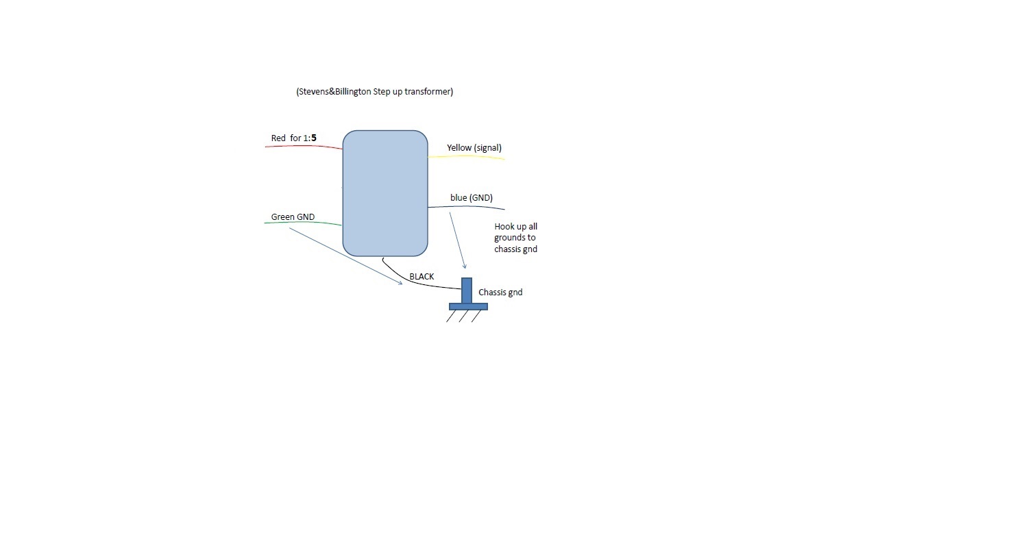

The transformer isolates and makes the TT cable run balanced as the cart coils allow, if its of the balanced impedance floating primary kind so it gets rid of interference on the TT cable. Also it usually has less bandwidth than the electronics and filters RF. After trying 1uH coil even, I tend to think the problem is less relative to what you do at the phono side of things. What about the woofing? That stopped too, seeming related? Was there any interference hint before changing the internals of your cart? Since your X5 SUT does not overload the high sensitivity FSP version (proves quite good margin in practice for that) and solves weirdness in your installation, why not leave it in. If there is no compromise in the transparency department that you can feel, surely.
Thank you for clarification. Yes, it is definitely TT related issue and not FSP setup or matching. It is also not my new rebuild cart (the old one has the same issue) and not the cable since RF and noise gone when I shorted cart side colored cable leads. It might be some issue inside carbon tube (my arm), but I can’t check it out. It is sealed.

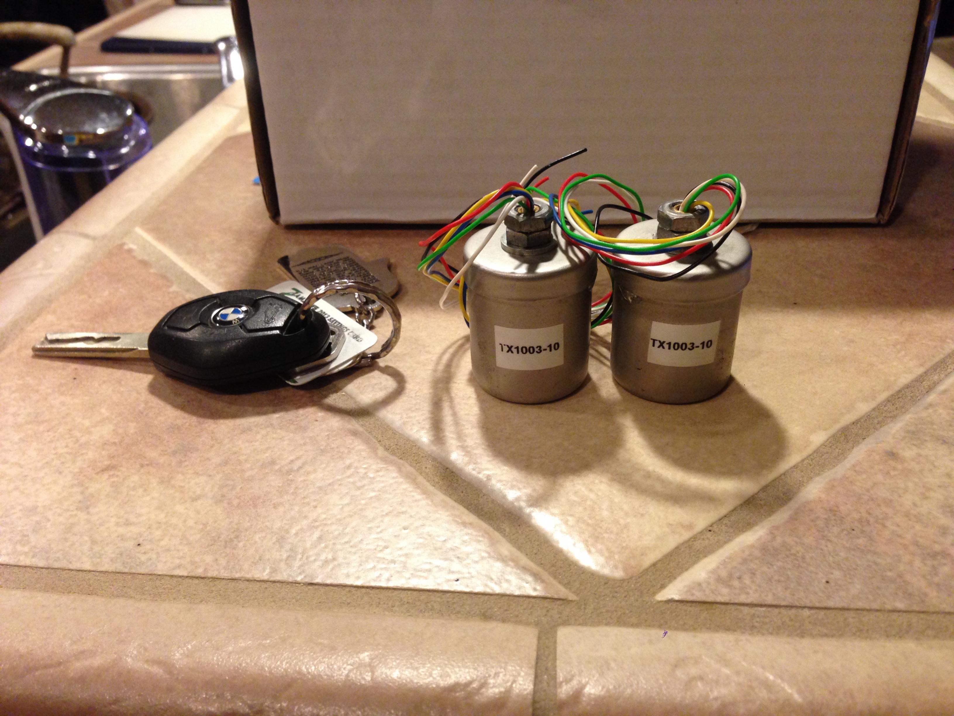

Though question…. I obtained two sets once, about 4 years ago. One set is 1:5 and second is combo 1:10 with 1:20, depend to wiring.
If I’m not mistaken, it was TX1003-5 (x5) and TX1003-10 (x10 and X20) cupper and I purchased them directly from Stevens & Billington UK. I paid about $185 for a pair and friend of mine helped me to get them as for a dealer price.

Those are very good make. Among the very best. Fully symmetrical also. If there is an electrostatic shield wire, that should go to FSP signal ground along with secondary's cold.

They sent me some connection instructions back then with tranys and they mentioned to connect all GNDs to chassis GND with the electrostatic shield. So, you recommend to connect only Output GND to Chassis and not to connect input GND?
That's an SE grounded transfer scheme. I think if you will connect green to any electronics GND you will lose the balanced signal travel benefit from cart pins to the transformer's input. This SUT model is most probably symmetrically wound inside. I would start with red & green input twisted pair to TT floating (RCA in), yellow & blue to FSP pcb twisted pair, (blue to input GND its already referenced to chassis), to keep interference pick up areas tight. Then the black to chassis lug. If noises happen, in case there is a reason inside we don't know about this step up, you do what is in the photo. No big deal revising connections on trial after the mechanical installation is done which is the bulk of the job.
Tried all ways and no input GND either output GND connect to chassis GND is the most quite way to connect these tranys. I connected electrostatic shield and transformers cans-containers to chassis GND and that is it. Very quiet now and I’m happy.

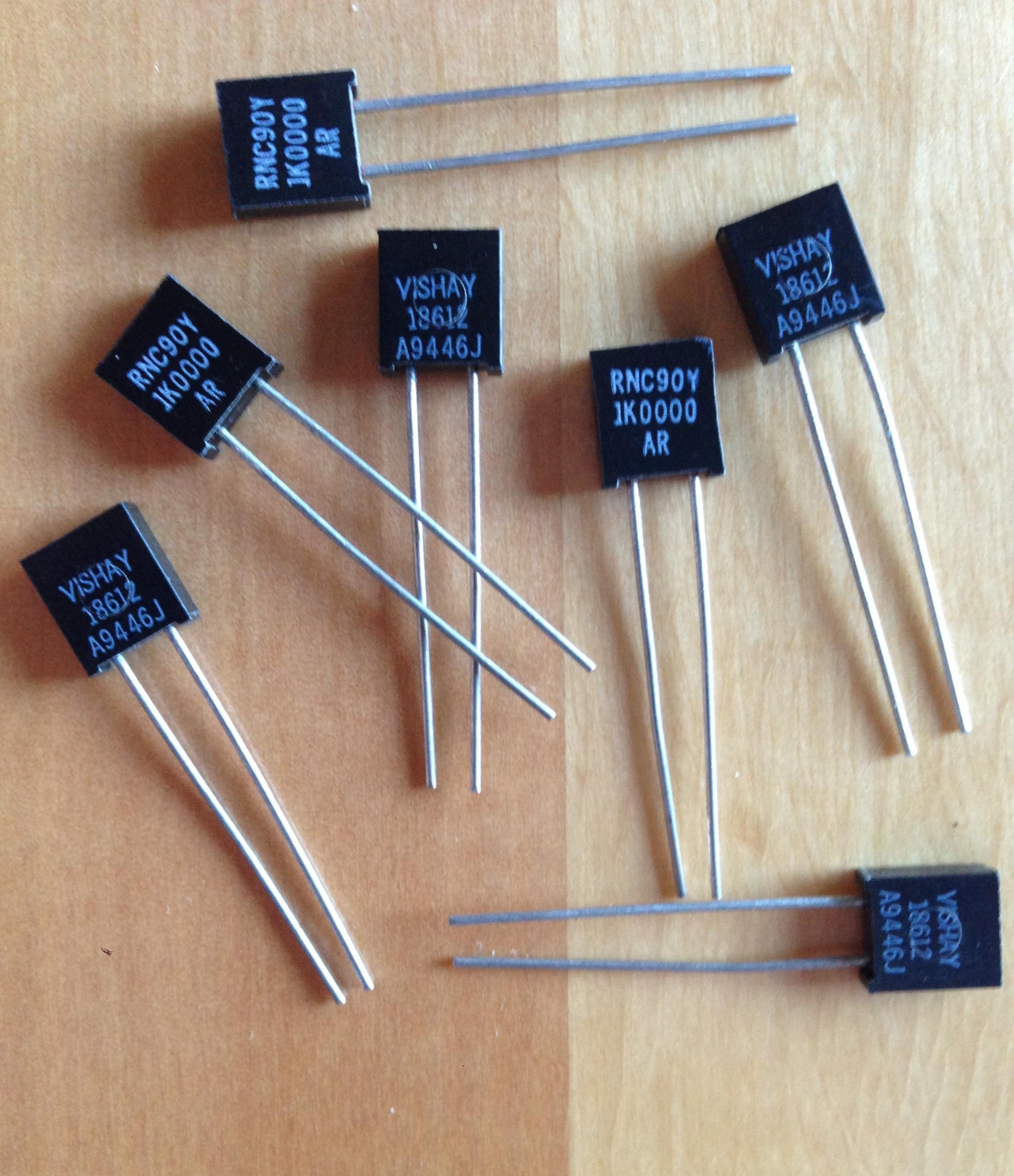

Since we already started to talk about resistors, how about RNC90Y series? Does anyone try to use these? I found some limited stock in local surplus store.
Those use very low TCR encapsulated Z foil. Not expecting anything less than excellent performance.
Good news. They have several values which might be useful in future projects. Thank you for clarification.
