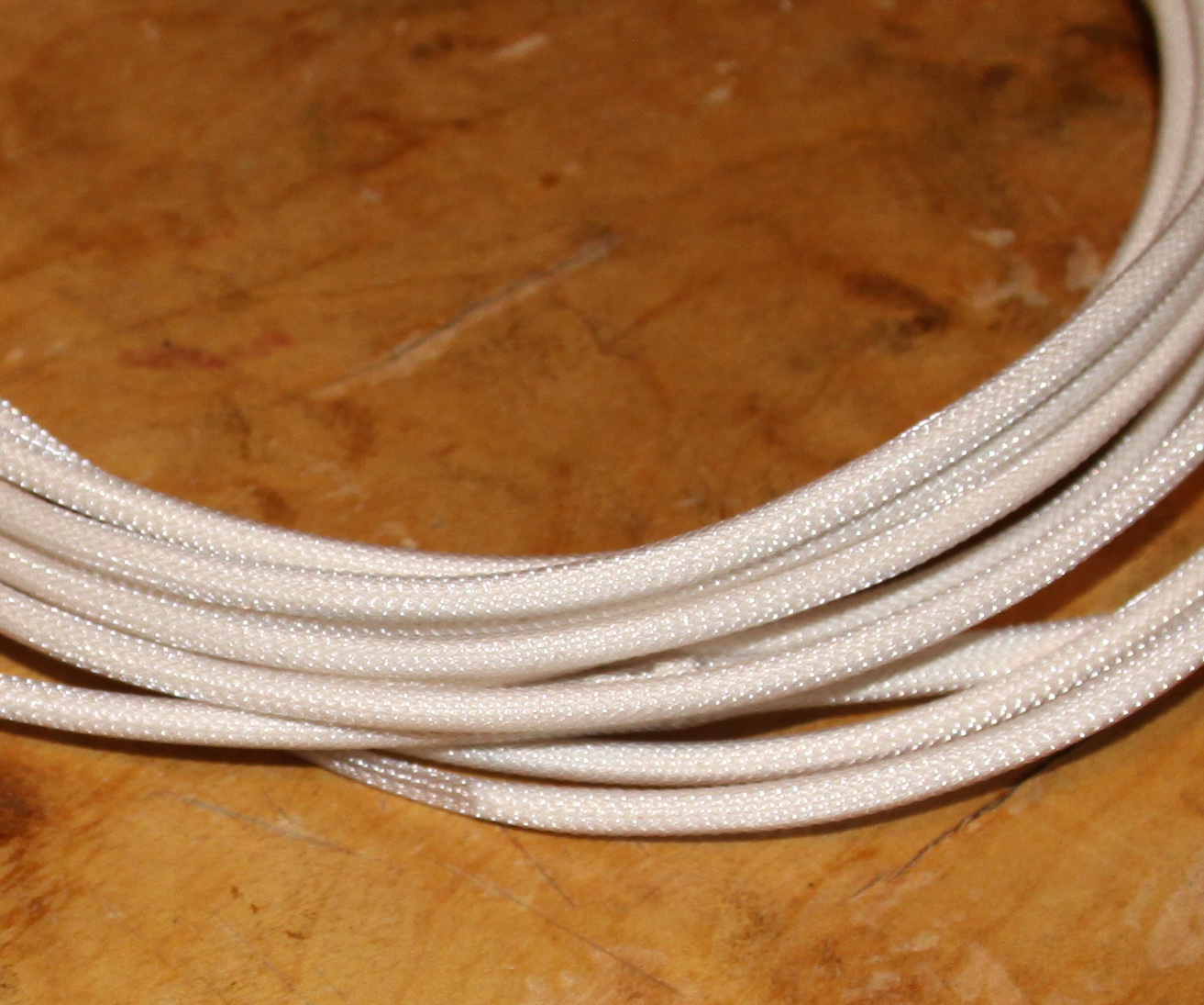

Have spun 2 x 5meter with silver in cotton, twisted tight, inside another hose of cotton and lastly a hose of plastic.

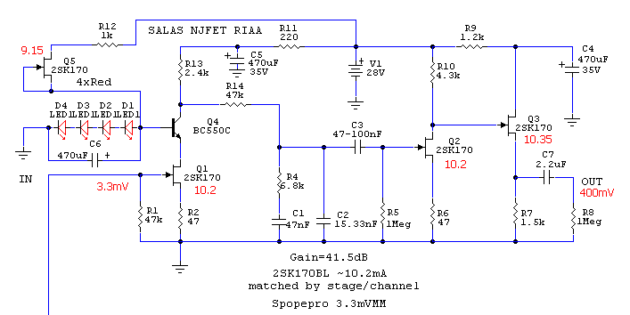

Hi Salas,

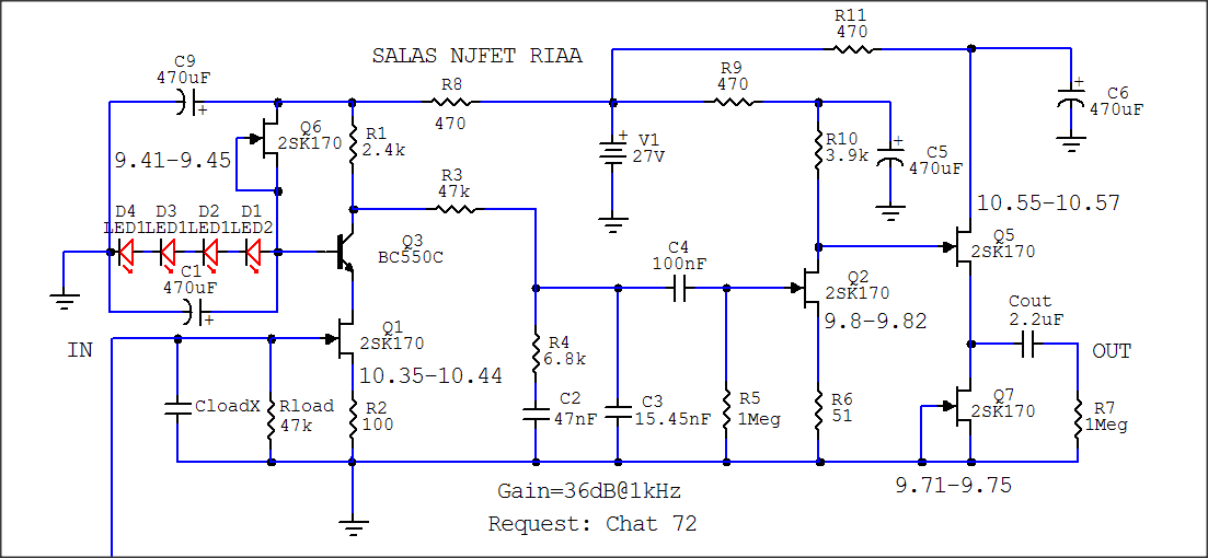

I'm planing to built NJFET older version for MM cart. I'm going to use it with Rega Elys, very high output MM cart, about 6-7mv. I use it with 40db phono and I rarely make it pass 9 o'clock with my 84db speaker.
So I need low gain around 36-37db. However, you suggested that the schematic will work with k170 around 8-8.5 idss. Mine is around 9-10.5.
I came across one of your suggestion for 40db phono with 10ma Idss. I just wondering if this will work in my case with modification of changing R2 from 47R to 100R to get lower gain. This will be my first discrete phono project apart form op-amp project. 😀
Your suggested schematic and my k170 idss are listed below.

9.27
9.41
9.45
9.64
9.71
9.75
9.8
9.82
10.05
10.35
10.44
10.5
10.55
10.57

I will look for a specific suggestion later, based on your samples.
Thank Salas, 😀

Yepp thats my plan,
At the moment am using traditionally shielded cables (Silk MK2) with Furutec rodium RCA.
If the long stretch plan involving about 4 meter silver from the TT to the Riaa is working am going for that,
I like the silver in cotton solution but there are those who criticize it for lacking bass and beeing to light.
Im normally using Bullet plug for the silver and am gonna solder the other end directly to the tone arm cable.
Regarding purchase of silver cable you might look at post 12017 but living in Boise Idaho (i guess you are a fan of Richard Pryor😉) the Scandinavian distributors are a bit far away for you.
I guess many other Hi-End shops might have silver cable it but be aware the prize increases proportional with the boutique factor.
Pure annealed silver is not worth nothing without proof of conformance.
You save most money by contacting a raw metal jewelery distributor (is this name existing) and you may get a big roll for a 100$ or so WITH the insurance that the silver is according to specs
You want 99.99% pure annealed silver about 0,5mm dia for signal cables.
But in your case not needing more than a set of 1meter cables you need 4 strands of 1 meter,
When twisting you loose about 20-30% so you need about 5-6 meters for making the set.
For that limited quantity i guess you can purchase from a Hi-fi shop selling at relative high price,
