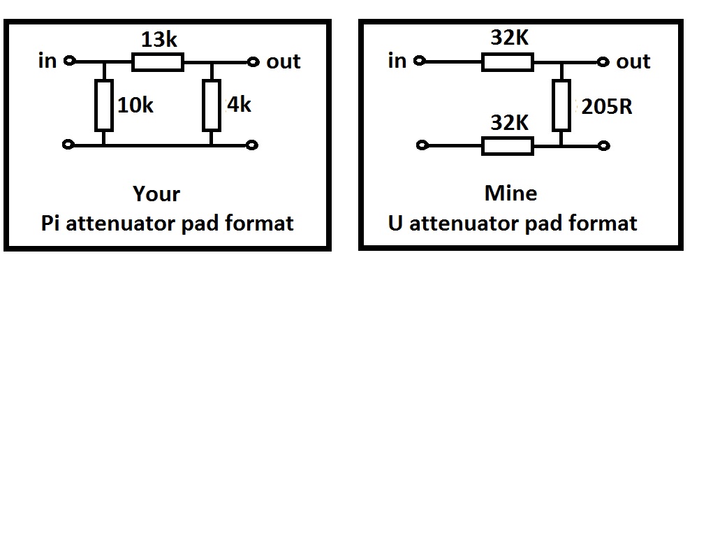

Works sweet
i use an old autanator
try with a 10k pot if you have one lying around
Have tested the values when i break in mine 0.3mV cart
10Kohm between earth and line in
4 Kohm betwen line out and earth
13 Kohm between line in and line out
I see. We have the same thing but just a different methods...
I have 1.6mV on mine.
Better twisted pairs. Good luck building.
