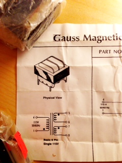

Parts question

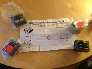

I'm sorry if this is the wrong place to post this, however, I am gearing up to build one of these esteemed units and I found these transformers at HSC surplus for $4.25 each.
The sign on the bin said "36V single, 18V double, 6 amps." The guys who work there are wonderful, however, they don't commit to an opinion about what stuff is (and if you don't act like you know what you're doing--they make you change the fuses on the test equipment 😱 ). I was wondering if someone could tell me what I need to do to check the specs on these? or point me somewhere to look. I would appreciate it.
Thanks,
David

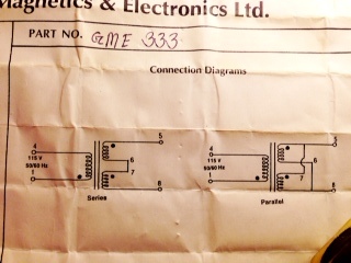

Can you post a bigger close up picture of the leaflet?
Hi Salas,
Here are two close-ups. The left side diagram is labelled "115V 50/60Hz" and below it says "Basic 6 pin Single 115V." The right side shows series and parallel connections. The store has other values in these too, so it would be nice if I could learn how to measure them. Thanks for taking a look.
