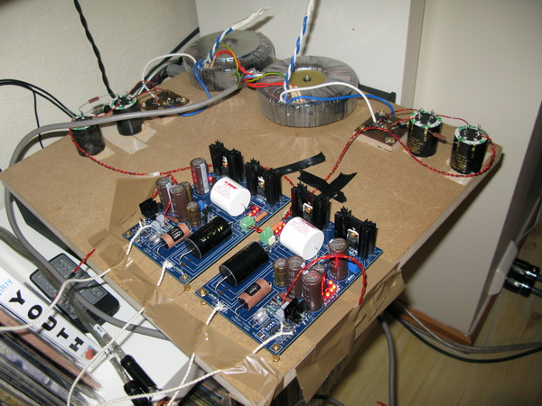

I did a quick measure tonight. I'll do something more thorough tomorrow.
Shortly after power-on, Vrail was about 34V, Vr2 and Vr3 were both about 40mV, and TP1-TP2 was about 2.5V. Like I said, I'll get more accurate measurements, and more precise time measurements, tomorrow. I was surprised to see TP1-TP2 that high that quickly (esp since this morning that was much lower on the same board in the same time frame), so I want to re-measure tomorrow. However, ~40mV implies about 8mA current. Does that seem unusual given 11.55mA Idss?
We shoot for ~9mA final after the degeneration resistors (R2, R3) and warm up have done their business.
Looks like I'm in the right ball park then. Odd that TP1-TP2 was as high as it was, when this morning it was quite a bit lower. But we turn the heat down at night, and the house was warm when I got home tonight. I'm starting to think that I am chasing chimeras. I'll measure more tomorrow, then put the new transformer in, and mount the MC cartridge!

I had problems finding high enough leds for the quads only about 7,45v
When i fired up at rail voltage @ 34v the TP1 -TP2 was -0,5V
Had to lower the rail voltage quite a bit now at apox 31,5v
I am running 10,5ma 369 and 3.3ohm R 2&3
The R2&3 voltage is about 27-27,7mv = 8,18- 8,42ma
The R13 voltage is about 21,5 -22V
Have tried to adjust the Vr1 to get more current through R2&3, have the Vr1 all the way anti clockwise getting the last mv out of R2&3
The R2&3 total (apox 54mv) is a little higher in R/H channel than L/H
Will do fine tuning when cover is one and temp has settled.
So to my Q:
Should i use Vr1 to adjust the current through the 369 and getting them equal i both channels (i know that the 369 was a tad stronger in one channel than the other)?
Is the 31.5v rail to low and should i try to get the 4 leds closer to the recommended 7,75v?
Comments?

31.5V is not too low given your other measured figures. Use VR1 to balance, of course. Your 369s were measured in a hotter room temp when characterized no doubt, your results compute. Don't change the LEDs. You will see closer to 9mA when hot. Let it come up in a box first.

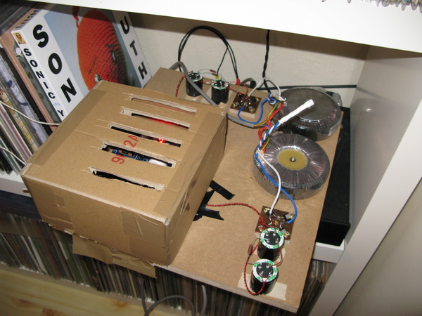

The setup is on a prototype scale, will move the raw PS out in a designated box later when design is settled.
The 50hz hum is only noticeable at full volume and it is no other hiss what so ever🙂
Runs with twisted silver in cotton from the bord and no earth, still quiet...
Thank you Salas and Tea-Bag time to move some vinyl
Observe the Hi-End lid, cardboard is known for its hi resolution and smooth sound😉

Very natural looking build pellesmil.
Mine is running a bit hot - 15,5C above ambient. It is in a bookshelf hidden by my CD's.
Just a few cm's of space above it. I will probably get rid of the top of the chassis and install a net (or is it called a mesh?).

Cool i have the same issue with my setup,
The TT (Well TT) is sitting on the side wall apox just to the left of my listening pos,
For the moment i use about 1 meter cable from the TT to the Riaa, and from there a 70 cm cable to the preamp (both components in the bookshelf on the same wall as the TT.
About 2,5m cables runs from the preamp to the power amp witch is sitting between the speakers.
I would like to put all stereo components together between the speekers and cleaning the bookshelf for both Riaa and preamp.
But i then need to run about 4metes with cable from the TT to the Riaa.
Im gonna do a test later and see if my twisted silwer in cotton cable with behave.
If the 4meer project is Nogo than am back to the drawing board.
Fitting the folded + a 600VA PS behind the records in the bookshelf might bring me into teh same problems as you have with issues getting enough cooling
You might wanna try some brass mesh, gives you good cooling and woks wonders as sheelding
