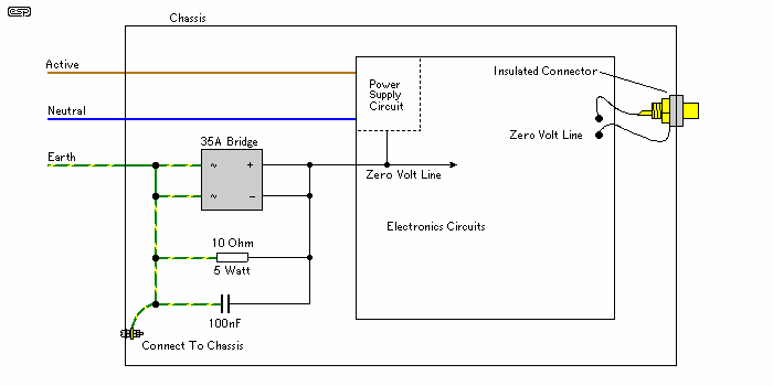

Does it make sense to install 0.1uF and 10R resistor in parallel at the GND lug and to connect FSP GND to it? I saw such concept in Audio Note Phono. They also connected In GND to it.
The raw PSU board has the return point to mains earth for PSU box and its already floating on 10R. Don't make double return. You can bypass the 10R on the raw board with 0.1uF piggyback if it makes any difference to you.

The Audio Ground to Chassis Safety Earth is there to protect users in event of a serious mains fault that makes the isolated side of the equipment Live.
The Safety is achieved by blowing the Mains fuse.
If you insert a resistor into the route that the Fault Current is trying to find the way out, then the fuse may not blow or could take many seconds or minutes to blow.
The Safe route to allow the Fault Current to escape to the Safety Earth MUST allow kilo Amperes to flow ensuring fast rupture of the mains fuse.
DO NOT insert a resistor into the Audio Ground to Safety Earth connection.
If your amplifier (or equipment) needs a Hum reducing "tweak" then consider using a Disconnecting Network.

Very valuable info to follow safety percussion! I definitely would follow safety code and do not what to create any intentional troubles. Safety first!!!!
Than you.
This is Elliott Sound approach...
Same as we are doing beside 0.1uF cap.
