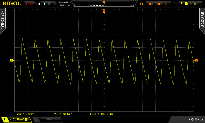

After bridge and 4m7 cap (no resistor no choke anywhere) there will be 180mV pk-pk ripple. Captured in the attachment.
That ripple feeds to the reg. After the reg, its a line. That capture was in hi-res mode in a deep memory scope. Which is a kind of boxcar averaging method to lower the noise floor.
In normal acquisition ghosts will appear riding the waves, same exact ghosts appear even when the power is off.😀 The scope's LCD refresh rate is under suspicion.
Obviously very low source impedance to very high load impedance couplings when measuring from mOhm PSU to MegOhm scope and probe. What is real and what is ghost its not easy to tell in non optimized differential measurements for CMRR. Its surely common mode ghosting because its there either with the power on or off. So filtering can't be that bad for ease of mind against any gremlins, or to just let the reg work easier. Only if it does not end up sounding weird of course.😉

Its either due to ground or due to raw line imposing little something then. I don't think that we can ever have absolutely nothing than white noise background in non floating non balanced early from cartridge interface through balanced primary transformer for SE circuits, but you may try alternatives both for your grounding and your PSU filtering. Will do no bad.
