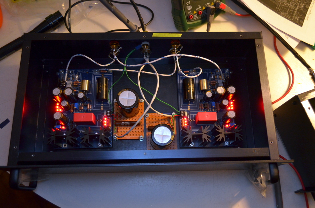

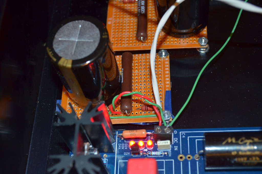

There is always a possibility, but in this case that was not the issue. I found the problem tonight. I have an RC filter on the incoming DC in the preamp chassis, on a pair of small perfboards. I had the incoming wires mounted very close to one corner of the perfboard, and a slightly oversized spacer under the board at each corner. The spacer was shorting V+ to the chassis! I removed the spacers and bodged something together with nuts and washers, and added some tape for good measure.

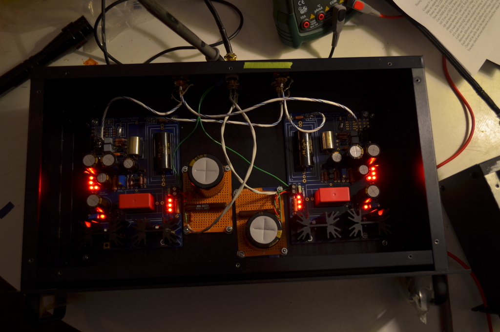

Powered up again, this time with the bulb tester, and everything looked good. Powered up each board, no smoke, raw DC was good, all LED's lit.
IT'S ALIVE!
A little better photo:

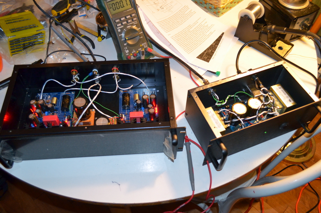

Here are the two chassis:

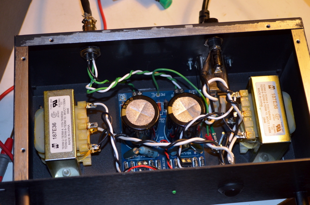

The PSU seems none the worse for wear after last night. Probably the dropping resistors limited the current somewhat.
Here's the interior of the PSU:
Here is the extra dropping R and filter cap in the folded chassis:
Voltages all look good so far, I will trim TP1/TP2 shortly.
