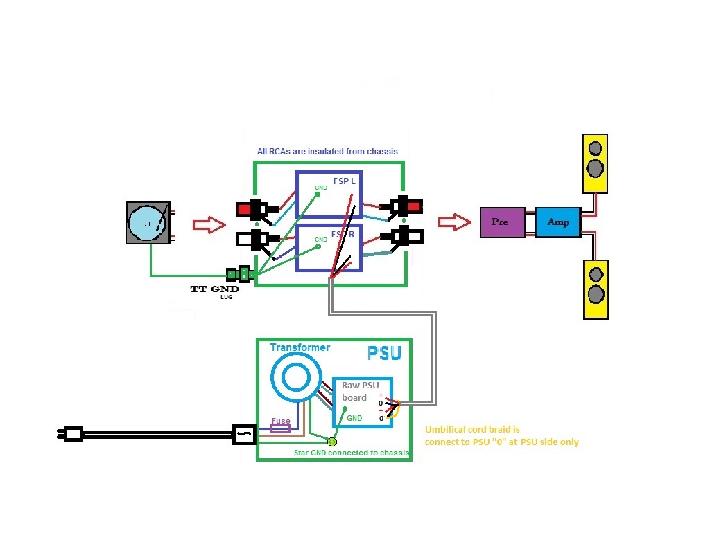

Ok, there we have it - thanks for the explanation salas - I didn't think about looking for the answer on the pcb...
So the main chassis is at signal ground. Any sonical effects if you touch it?
Regards
It would have hum, EMI, RFI, effects if it was not grounded at signal level ground potential. As it is, when boxed, I had difficulty making it sing along most mobile phones transmitting. Only a little if ever.

I will reply to myself and elaborate more on the issue. PE the main chassis though the umbilical which you in the raw psu have connected to the chassis and PE. In the main chassis use an isolated ground terminal connected to the pcb's GND which provides signal ground for the TT.
This would give both safety and function🙂

You got a box that contains mains and one that does not. Contains sensitive amplification. Its better to associate one directly with the mains ground and the other with the signal ground. They ultimately refer to each other through the disconnection network.
P.S.
If you want to do it differently its up to you. That is only how the prototype worked and is described.

Friends,
Can we create drawing of correct GND consent. I'm going to attached draft and please edit it till we all agree about the way and safety.

Hi Alex.
As is the umbilicals shield is connected to 0 (signal gnd) and not protective earth.
That is the yellow line in the drawing. So the main box should be yellow.
If PE'ing 🙂 the main chassis spoils SQ then I rather keep it as is. Better would then be to have double chassis with PE on the outer chassis or external isolation.

Hi Turbon,
Salas wrote us that umbilical cord shield should be connected at PSU side only to the GND. Do you meant that we need to connect it to FSP TT lug which is a part of FSP chassis and not at PSU side?
Hi Alex.
No, the umbilicals shield is connected to 0 (signal gnd) on the raw PSU side only - not to the FSP. The FSP takes the 0 (signal gnd) from the GND on the pcb's and connects it to the FSP chassis/TT ground lug.
Again: "If PE'ing
the main chassis spoils SQ then I rather keep it as is. Better would then be to have double chassis with PE on the outer chassis or external isolation."
But thats me 🙂 and I would be happy if there is an easy way to PE the FSP without me needing to rebuild it. For now I enjoy it as is per salas design 🙂

Got it. I attached corrected drawing.
Yes Alex. That is as I understand it described in the build PDF and clarifications from salas earlier in the thread.

Just to be clear, the GND in the PSU is not the same as GND in the FSP...
Regards
If 0V of Raw PSU is connected to FSP, then FSP as Raw PSU are separated from Earth Ground by 1R and 10R ll with 2 diodes.

The Builder MUST decide if they require the Fault Current Route to extend all the way through the system.
Once that decision is made, you either
a.) connect the various chassis together any which way that achieves the "no Hum" condition.
or
b.) Ensure that every connection in the Fault Current Route can survive the kilo Amperes that can flow until after the Mains Fuse has ruptured and the arc extinguished.
The recent discussion seems to be going along the a.) option.
But that is up to each individual Builder and his Family and his/her Visitors and the household insurance company.
