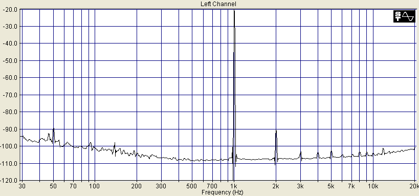

Its not huge, its relatively big ratio to the low signal you passed. Still 55dB lower than your signal. So the software must be calculating something non correlated. Is it looped or using external hardware gen? Calibrate ARTA and card for 1V=0db. Then use 5mV 1kHz for feeding the phono. Yours is the lowest gain MM only version, right? Make 1:100 LPAD RCA and assign 0.5V out to the software sig gen. It will not be good in giving good signal at mV range directly. Feed it after the LPAD. Loop it. When you will put the transformer inside the box and ground the chassis to the mains, you will see more hurdles to solve. In my experience, about 20cm can be adequate for a 50VA non shielded toroid or Rcore if in same box. Best is that a phono box is having external PSU and trafo box, only DC entering the main unit, and any AC mains cables kept well away from TT signal cable. Common practice in expensive equipment. See something interesting also. This is with a lesser than EMU card 16bit octave scaled FFT from a friend's realization using PCB with a grounding scheme that was nice but not best. I powered it with a battery so to see what it was doing excluding his PSU or trafo field. Guess what, his GND loop with the card (laptop on battery too) was picky enough so to have -90dB 50Hz hum with no equipment around... Some alias filter spikes in the HF, but the 16kHz TV scan bug is absent because of the no mains related battery PSU.

The signal generator used was the one in A.R.T.A., so, it was looped through the phono. You too noticed the difference, with the laptop plugged in, or on battery. The laptop switched power supply will push all sorts of high freq noise into the measurements. For all my experiments I unplugged the laptop from the psu, ran it on its battery.
Yes, I am running the MM cascoded and buffered version, from page 8.

An LPAD attenuator is a series resistor feeding a parallel resistor. The signal at their node is X times lower given their ratio. See.

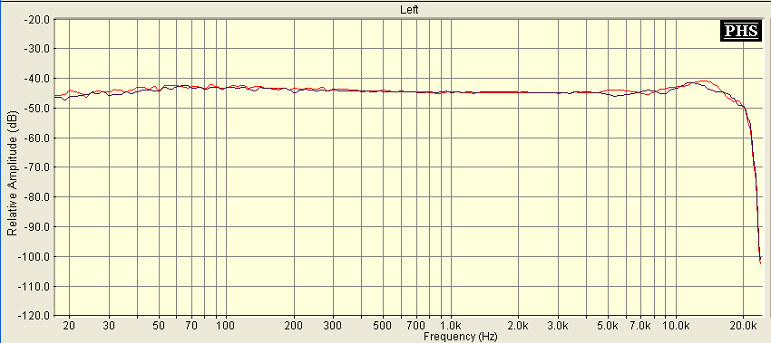

Here is what the DENON DL-160 does on the Walker TT and Mission arm through our phono. Red is right channel, black is left. Resolution 1/12 Octave. Pink noise is from Telarc Omnidisc side 2 track 13. The levels are not artificially matched, what you see is the real channel matching of the whole system.

salas said:Here is what the DENON DL-160 does on the Walker TT and Mission arm through our phono. Red is right channel, black is left. Resolution 1/12 Octave. Pink noise is from Telarc Omnidisc side 2 track 13. The levels are not artificially matched, what you see is the real channel matching of the whole system.
Wow! Nice.
