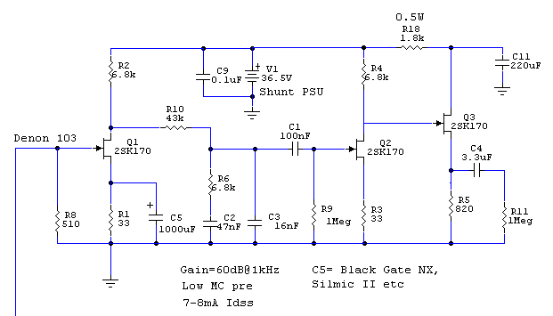

That will do. The 510R input loading I recommend you to try. Off course you can tune that on preference.

Hey thank you so much Salas - super fast respense and very helpful indeed :)
I will build that version using some tagboard I have and hope that works OK. Now I need to read about matching my JFETS and I can begin :smash:

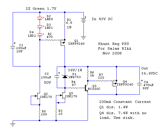

Unfortunately I haven't got this underside photoed, but if you look on early pages you can see some pictures of the technique when the Riaa was in testing phase with batteries. In general, a U shaped thick copper peripheral buss bar is used, and the input grounds are soldered at its respective open ends. The output RCA grounds are tied together and with one thick wire they go at U bottom. The output coaxial cables are shield one end soldered only on the common output RCAs GND. The whole thing progresses symmetrically from open ends to end of U, stage by stage, grounding to the buss. Valve construction technique in short. Silver content solder is used. I always listen to better analysis, fluidity, calmness and stage VS any PCB, if the p2p is careful. Less soldering points, no thin traces, direct paths, can't lose. Not for the fainthearted though, and it takes practice. I thank my valve background for that. Big plus is rapid prototyping also, last but not least. The recommended 36.5V shunt has been pointed out and posted many times, but since you seem a bit lost as a late comer, here it is 4U again.:cool:

Thanks for that Salas - I did search back through the forums, but backwards.... of course I was on the page BEFORE the schematic when you replied haha! That looks great, and I seem to have many of the parts already - the audio Gods must be on my side today :)
I'll get some perf board and start building next weekend fingers crossed.

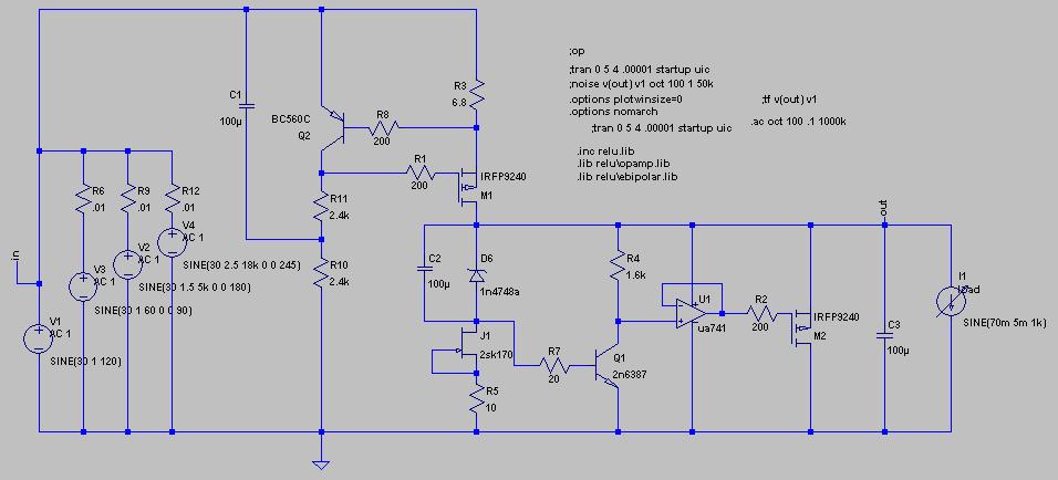

For what it's worth, attached is the regulator schematic that has shown both in simulation, and in practice, the best regulation. I have tried all of the different variations in this thread, and have tried the sulzer, and jung regulator as well.

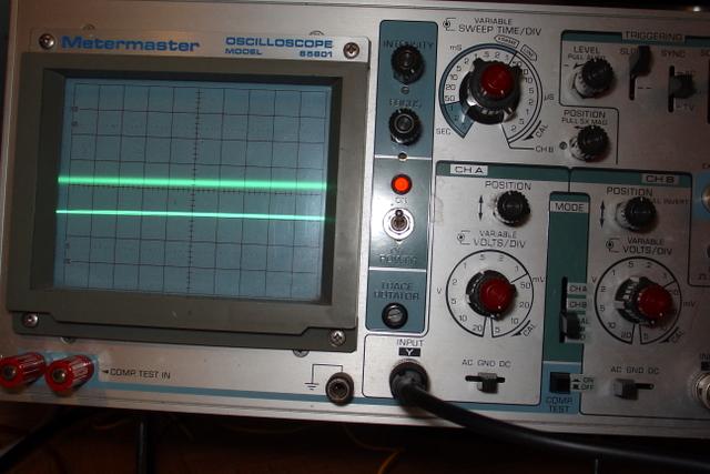

This attached schematic I have built a few hours ago, and the oscilloscope trace on the most sensitive setting, 5mV/div, showed a straight line, just a tiny bit thicker than when the scope is set on GND. This is as close I've got to DC, ever. It seems stable. There are more details about the things I've experimented with, such as different opamps, different driver instead of the darlington, but this configuration showed here was best. As far as the sound goes... that I don't know. Somebody else with more experienced ears should test it.

Looks OK. But under some threshold, the scope will just show nice lines and it is difficult to evaluate small gains.

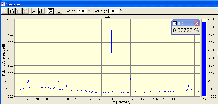

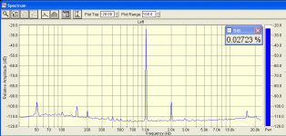

You will need FFT. Here is the FFT of the pictured phono, fed with DL160 nominal 1.6mV 1kHz. The 50Hz peak is the total hum. Good for such a small box with an non shielded transformer inside, and just p2p. That -107dB 100Hz edge might be the ripple residual or just random noise floor grass. Also that 16kHz -105dB peak might be interference from some TV scan frequency.
