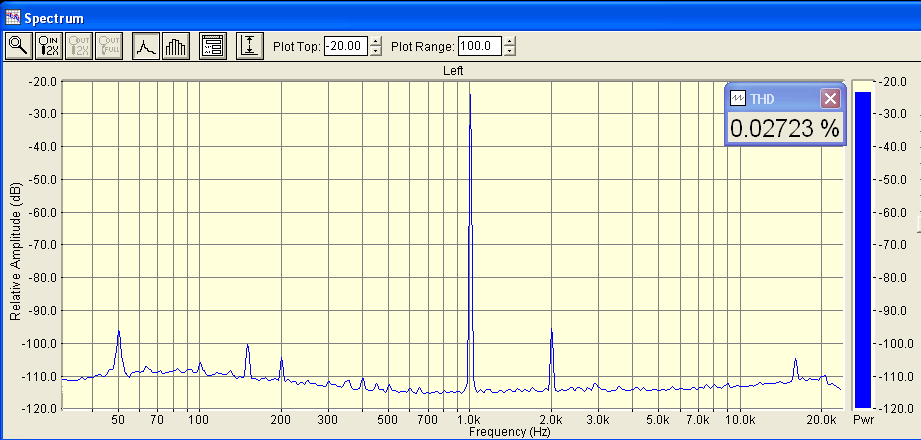

Looks OK. But under some threshold, the scope will just show nice lines and it is difficult to evaluate small gains.
You will need FFT. Here is the FFT of the pictured phono, fed with DL160 nominal 1.6mV 1kHz. The 50Hz peak is the total hum. Good for such a small box with an non shielded transformer inside, and just p2p. That -107dB 100Hz edge might be the ripple residual or just random noise floor grass. Also that 16kHz -105dB peak might be interference from some TV scan frequency.

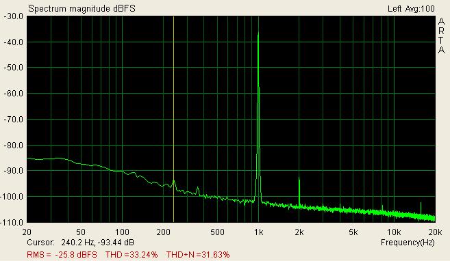

I measured both AC coupled at the output of the regulator, and then passed a 1Khz sine through the phono, and measured at the output of the phono.
The output of the regulator was what I was talking about earlier. The sine passed through the phono shows quite a bit of 60Hz and harmonics, but I don't understand where they're coming from, since the regulator has no trace of such things whatsoever. Could it be ground problems on the phono pcb?
This is what I mean; you can see 120Hz, 240Hz, etc.

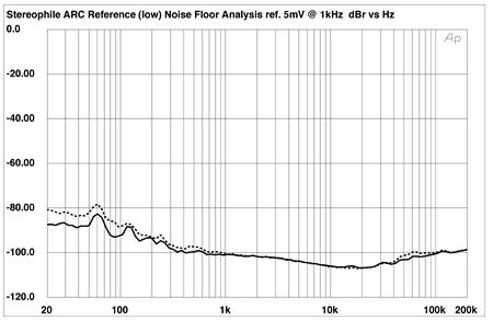

When you measure the phono as a whole there is lots of gain that follows the RIAA shape. See page 38 also. If you have 40dB at 1 kHz for example, you have 60dB gain at 50Hz. So the loop resistance of your GND scheme, the proximity to transformer field, AC cable or other equipment, will induce the mains fundamental, aided much to do so. Even when with battery PSU it will pick up some by surroundings or by not perfect GND by creating little loop with connected system. What you saw in the way I measured it, isn't exponential frequency scaling, but octave scaling, trying to be closer to reality for hiss because its a phono and is going to be fed inverse RIAA. Also the trafo is in the little box. The fundamental sums and diffs with its harmonics. So you got 120+240=360Hz there too for instance. Also some TV is feeding 16kHz scan in your mains too. Still not in a box with PSU and trafo I guess. How far was your trafo and PSU when you measured? My perspective was to keep all that stuff under 60-70dB that would be the max dynamic range of best TT and cart when actually spinning records. More hum will be added by cart ground path and arm cable picking easily when such a low signal travels so long. So my goal was to have JFETS and MOSFETS mainly because they give a nice subjective tone, in the simplest effective form for adequate results. Best lab results for this or that frequency etc make things necessarily more complex, adding high loop feedback op amps etc, for typical gains that will be dwarfed by the reality of a rock dragging on vinyl, sending a tiny signal far away in a non isolated environment. And all hose things hurt the main goal that must be good sound by catering for tech perfection that will be playing second fiddle IMO. I just went over to stereophile phono review measurements to see some and I saw that they avoid the region under 1kHz in most measurements by using linear scaling. I could see only one older full spectrum (yr2000 Audio Research Reference Phono), taken at lowest set gain in exponential scale (noise goes down as frequency goes up following RIAA shape if not inverse fed). Just the noise floor with no signal and the inputs shorted. As you see we must be doing OK with our stuff, don't we?

Yes, very nice indeed. And you're right, it's so easy to pick up spurious signals.
My new puzzle is the huge THD I got when passing the 1Khz sine through the phono, as you can see in my previous picture.
Edit: the trafo was about 40cm away from the phono.
