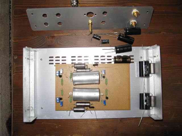

RCruz said:Hi Salas
I can not find a C11 in my schematic... Maybe it is C10 ?
Can the same be done with C5 (Use 470u BG´s what voltage minimum?)
I am using 220 ZA but find the sound too forward.
Ricardo
For C5 and C10 in your schematic you can freely try 220uF and over in any quality you wish to audition. C5=35V min, C10=25V min.
RCruz said:After burning for 24 hours, the bypass has "healed".. sound is now powerfull and very detailed... Outstanding.![]()
And I did not replace the resistors yet ....
The Benz is singing as never before !!!
Ricardo
PS (I did not decide between mundorf mcap supreme / obbligato "dry" / ClarityCap SA + 0.47 Mundorf Supreme bypass)
I want depth and wideness in the soundstage with loads of detail.... Please advise
Ricardo
So far so good. Bravo.
I would replace the resistors first. See where I arrived and then make final focus with the output cap. Obbligato aluminum-foil MKP 630VDC is best value, and then can be tuned with some bypass.

Thank you nicoch46 !!!
Of course I would not think of 50€ caps before tunning the rest of the system.
I already built two pedja buffers to bypass the preamp but I am not sure it is the best choice due to the lack of gain and the additional caps. (My pre does not use caps in the signal line)
The Mundorfs Supreme cost 20GBP and the obbligato 15€ ... I will follow Salas indications and use the china caps.
About a decent pot, I believe you indicated something from Australia before... can you point me in the right track ?
Regards
Ricardo
