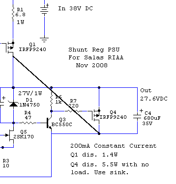

Hi Salas
Maybe it survived because R1 took it like a man (Touching the sinks, the shortest way between GND and +Vin looks like R1)
By the way, R1 is 14r so I believe I = 164mA. (Might reach 204mA without output load)
I am glad because these where the values I calculated before implementation 😉

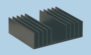

Now I need a bigger heatsink. Can place a picture so I can get it right this time ?
Ricardo
1c/w here. You must isolate the mosfets with pads, if on same sink.

RCruz said:
Hi Salas
Ricardo
It shorted from 28V to ground. Not from Vin to ground. Because each drain is electrically connected with each sink as you made it for now, without mica pads. I attach how it sparked.😉
The current will not change, its constant. The shunt's Q4 heat is lighter with the load on, because they share. Q1's heat never changes if talking shame R1, shame Vin-Vout.

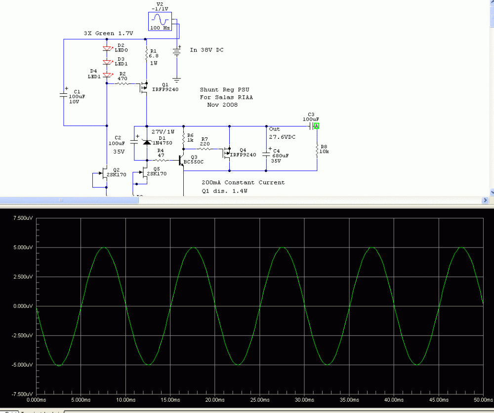

ikoflexer said:
Would any of you know how to get the psrr rejection and output impedance of the regulator in spice?
It is here in our thread, about output impedance.
Link
For simulating the ripple rejection of the reg, I ride an 100hz ac source on the DC in, I see reg's output peak to peak residual, I am dividing the ac source's peak to peak by that and I convert to dB.
With the phono I inject some ac again over dc at B+ point, and I see the residual on the output, dividing etc.
With a 2V pp ripple in, my sim gives 10uV pp ripple out for the shunt for instance.

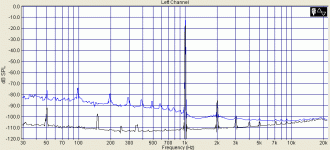

It goes very low on noise and THD so I will retest some stuff. That picture above comes from someone else. So I don't have more. Its a loop test showing what it can do. I don't know if drivers etc will permit so nice for me too. I will have to find some time soon to get familiar. I have posted before FFT for phono + shunt VS some expensive commercial machine. Black line is the phono + shunt. No 100Hz ripple spike at all. Hum under -90dB (0dB=1V).Off course 50Hz hum is particular to that build only. OK the old card goes only -100dB for noise floor in the highs, but it has more than adequate noise floor in the lows for seeing hum and buzz frequencies. Its 35dB better than the commercial machine (blue line) at 100Hz, and 15dB better for hum. There is a toroid in close vicinity in a small box...it can do better with more gnd care and hum fields care. Like with an external PSU box for instance, lower cable screen resistance and more gnd loop scrutiny.
