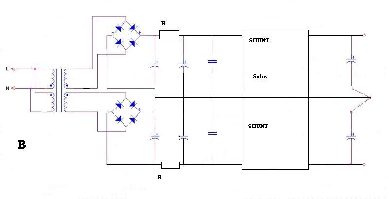

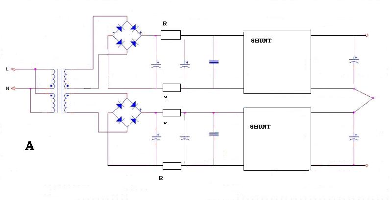

Nico,nicoch46 said:I don't use main earth
B only suits a single rectifier and the Shunts must be a +ve & -ve pair.
A is OK with dual rectifiers and OK with a pair of +ve shunts or mixed +ve & -ve shunts or a pair of -ve shunts.
The resistors marked ? should be 0r0.
There was a thread suggesting that Inductors in the returns would work better, but I cannot recall the conclusion.
