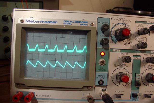

salas said:
Is it something that came up after the initial tests? A buzzz indicates 100Hz. See the psu output on the scope. If it still works OK with a clean output, its a ground loop, or a transformer field. Batteries are essentially floating devices.
It was probably there, but I usually don't pay attention to such things in the beginning. The scope shows a spike about 10mV/div high on the PSU output, but I didn't check the frequency. The transformer was quite far from the regulator and preamp, far enough for it's field not to affect anything, I think. I suspect the psu as the main culprit, or a ground loop/problem.
This PSU does not pass 100Hz ripple for sure by design. Many have been built and work for months now. There must be some error somewhere if it does so.

This picture explains a lot. The upper trace is what comes out of the regulator, the lower trace is taken right after the diode bridge. The two traces are scaled differently, but the main idea is that their frequency coincides. The regulator output was not connected to anything. It looks like my implementation of the regulator somehow does not flatten the ripple. I just noticed that my bjt is a BC550B, not a BC550C. Would the different hfe (330 vs 600) make such a difference? I'll look around here see if I got something like a BC550C.
The regulator must be connected to a dummy load for testing. 40mA idle is what your phono circuit needs for 2 channels. Connect a 600R 5W on output.
