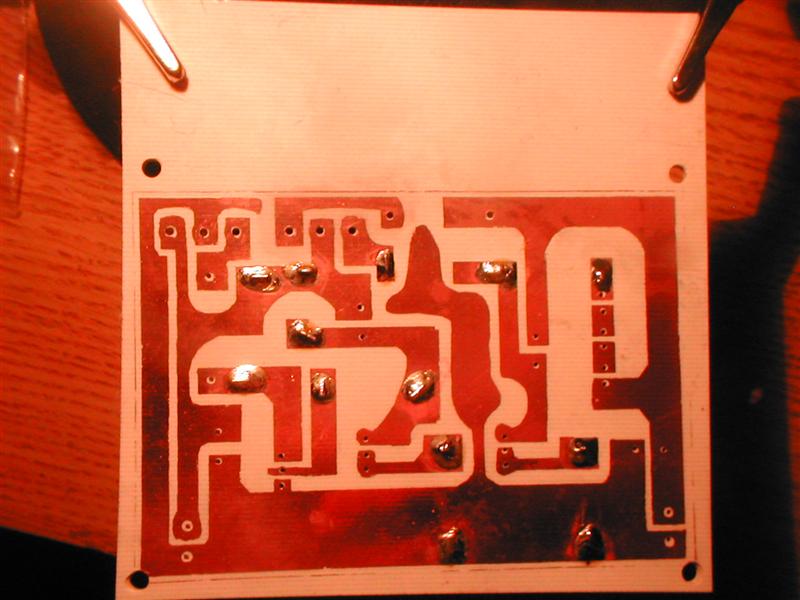

Yesterday I etched the schunt board. Very messy procedure, my lungs "and my wives" where affected and I do not know how to dispose the used etchant !!!ikoflexer said:
Nice board Ricardo! Well done. Once you find the proper paper for the transfer, you will not see many flaws at all. It is also important to press decidedly with the iron edge (or tip) in one place repeatedly, Also, when printing it, the printer has to be set to the darkest setting (done in properties in software, advanced option). They also sell special transfer paper in electronics parts stores, but it's a bit pricey.
When I have to retouch, I use black nail polish (donated somewhat reluctantly by my wife 😀 ).

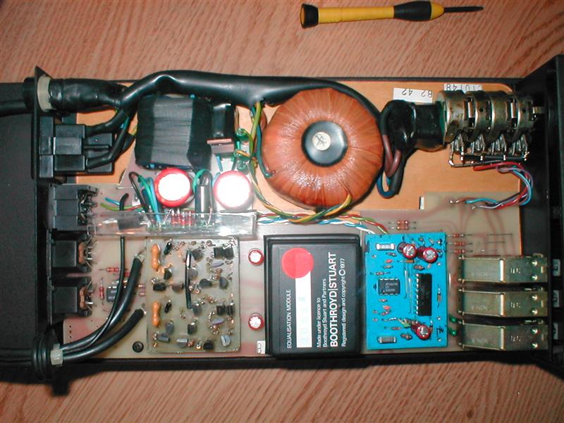

I modded the Meridian PSU (with stupefyingly good results) and replaced the coupling cap between the Head amp and the Riaa.
There is no metal shield on the Riaa (only a plastic cover that I removed). (As a matter of fact, the +-15v rayregs I built are quite close to the head amp).
Layout is like: MM head Amp -> 100uF BG Nx 6.3v -> Riaa -> 10k linear pot -> output metal can opamp -> no output caps to the 103 pwer amp. 😉
Sounds fabulous but I want to get rid of the opamp.
I believe I will build a preamp using Salas Riaa -> 50k linear pot -> buffer -> output to the 103 power amp.

Note: At lunch time I used Dyrup 8004 celuloid thinner and the ink just dispeared... (also ate the Paterson Photo cuba I was using for the bath "Dustbined").
Tonight I will drill the holes, than clean up with Duraglit.
Latter I will build the schunt (parts = +-15€😀 )

Ricardo, sorry to hear about the lungs. Did you warm up the etchant? Do you use ferric chloride? That's what I used, but I don't warm it up. I just fill in the sink with hot water, to keep the etchant warm, and place a thin wall tray in that warm water. The tray holds the etchant, but it does not smell at all. Then with a brush, I continuously brush the board surface to speed things up a bit. It's slower than if you heat up the etchant, but healthier.
As for disposing the etchant. You can re-use it quite a few times. When it's no longer good, you should search in your local city about disposing of hazardous chemicals.

Hi ikoflexer
There was no smell, I did mix the ferric chloride cristals with warm water to make the etchant but did not heat it afterwards. No smell but a funny feeling in the respiratory system... my wife kept coughing...
Maybe I should have done it in an open space and not inside the house. Nevertheless there was no harm...!

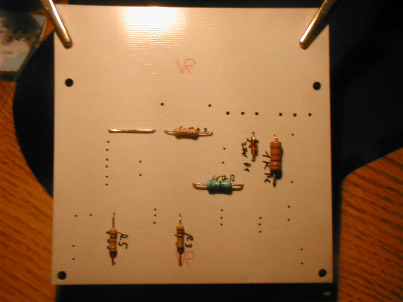

Populating the schunt... that is the question
Hi Salas
I am already populating the shunt pcb.
As I collected all the parts locally, I am having some trouble with the quality of the resistors and leds.
Refering to your last post 728 http://www.diyaudio.com/forums/showthread.php?postid=1722356#post1722356 about the +28V with leds, I would like to know if there is some flexibility about the values:
R1 (6.8R 1W) - I have got 7.4R 1W.. can it be used ?
Leds - Green "normal ogive type" .. Are these determinant in the output voltage ? If so, how can I check the leds dropout voltage ?
C1 C2 (100uF 10v // 35v) can I use other values ? 120u ? are these determinat in the output voltage ? Any of those needs to be low noise / low esr ?

Yes you can use R1=7R4. That resistor and the total LEDS voltage drop determine the ICCS current. There is the VGS tension inherently about 3.4V for IRFP9240 at voltages used here. The 3 LEDS develop Vtotal=3XLEDVdrop. If they are 1.7V each as on schematic, then Vtotal=5.1V. ICCS=(Vtotal-VGS)/R1=250mA if R1=6R8 or 230mA if R1=7R4. Best thing than to worry about what LEDS you are using and to avoid matching them, is to fire the shunt up for a minute, and just measure the Vdrop across them. Then you can determine a suitable R1 by the above formulas I gave. My recommendation would be 200-250mA depending on your sinking. At about 200mA and above its transient behavior is concrete. Your real need for both channels of your phono is for 40mA idle. With 200mA you get a royal current margin for quality dynamics, and 200mA-40mA=160mA at 28V. 4.5W idle dissipation from your shunt Mosfet can be easy to sink IMO. I use a 230mA CCS for 20mA total consumption in mine (no buffers), for months now, 24H/7d on. No problems, and my heat sink is just the thin metal floor of my half width box. I recommended green 1.7V LEDS for typical reasons. I.e. they don't vary much their Vdrop in green color, and the given R1 gives nominal CCS current with them (there is not a 200mA typo on that link, its an ''about'' value given there will be VGS tolerance between IRFP9240s). A schematic has to anchor somewhere, but now you know how to manipulate it. (I have refered some times before in the thread on that).
Yes you can use other bigger values for those local noise filter capacitors. Better be low ESR, but nothing really fancy. No they don't determine any voltages, the Zener and the BJT Vbe does that. Just don't change the uF value of Cout if you can (I have determined its transient termination best value), and use there the best you can. More capacitor Voltage value than 35V in your shunt, no problem.
