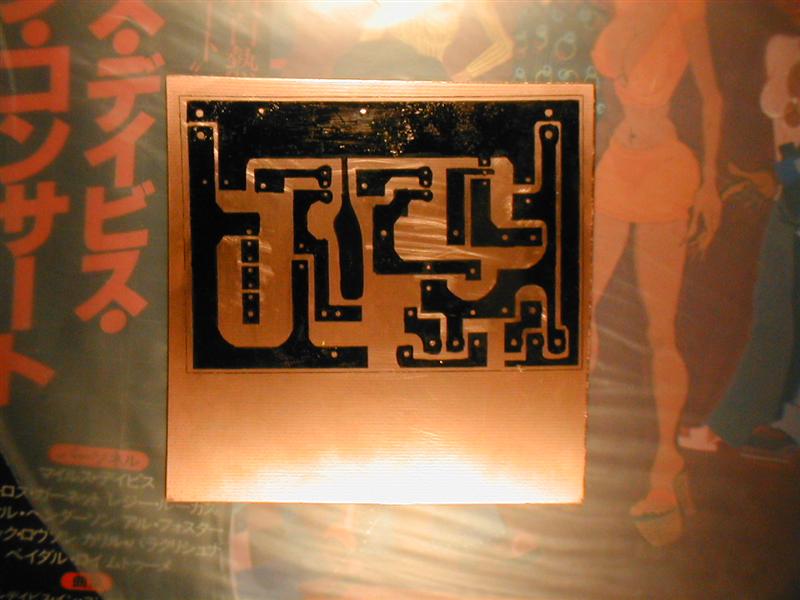

RCruz said:My first atempt on the schunt pcb.
It is the pdf image in negative![]()
Hope the circuit is ok.... I had to hand paint everything over the lazer transfer because it was full of flaws.... I added some gotic artwork !
Ricardo
Excellent work Ricardo.

Nice board Ricardo! Well done. Once you find the proper paper for the transfer, you will not see many flaws at all. It is also important to press decidedly with the iron edge (or tip) in one place repeatedly, Also, when printing it, the printer has to be set to the darkest setting (done in properties in software, advanced option). They also sell special transfer paper in electronics parts stores, but it's a bit pricey.
When I have to retouch, I use black nail polish (donated somewhat reluctantly by my wife 😀 ).
